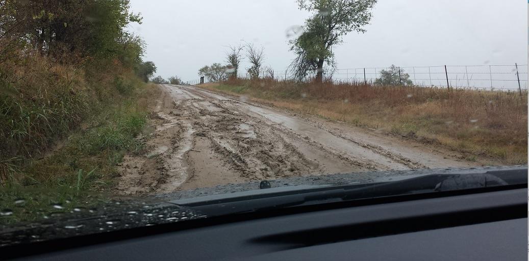

Yeah.. I've already had my 2WD vehicle stuck out there once and shelled out some decent coin to get pulled out (the guys had to use a bobcat it was so sloppy). Even with a county road, it's still a bit remote and a decent wait to get someone out there for a pull. In any event, thanks again for the insight on A/Ts. I'll do some research and see what works best.

Attached a pict to give folks a reference point of the aforementioned slop.
That right there my friend will give any tire on any 4WD fits. I have driven countless miles of roads out to job sites such as the one shown in your pic.
Put it in 4HI
Turn TRAC and VSC off.
Keep your speed but not too much! Key point here!
You will slide. Let off the gas a bit to keep it on the road.
You will spin. Again, back off only a bit.
You need to keep the tires at the point of breaking traction but not quite breaking traction. Over time you will develop that "feel" with your accelerator.
If you do get stuck in that crap:
Don't keep spinning! Use ATRAC in 4HI and "saw" the steering wheel a bit. If you can't go forward, go backward. If all else fails, put it in 4LO, lock the rear and pray.
Those conditions require a skilled driver more than anything else. Sure, MT's would help but having experience driving in those conditions is key also. AT's would do much better than stock but not as good as something like Cooper ST Maxx. I have witnessed experienced guys have to get out and put chains on their trucks to get up slight grades in that mess. I have had to be pulled through sections of that type of road by skidders and dozers.
I hate mud like that.
Agreed. Slicker than owl poop when it's wet, softer than beach sand when it's dry. Oddly enough, once you make it to my gate, any 2WD vehicle can get in, it's just the stupid county road leading up to the property that causes the most grief in rainy conditions.
The county is too poor to do anything about it, but the quotes I've received for graveling are $5/sq foot, 10" deep. My property is in the middle with neighbors on either side a mile in from where the gravel stops. Given most are absentee land owners, no one is interested in going in together on getting the road improved and I'll be damned if I'm going to pay to have my neighbor's access improved on my own.
