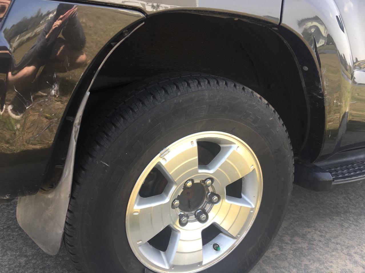

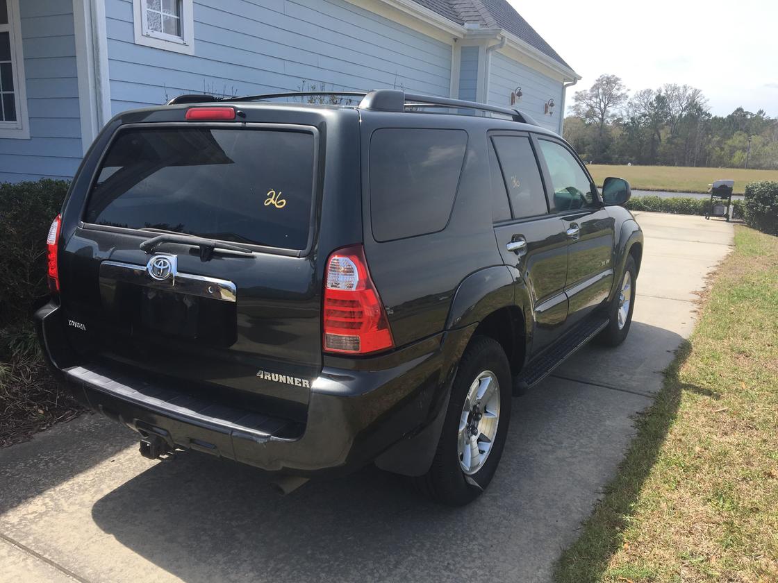

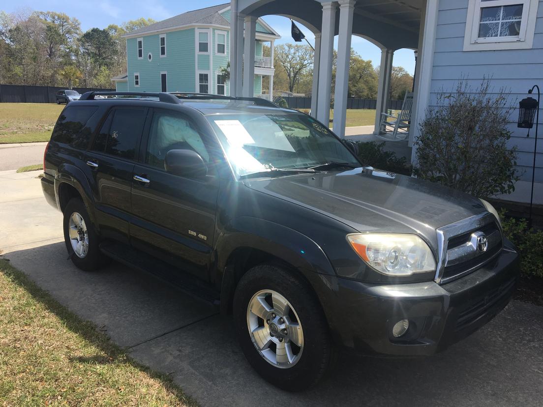

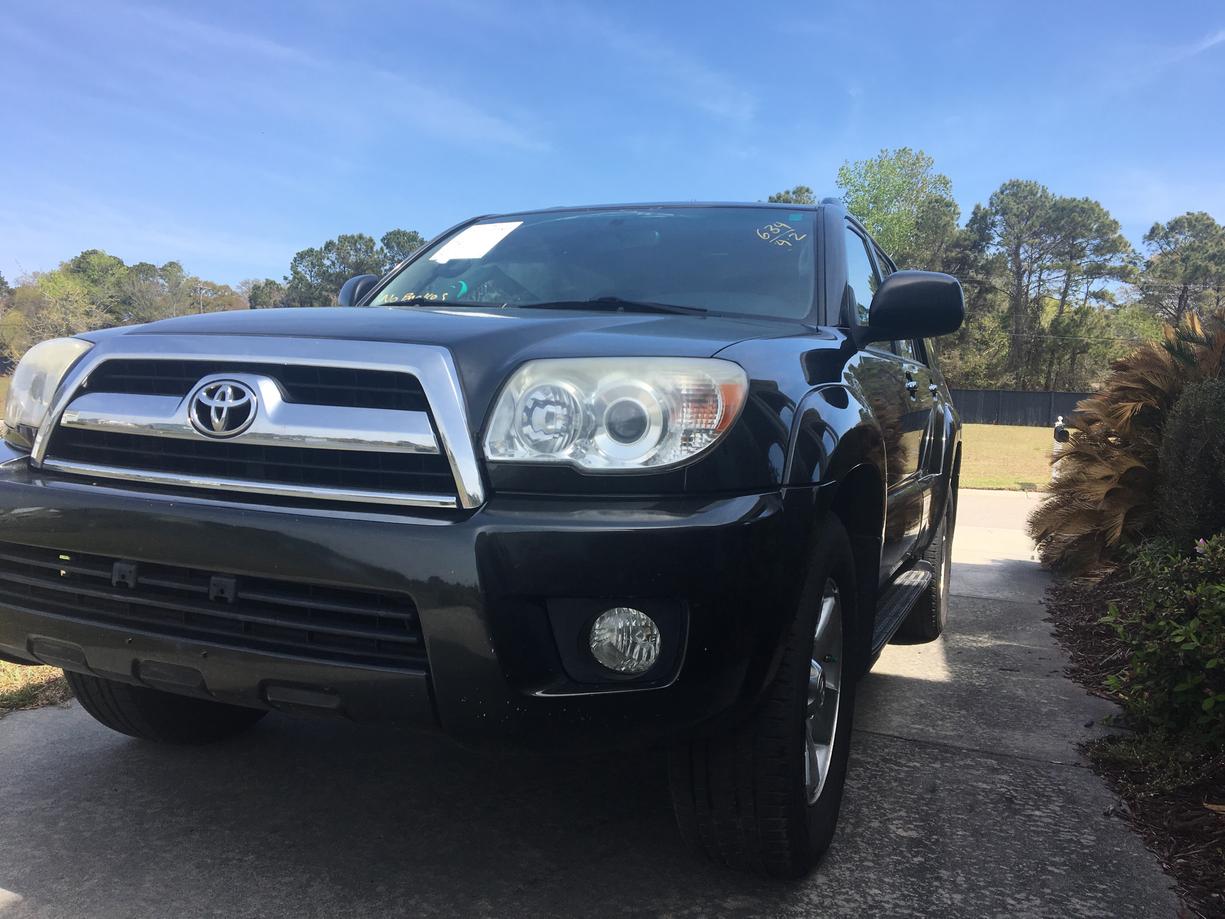

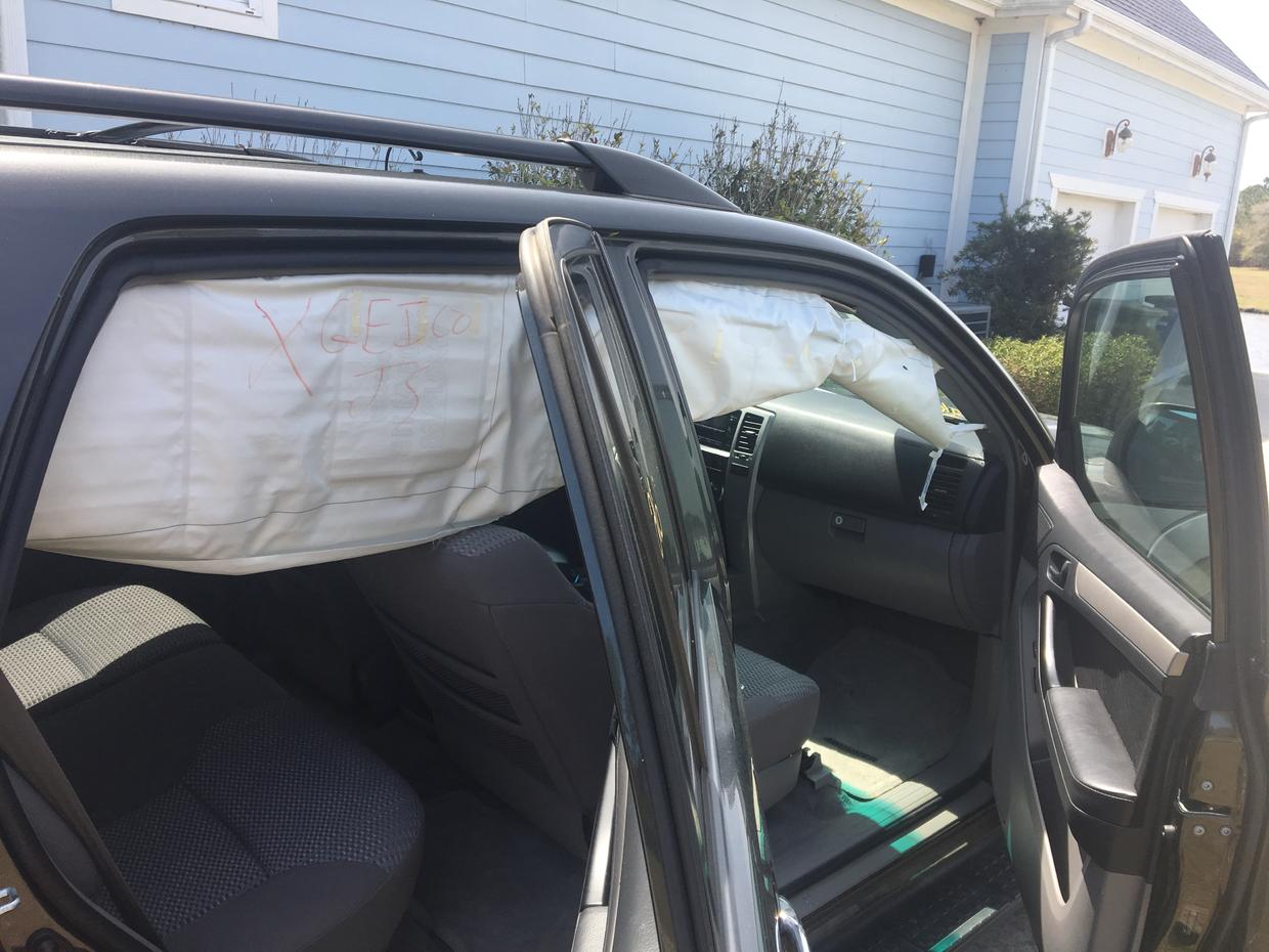

Just reecently bought a 2008 4Runner SR5 4x4 off an insurance auction for pretty cheap with not that much wrong with it. From what we've figured out there is a blown passenger curtain airbag, very minor damage to the passenger side, and a faulty ABS brake booster master cylinder. Hoping to fix it up for cheap and have a nice ride!

The curtain airbag deployed without any windows breaking? Seems kinda crazy. But I guess it's not a ton of side inertia needed to deploy that.
I honestly have no idea how the airbag deployed with such minor damage. I'm not complaining though. Ill post updates as we get it fixed up.
Pretty minimal damage but I know that my '06 had a recall for inadvertent side curtain air bag deployment and the control modules were replaced on both sides.
I wonder if this affected the '08's as well. Check with a dealer to see if there was a bulletin issued.

Actually found it on ebay for 110 bucks. Was a very poplular seller on the website and had free shipping. Got the airbag 3 days after ordering it!
Is the headliner toast?
No actually. Wont even have to replace it. I wouldnt be surprised if it starts sagging in that area sometime down the line but as of now I think it could easily just be tucked back into place once the airbag is replaced.
Airbag can deploy when the sensor senses an angle that may immanent to a rollover. Not sure if most or all these trucks have it or if it was an option, but mine has a RSCA (Rollover Side Curtain Airbag) defeat switch to prevent activation when in offroad situations.
