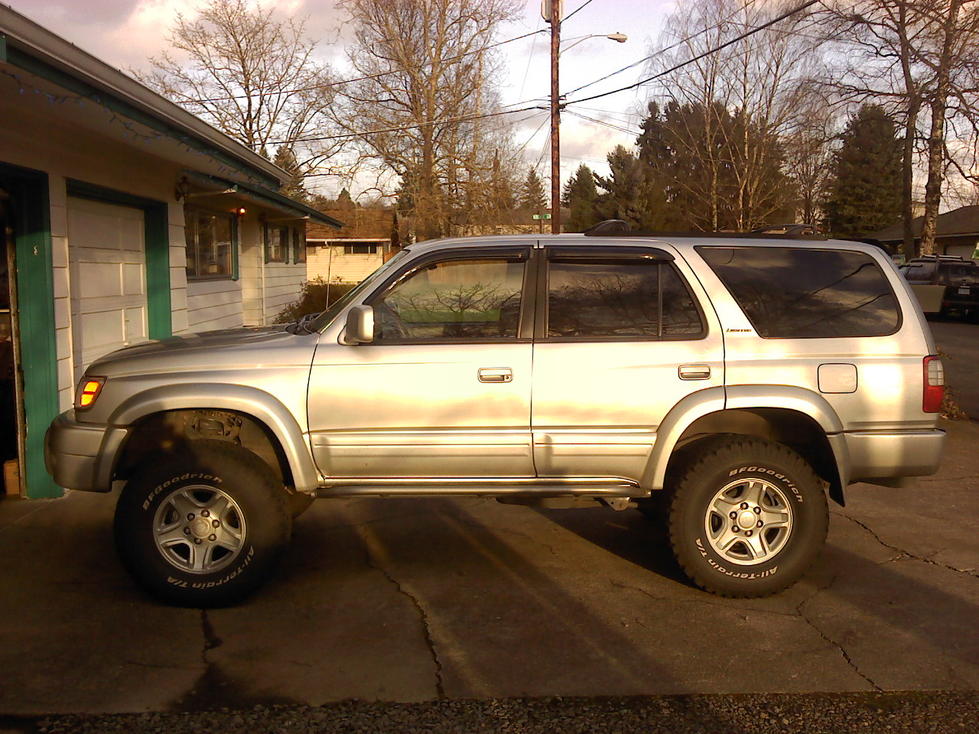

Mine has the RevTek 3" in front and OME 891's in the rear... use to sag in the rear with the RevTek 2" spacers. Sits level now. Here is a pic for easy reference.
Excellent Info. Thanks! That is what I am looking for. How's the ride with the 891's? I don't carry extra weight too often or two much more than a motorcycle trailer so I was planning to get the 890's. Any reason to go with the 891's if I am not carrying the extra weight?
