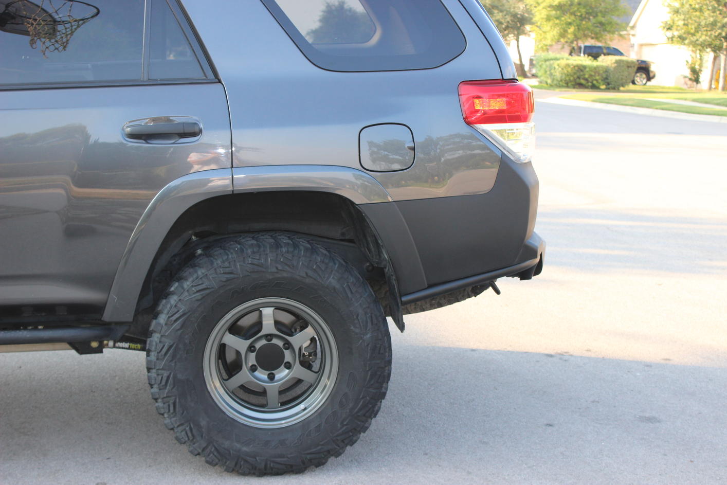

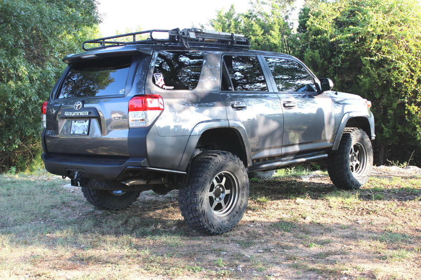

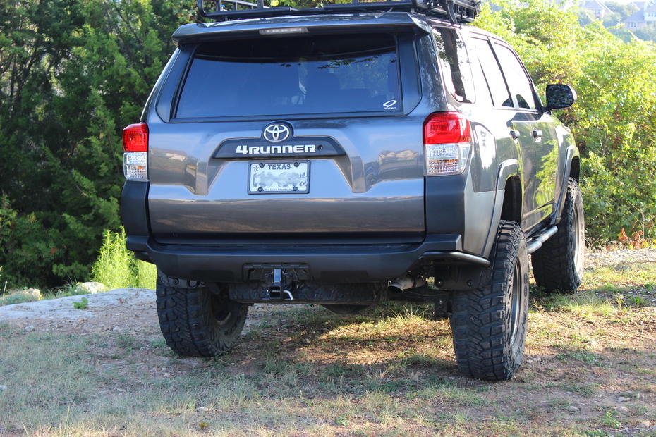

For the rear bumper... there are some serious departure challenges, but I found them to mostly only be in the corners (after much experimentation). And none of the aftermarket bumpers improve the straight on departure much at all besides the 4x4 labs (which requires that you cut out the stock frame cross member/bumper). So I fabricated my own solution by simply trimming the stock bumper cover and welding in tubes to protect the corners. I then tucked and bolted the cover up to the underside of the cross member so it won't ever rip off... And if there is a severe scenario... I also run something called a skidmark (it is basically a skid plate for the rear hitch that works fantastic) Total spend was about $200 to have a guy bend the tubes for me. Weight is maybe 20lbs and has worked great in every situation so far. Don't understand why more people don't do something similar. The pictures are from when I first did it... I now have it covered in bed liner, but it looks about the same. Dropped the corner on a few big rocks and nothing but minor scrapes... Probably one of the best bangs for the buck I have done to the truck. It's not for everyone... but just thought I would throw it out there...
I may still do a swing out some day, but only because I would like to possibly carry a full size 35" tire and run an anti-rock swaybar in the rear and long travel up front. But the weight it would add is what stops me.
