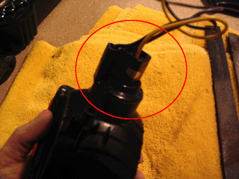

UPDATE! I FOUND THAT THE LENS WILL TAKE WATER. AS A FIX, I PUT THE SMALL BREATHER CAPS BACK ON AND USED DUCT TAPE TO WRAP AROUND THE PLUG AND THEN WRAPPED DUCT TAPE AROUND THE SOCKET AFTER I PUT IT BACK IN THE LENS THE LENS. BASICALLY, I WRAPPED THE WHOLE DAMN THING IN DUCT TAPE
Ya when I did my retro, I didn't seal mine up very well. Found condensation the first sunny day.
Ended up having to take them apart again, and get the water out. Then seal them all back up this time making sure I got it sealed. So far so good!!
see pic...I basically wrapped everything in the red circle with duct tape.
I also added recently some heat shrink tubing over the duct tape...makes it look a bit nicer...and now the duct tape wont unwrap...temp changes here in PA are brutal on tape...
