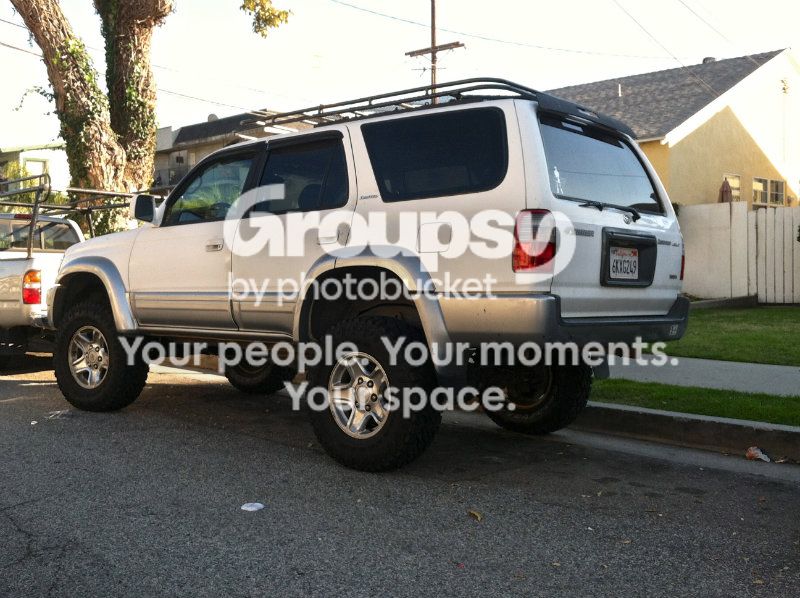

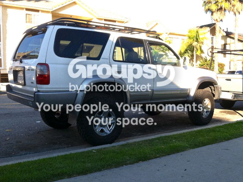

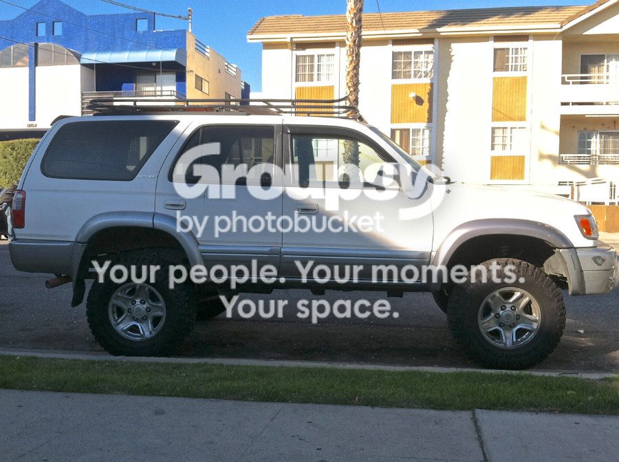

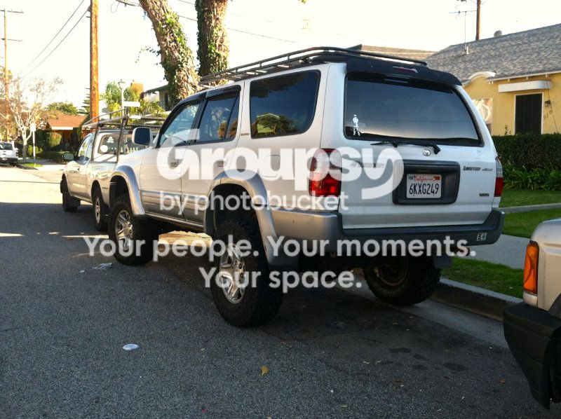

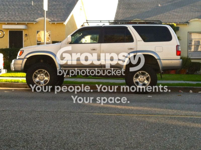

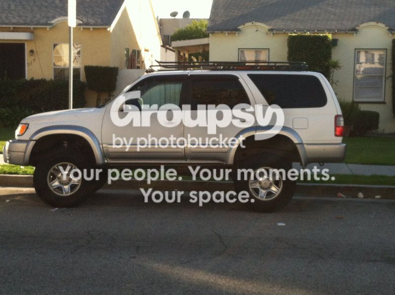

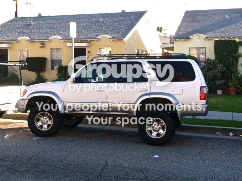

Almost done with the lift. As it sits with no rear weight....
Rears 25.5" Rear should come down a little with spare tire and stuff I carry.
Fronts 24"
Fronts are Toytec Coils with Tundra Bilsteins on (edited 3/8/13, 2nd notch, not 3rd)
Rear LC FJ80 7.5 / 8 wraps (19" / 19.25")
Can't wait to upgrade to 17"!!!!!

When you say Toytec fronts are you referring to the toytec/eibachs? If so the tundra struts on the very bottom notch will give 3 inches, the 3rd notch maybe 4.5 or more. If you're on the 3rd notch you're cv's hate you badly and I bet it rides stiff as all hell. I have the same coils on the first notch with no weight up front and it's stiff but I like it, I can't even imagine 2 more notches. I'd love to see a shot of your cv angles if you're truly on the 3rd notch.
Dina you're right, I don't know why I thought they where on the 3rd notch, I'm blaming the beers and the stress of having to curb it with idiots driving by at 60 mph. It was too stiff with very little shock travel on the 2nd notch, it feels a lot better now on the first notch and sits at 3".
I'm editing and correcting any misleading post I have left. :embarassed:
Toytec's I'm using are the toytec / eibachs up front.
now that your on the first notch what is your hub to fender? and looks killer man. love the roof rack. :)
