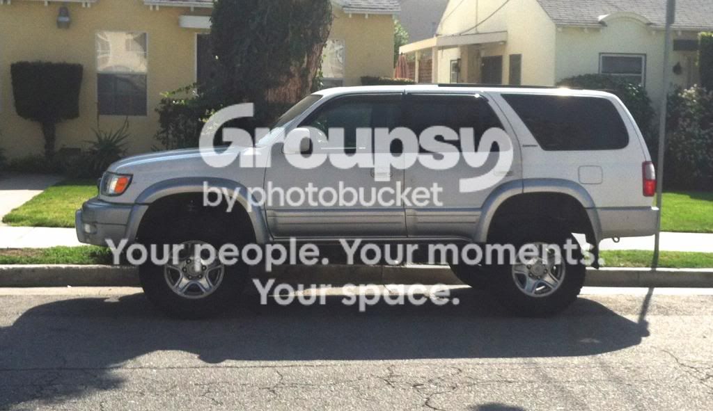

As some of you already know the fronts where way to high for my current setup.
So after some trial and error, more error than trial, 'larry' now sits comfortably
@ 3" up front & 4" in back.
center of hub to wheel arch
Front : 23" Toytec / Eibach coils on Tundra adj. bilstiens
Back : 24.25" Toytec SuperFlex Coils with Rough Country Long Travel shocks
IMG_2242_zps39675ca5.jpg~original

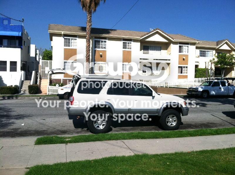

This is for KaliKid and all other members that want to know how LC coils sit with and without weight in the back.
Fronts had already been brought down to the 1st notch.
BEFORE
IMG_2204_zpse7255176.jpg~original
AFTER

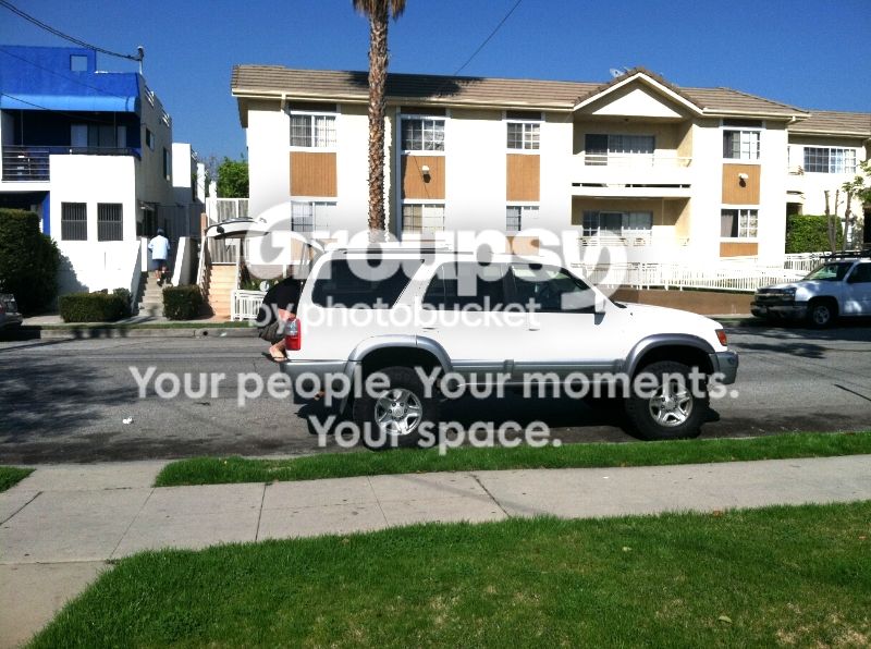

Here's a pic of how it sat with LC 8 wraps and some:moon: weight hanging off the back.
IMG_2205_zps69df3c54.jpg~original
