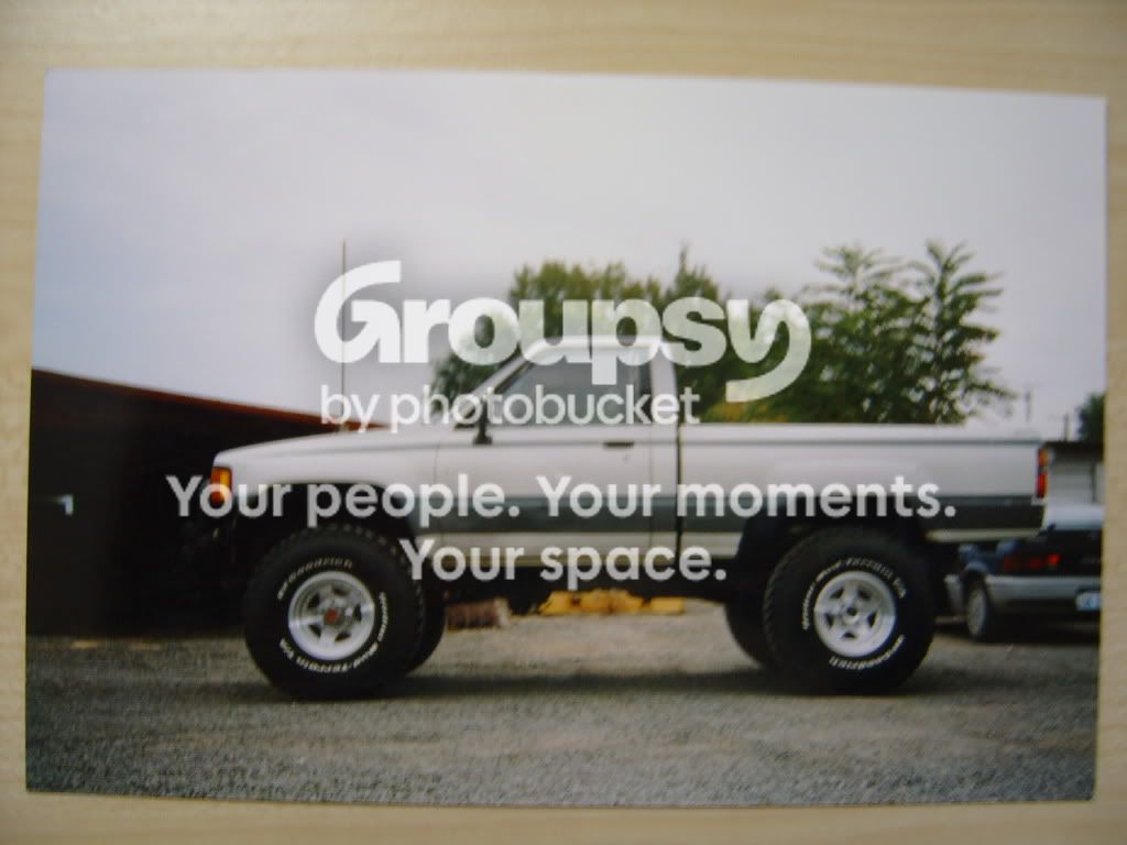

it started all stock, then I added a 3" body lift, both for tire clearance, and because I knew I eventually wanted to swap in a v8.
this is the best "stock" pic I found. this is actually a picture of a picture.
oldpic-1.jpg~original
its not stock, it has a 3" body lift, and a set of 35" bfg's I borrowed from a buddy. with 4.10 gears, it was terrible to drive, I went back to my 33's not long after.
I wheeled it that way for a lot of years, then decided I needed bigger tires. so I ordered up a set up 36x12.50x15 super swamper TSL SX's and a skyjacker 5" lift to fit them.

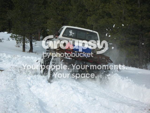

that's the best one I could find, but if im ever home when its light, I could take more. also in that pic you can see my custom cut tires, and my buggy springs. a lot of people rag on them, but they have worked well for me for a lot of years.
as you can see, I also added some expanded metal to the rear to help hold things inside on long climbs.

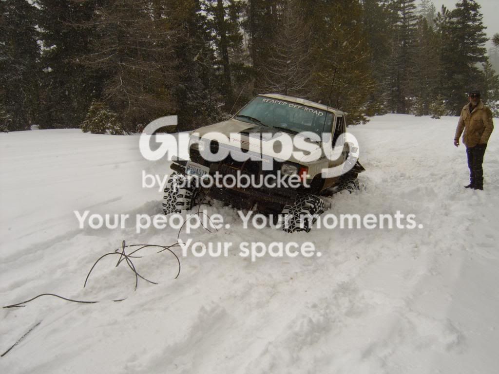

after one too may trips with this happening.
collinsfirstruninjeepjan3rd010.jpg~original
collinsfirstruninjeepjan3rd011.jpg~original
there was ice packed into the back of the valve stem, it was clogged. I used a tiny screw driver to clean it out. I dropped said tiny screw driver into the tire, and I couldn't fit my hand between the tire and wheel to get it out.

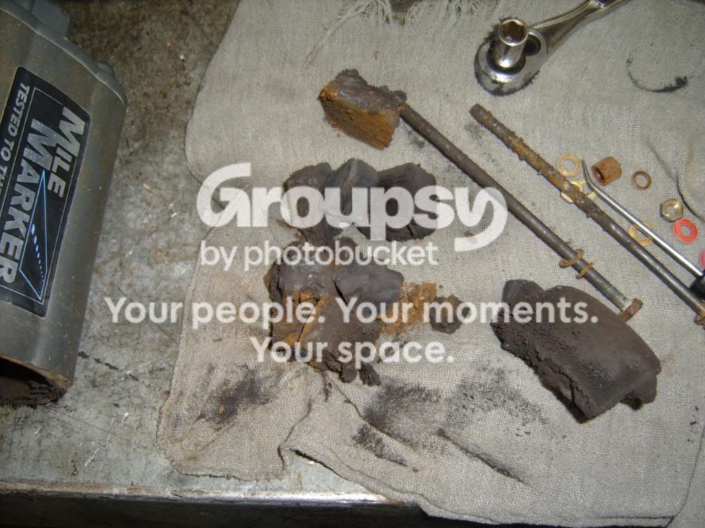

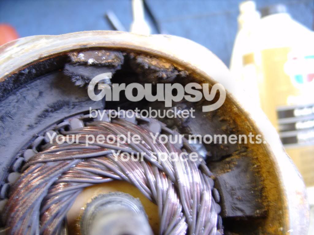

remember the mile marker winch I mentioned earlier?
it finally died, after a few years of hard abuse. I think it was overheated one too many times. one day it stopped working, just clicked. I figured the solenoids died, so I ordered some new ones. that didn't fix it. time to tear it apart and see whats up.
S5301347-1.jpg~original
its hard to tell in that crappy pic, but one of the magnets is broken.
lets get a closer look,
S5301348-1.jpg~original
I think I see the problem. lol.
S5301349-1.jpg~original
the pieces I dug out.
S5301350-1.jpg~original
something is missing..
S5301353.jpg~original
oops. its done.
even tho is was the slowest winch ive ever seen, I feel I got my money out of it. we used the crap out of that thing for $350.

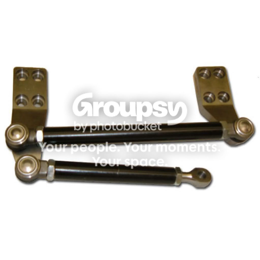

then I found skyjackers crossover kit.
Toyota High Steer Kit - Sky's Off-road Design
the price hasn't changed much, I think I paid $410. they use the same FJ TRE's as the other kits, where they differ is at the steering box. they just have a big block with a tapered hole, that accepts the stock pitman arm. perfect.
skycrossoversteering.jpg~original
I don't know exactly, but id say its been close to 8-9 years with that steering set-up. ive had ZERO issues. it just plain works.
the other companies no longer use a modified stock pitman arm, they are all new parts built to spec. because of that, im not sure if the sky kit is really all that much better anymore.
but I still like the fact that I can just go into any autoparts store anywhere in the country and order a stock IFS arm., and not have to mail order a custom/special part.

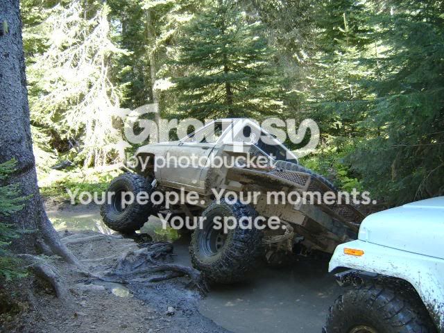

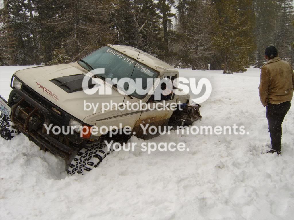

i guess I can talk about this pic now...
rolledonmemday05.jpg~original
it was on our annual memorial day trip. the first run of the weekend. we were about 30 minutes from camp. making our way through a clear cut to the more difficult trail section.
I really like driving over things. rocks, stumps, cars. whatever.
so, when we saw a bigass stump, attempting to drive over/onto it was a given. :D
to this day, I still say it was my buddy that suggested it. and it was done as a joke, it was a BIG ass stump. way too big, theres no way id have enough traction to climb up it.
or so we mistakenly thought. I eased up to it, and gave it a little gas(this is after the v8) that thing has a LOT of torque.
also, I think at the time, my throttle cable was too short, and there was a bit of movement in the cab, and possibly the engine flexed on the mounts.
the left front tire bit into, and then it sort of throttled itself up the stump. by the time I realize what was happening, it was too late. we were on top.
not a big deal...except we teetered on 3 tires, and being an automatic, it just kept driving!
so, while I should have thrown it in neutral to stop, I hit the brakes.
that sudden STOPPING was just enough enertia to tip us over. it was SLOW. so slow. thinking back, if I would have stabbed the throttle and steered to the right, I could have saved it.
but, I was shocked. just so surprised of what was happening.
at the time, my pup was in the back of the track, on his leash, attached to the bed. luckily he just stepped onto the ground and was fine.
my buddies had him unhooked before I ever got out of the truck.
which, for anyone that hasn't been upside down in a vehicle before, its very disorienting.
you would think, since you're still sitting in the seat, that everything would be just as it was. not so much.
the truck didn't die, not sure how, but it was running. but, oddly enough, it took me at least 5 seconds to find the key switch and turn it off. it may have died on its own by that time, I don't remember. but, it was strange, not being able to find the key. I was in fact still belted and sitting in my seat, albeit upside down.
unfortunately, I had the only winch in our group. it was that 8k mile marker mentioned above. in fact, that may have been the first trip out, I cant remember..
also, my snatch block was IN my truck box, which was packed to the lid, and also upside. DOH!:frusty:
luckily another buddy had an old-crusty-questionable block. so we ran out some cable, hooked the block to his truck, and ran the cable back to my truck.
I winched myself back over. :D
it was upside down about 30 minutes. i checked all the fluids, everything was good. only lost a tiny bit of PS fluid out the cap. it started right up! it did smoke a bit, but otherwise, all was fine. except...
if you look close in that pic, i landed squarely on a log. it creased in the top of the cab, and wiped out the window. damnit! we carefully kicked the window out, it was snowing before we finished. awesome.
then it turned to rain. it rained for 5 days straight. it was the wettest, most miserable most FUN wheeling trip ive ever been on.:D
im not sure what it was about being drenched in a down pour, without a window, but me and my buddy laughed ourselves silly. all weekend. it was great.
also, id like to add, i did have an interior roll cage...of sorts. it was some crap we scabbed together. it was pipe, not tubing. NOT good for a cage. we also had no idea what we were doing...so it wasn't even a good design with inferior materials. but, im POSITIVE it prevented more damage to us and the cab than if we didn't have it. the main upper hoop bent in pretty good.
even tho it bent, im glad it was there.

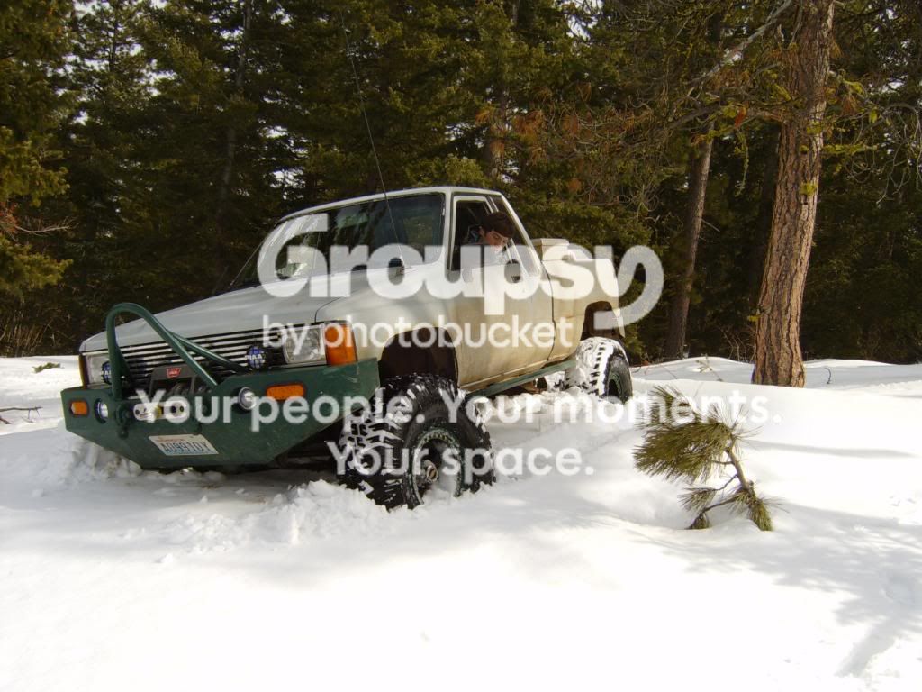

more random wheeling pics.
collinsfirstruninjeepjan3rd001.jpg~original
collinsfirstruninjeepjan3rd002.jpg~original
collinsfirstruninjeepjan3rd003.jpg~original
my 3 legged dog, he loved the snow.
collinsfirstruninjeepjan3rd009.jpg~original
S5301203-1.jpg~original
the group trying to follow my tracks.

oh yes, after getting the mile marker winch, I soon found out how good my charging/electric system was...or rather wasn't.:ybrick:
this was the first winch id ever had, and pretty much the first winch our group had. at least the first that got any real use.
being that it was the only one, it got used a LOT, and heavily.
from pulling my heavy truck through the deep snow, to winching me and a disabled JEEP strapped to my bumper up a slick muddy hill.
there was one trip, where that jeep was strapped to my bumper that I finally decided it was time to upgrade some things.
not sure on the time, or time of year, but it was cold and dark.
the heater on high, both electric fans running, and the headlights on.
there just wasn't much left for the winch.
even running the rpms up high, to get as much charging as possible, the winch would still run the battery down so far that it would actually kill the engine. there wasn't enough juice left to run the ignition. it was a LONG night.
but, I decided then, I was getting a high output alternator. I was still using the stock one, which I think is good for something like 45 amps:pound: I also was still using a basic "stock" battery.
