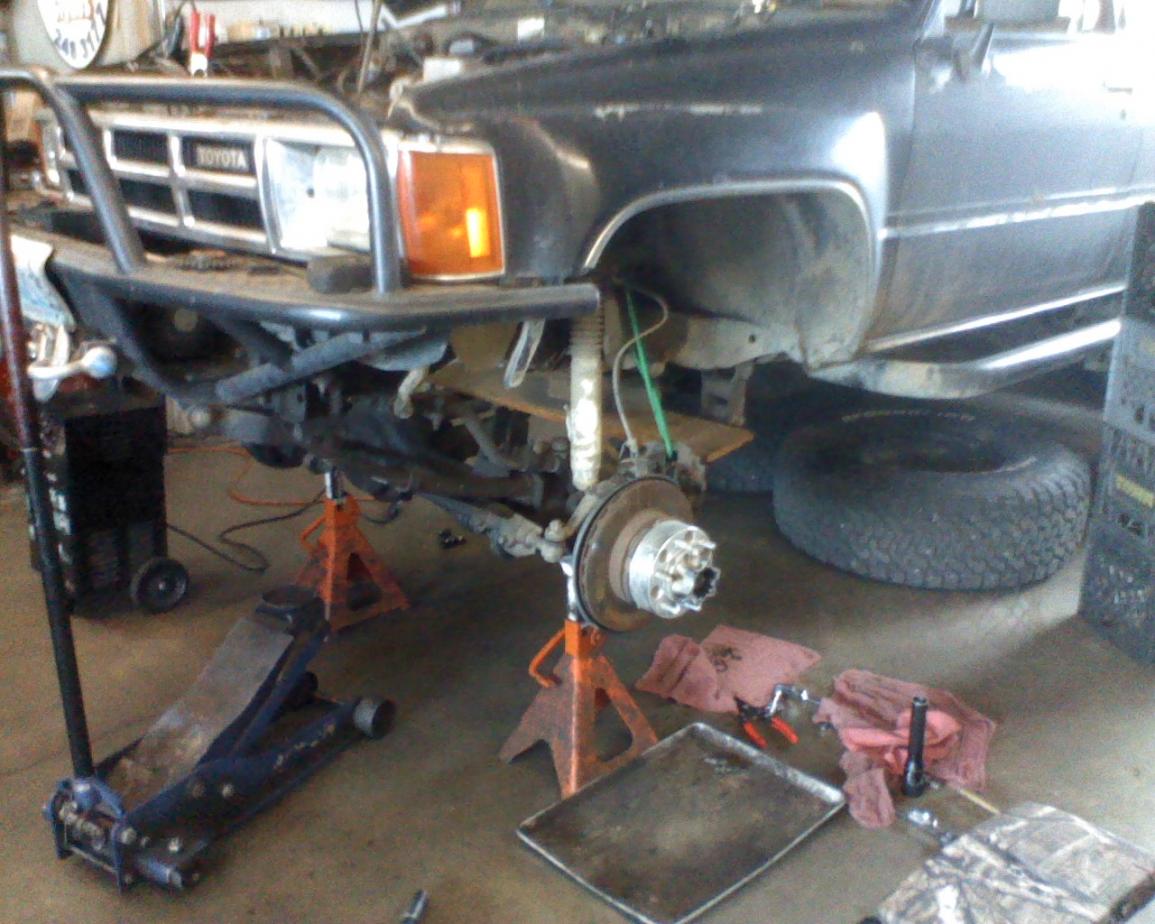

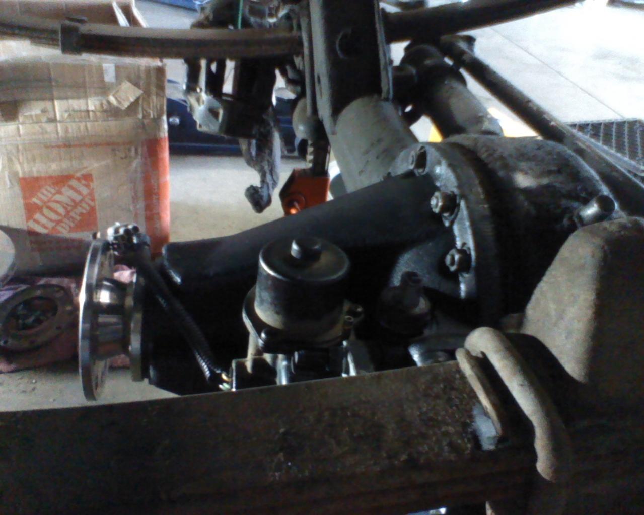

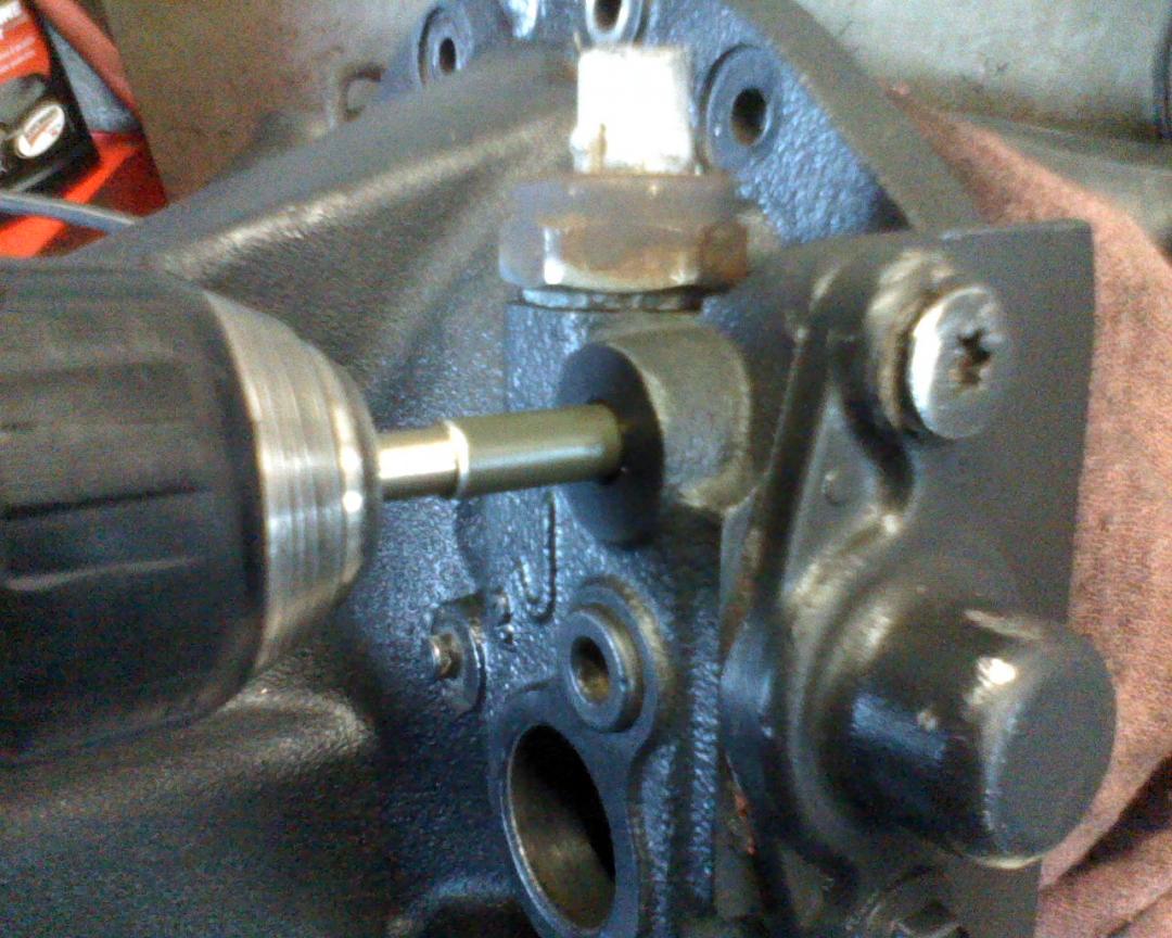

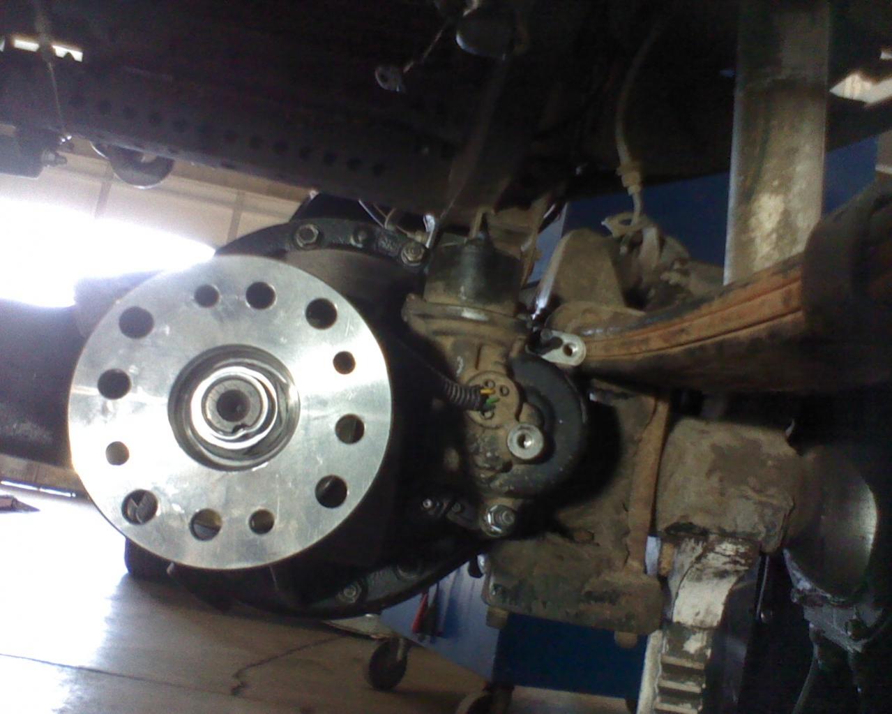

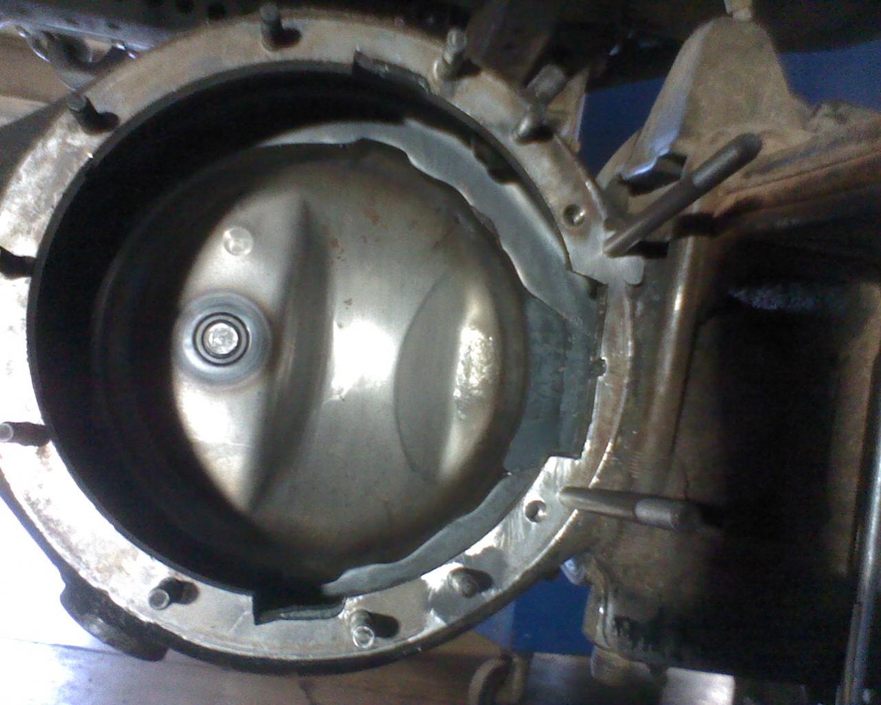

Work was slow a few weeks ago, so i pulled the 4runner into the shop and stared working on the Elocker.

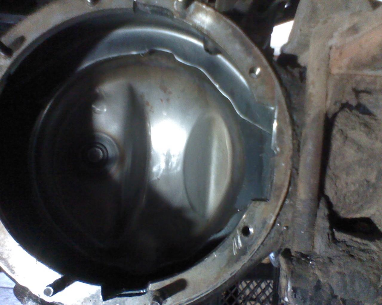

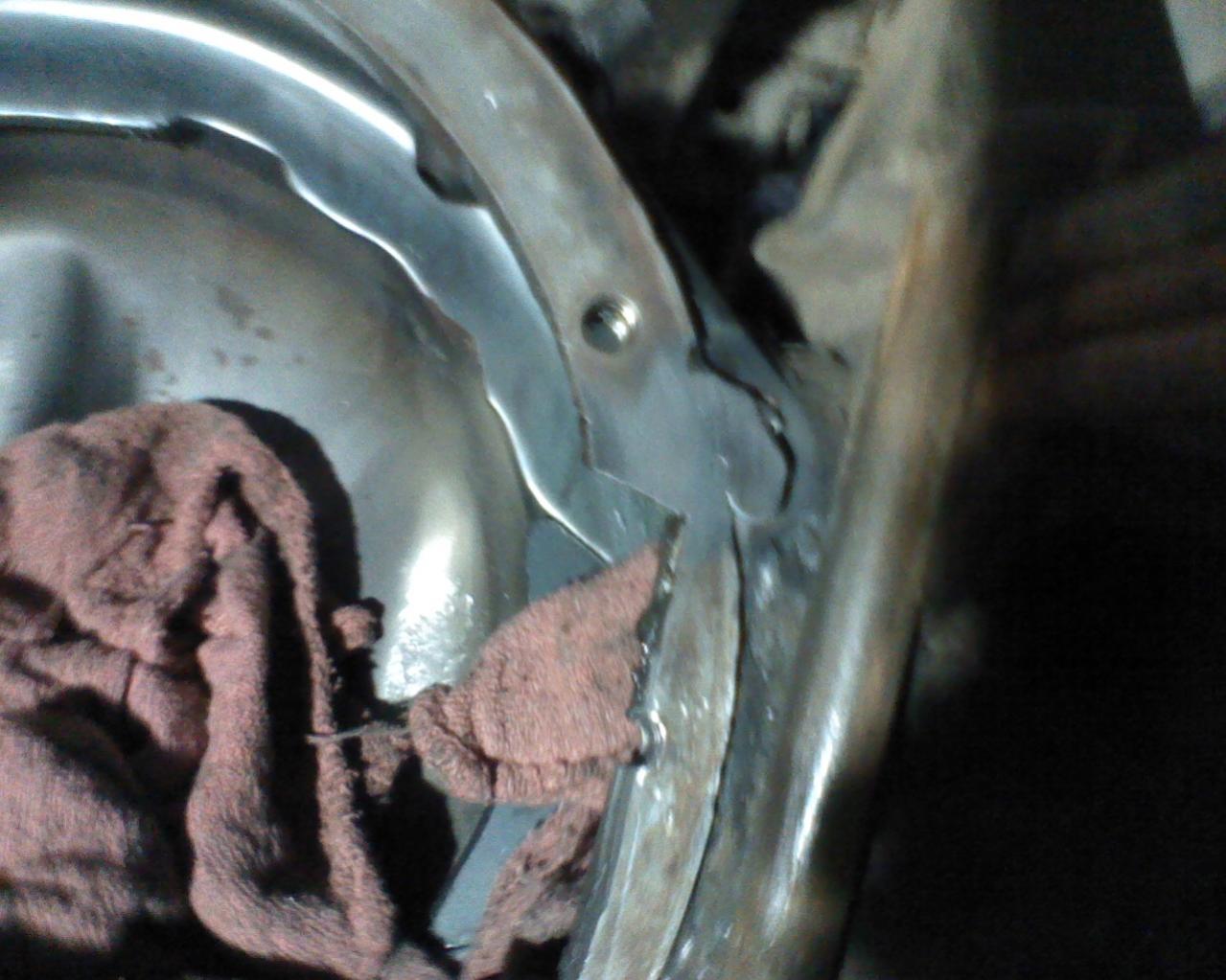

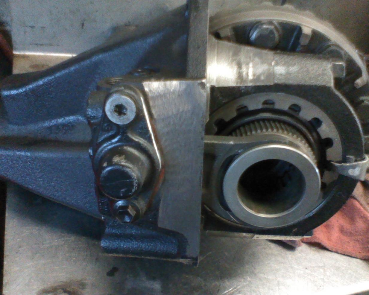

i had to do a bit of grinding on the housing to clear the leaf spring. plenty of meat there, so no issue.

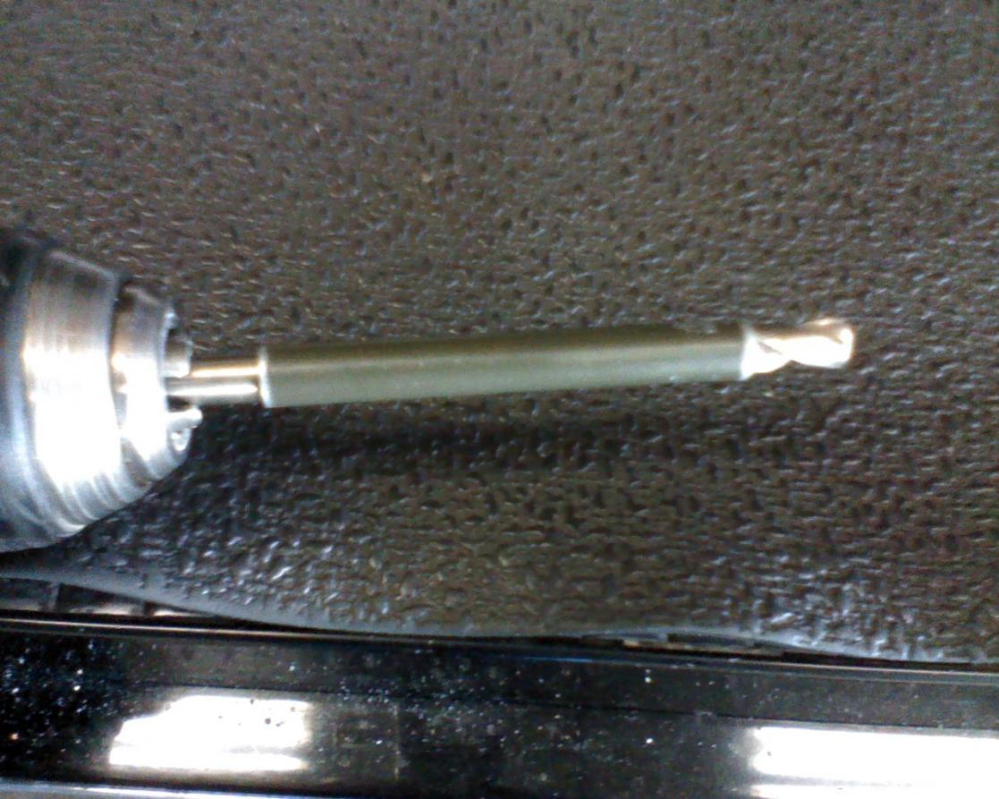

the trickiest part was drilling the holes. i made a little bushing out of some 3/8" brake line. worked perfectly to get centered holes exactly where i needed.

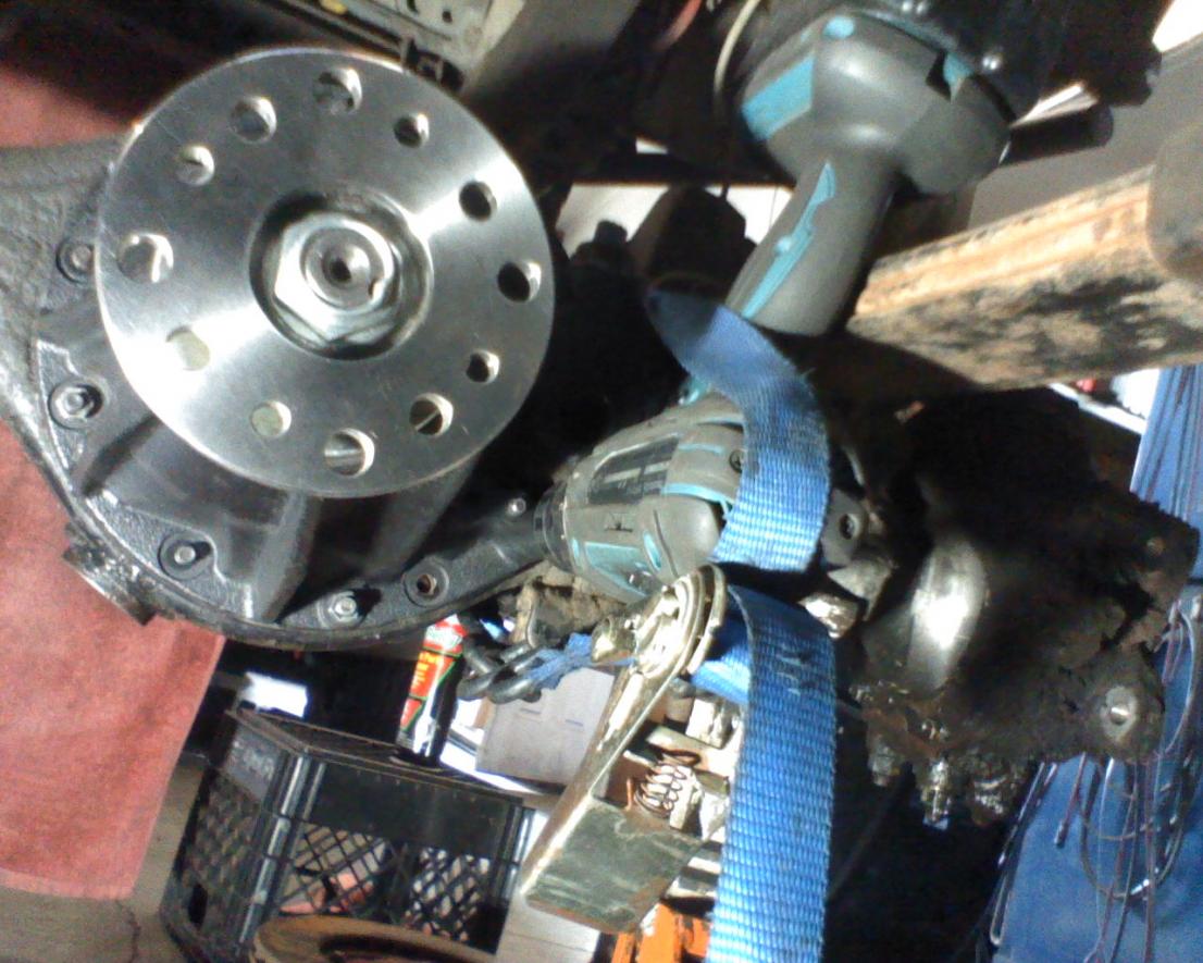

oh, and drilling into a weld...not as much fun as it sounds. lol.
i ended up looping a ratchet strap around the end of the drill to get enough pressure to drill. doing it all by hand would have been ridiculous. i see why a lot of guys pull the housing and use a drill press.

in the end, it ended up being easier than I expected. I still have to route the harness, and mount the switch.
but...still without an engine, that can wait. lol.
