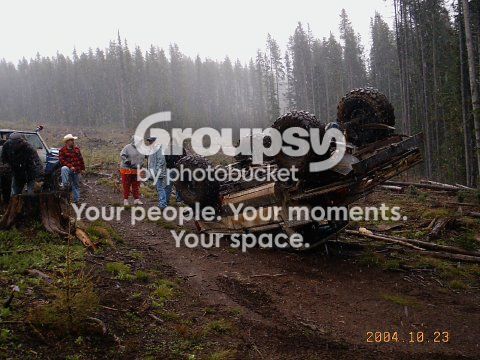

I found some more pics of when I rolled.
you can see the stump in these.
006_IMAG0004_zps1275bea9.jpg~original
004_IMAG0002_zpsb9308398.jpg~original
the stump itself isn't TOO tall, but the ground at the road is a bit lower, making the overall height a bit too much :D

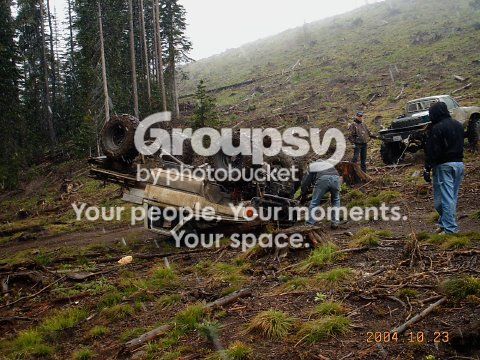

here we are later in that trip,
001_DSC00569_zpscc643cec.jpg~original
you can see where the top of the cab goes up right in the middle. we used the hi-lift jack on it.

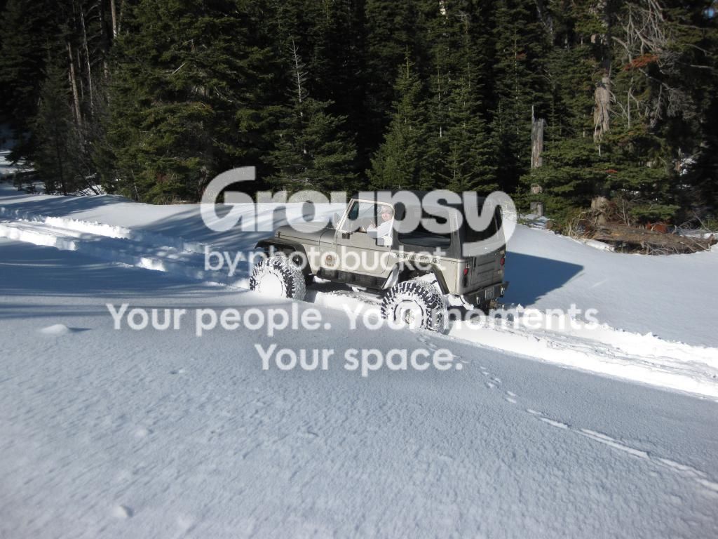

random pic, and short story :D
S5300154_zps760a58a4.jpg~original
we came across this spot in winter, when there was a bunch of snow.
after driving through that section a few times and stabbing the throttle, I figured I could probably lay the truck over on its side. it would be nice and gentle, and land in deep snow.
it took a few tries. the first couple times, we just drove on 2 wheels before it settled back down.
NEED MORE SPEED!
I think the 4th try it flopped over. a few of us just pushed it back on the tires. that was the first time on its side, it has happened a few times since then..mostly on purpose :lol:

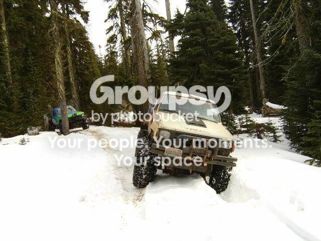

you cant tell because of the snow, but there is a bridge under me, and I drove off the left side of it.
had to winch me backwards to get back on.

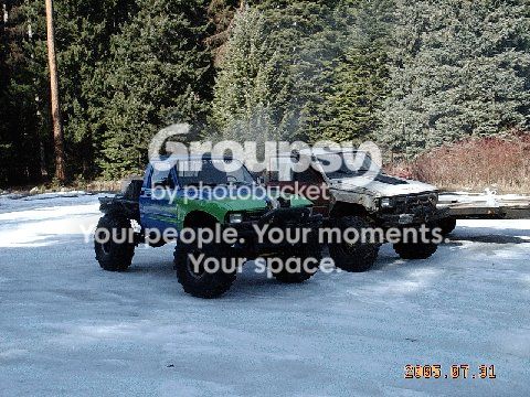

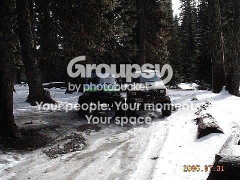

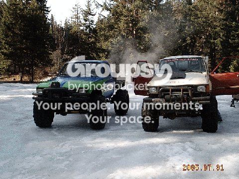

just by chance we both had our extra doors on, and they were both red.
I swapped them on, after I rolled. but I ended up putting the original doors back on, since they fit the crushed cab better. haha. I think he was in the middle of building half doors out of the originals.
here it is later, after he painted it.
Pic003_zpse8aae355.jpg~original
as you can see, mine are still red.

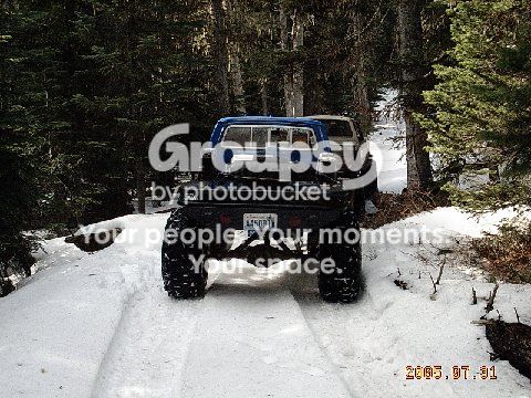

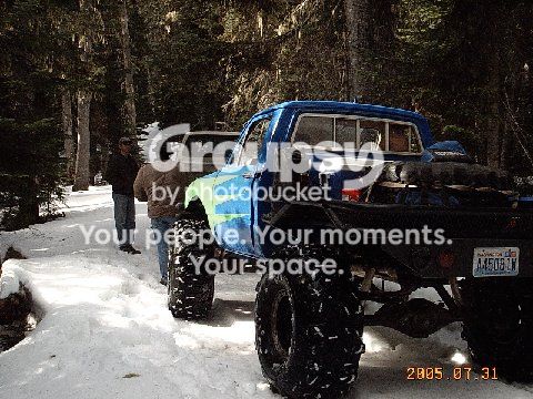

you can kind see the flatbed he built. it turned out really nice, with built in jerry can holders. one on each side.
Pic005_zps7f82bce6.jpg~original
Pic004_zps2efb5a47.jpg~original
hes running 38" swampers, and 4:10 gears, welded in the rear, and an 87 22R. it did amazingly well.
