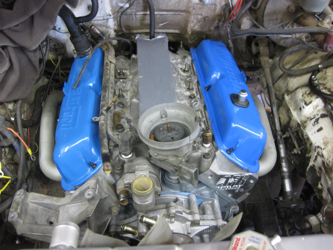

I don't think I posted about it in here yet, but im in the process of swapping a new engine into my truck.
I started working on the replacement engine back in april or may of this year. im using a 98 ford explorer 5.0. it uses a roller cam, and I added roller rockers. so a full roller block.
its got a Scat 331ci stroker kit with forged pistons and AFR 165 Aluminum heads. topped with a mustang intake, and explorer throttle body.
we're guestimating in the 350hp, and 350tq area.. should be a BUNCH more power than what I had before...
the explorer engine is great, because it uses a short snout, reverse rotation water pump, and serpentine belt system. making the engine 3" shorter than the standard 302. this should allow an engine driven fan, thus zero cooling issues.
sneak peak. it is currently running, but we're still working on getting it tuned.

Snow wheelin time of year. Hows this thing running?
ive taken it out a few times. runs GOOOOD. tons of power. still a few quirks to work out, but it might have to wait until I can afford a good data logger to really get it dialed in.
super happy to have fuel injection now. so nice to just hit the key and walk away. I have quite a few pics, I think photo-bucket works again, I might have to see about uploading some.

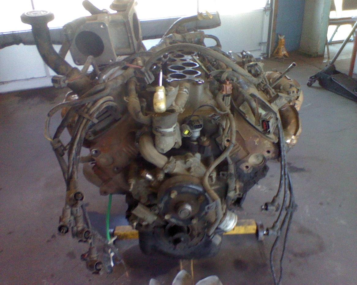

idea of the extra bottom end power. spring time of last year I was given a donor engine. to avoid downtime this was ideal. even better, this was a later model ford explorer roller block. a 98 to be exact. its not new by any stretch, but it IS 30 years newer than the motor I was running lol.
this is what I got.

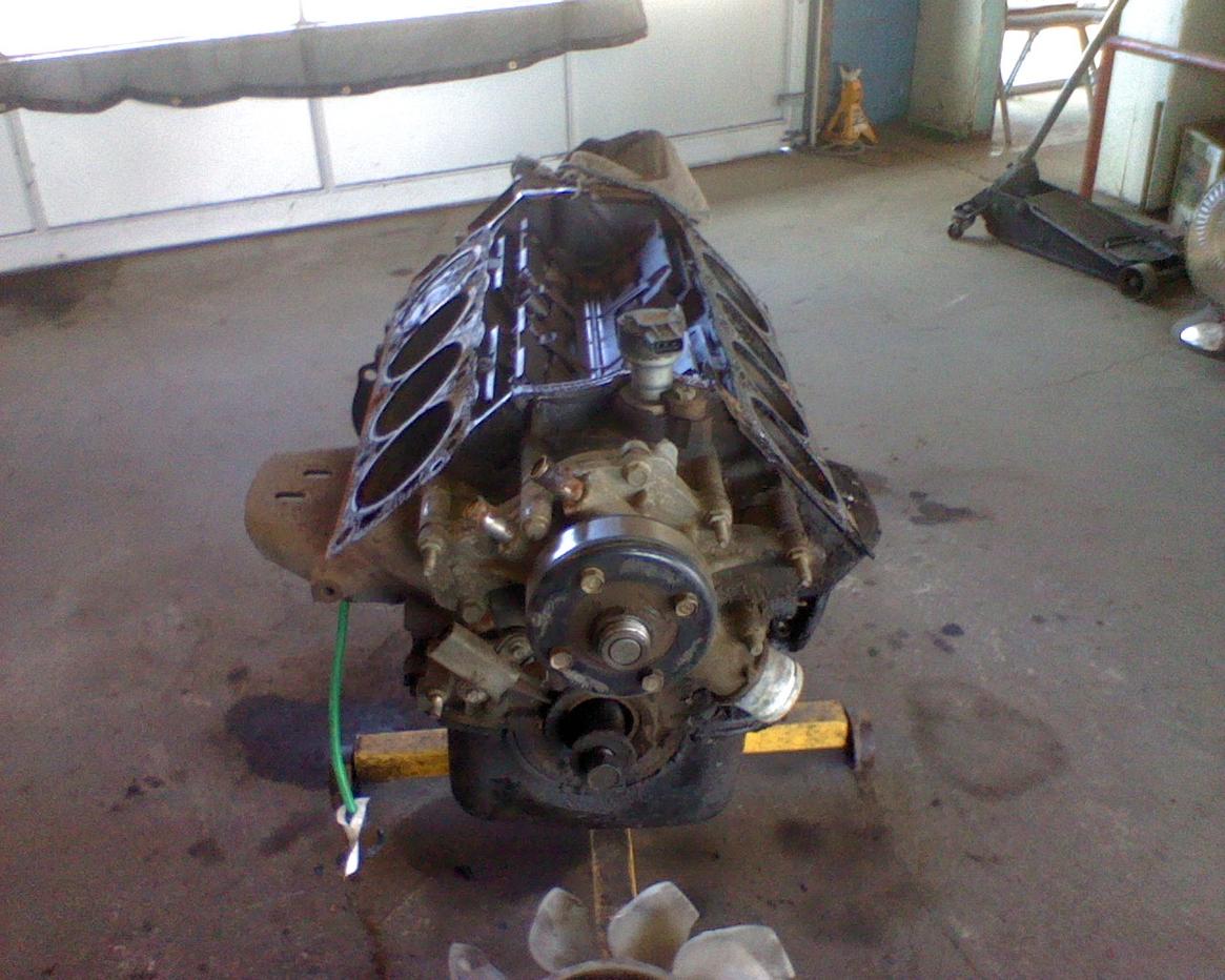

part of the deal with getting this engine was, they wanted to keep the factory gt40p heads. some of the best flowing factory heads out there. no big deal, along with the stroker, I had decided on some aftermarket heads.
after tearing it down.

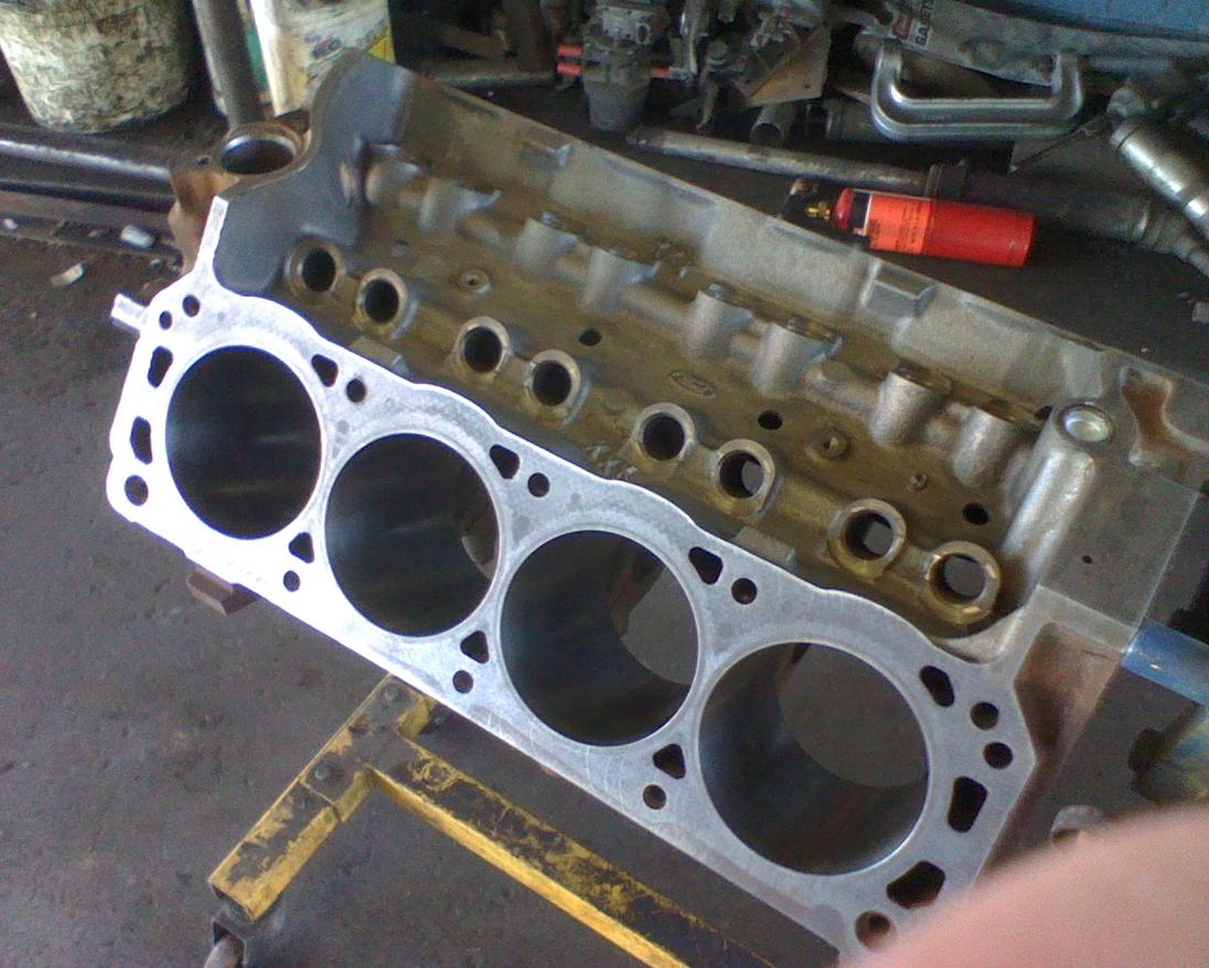

got it sent off to the machine shop to get the block decked, and bored over to accept the pistons in the stroker kit.
attachment.php

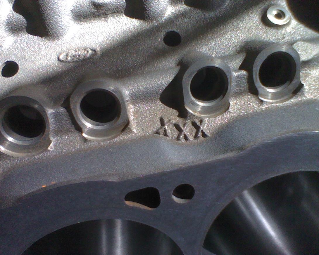

triple x block, it has to be good right? :D
I think this just means it was built at the plant in mexico. nothing special really.

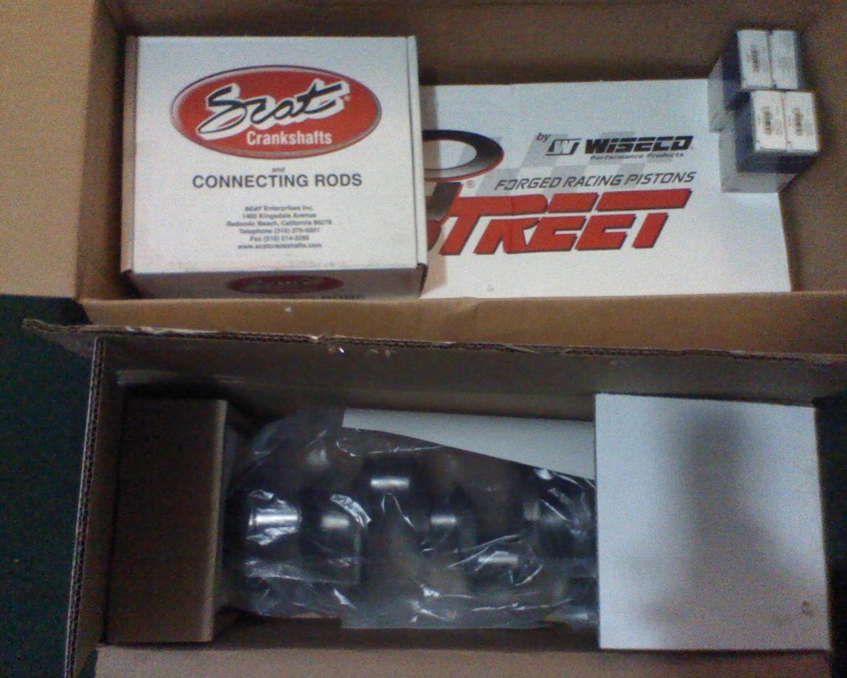

while waiting for the block to get back, I was ordering parts. they slowly started rolling in.
Scat 331ci stroker kit from adperformance. steel crank, and forged pistons. good for up to 600 HP. more than a stock block can support lol.

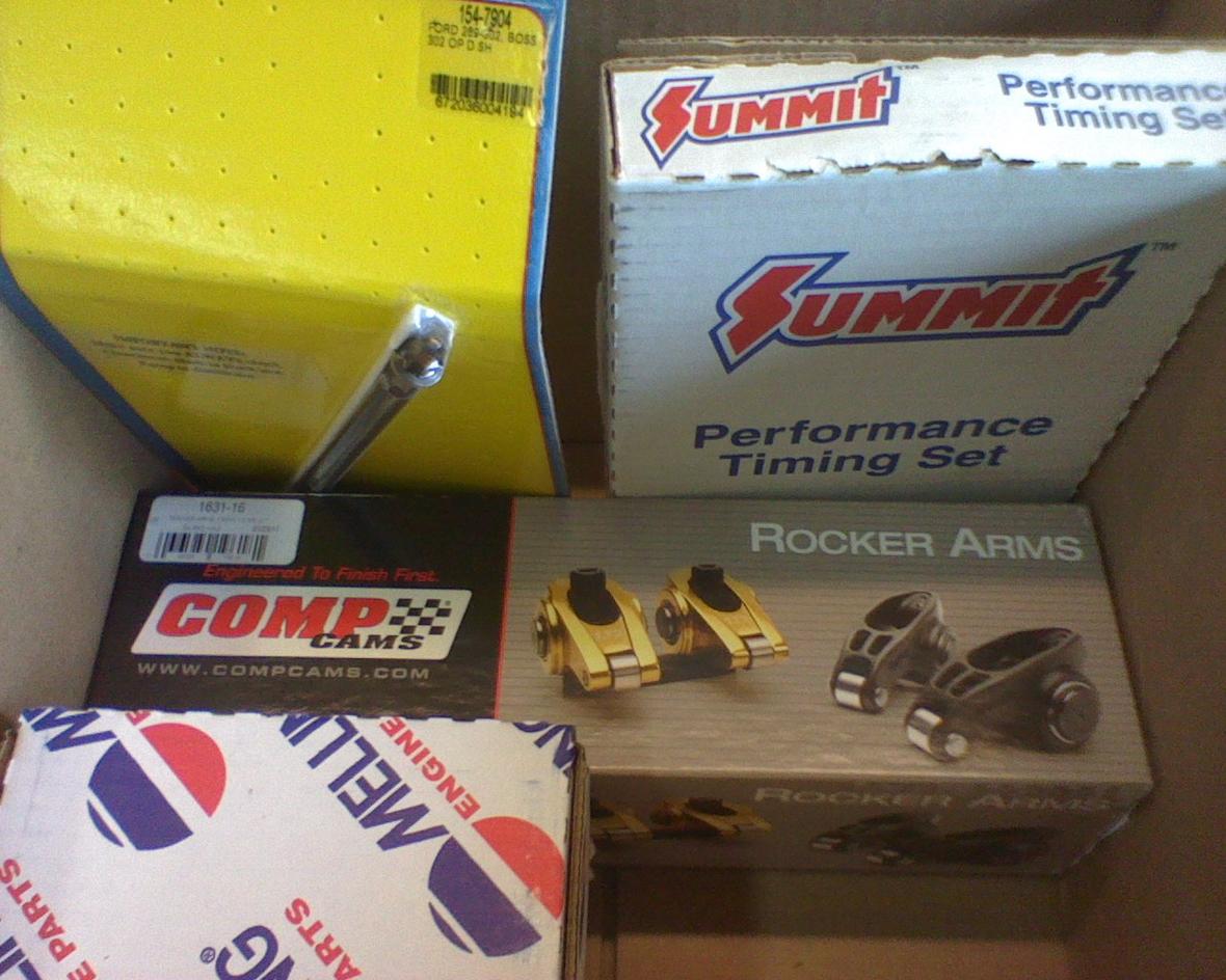

comp cams 1.5 roller rockers, a double roller timing set, upgraded oil pump drive, and a high pressure oil pump.
attachment.php

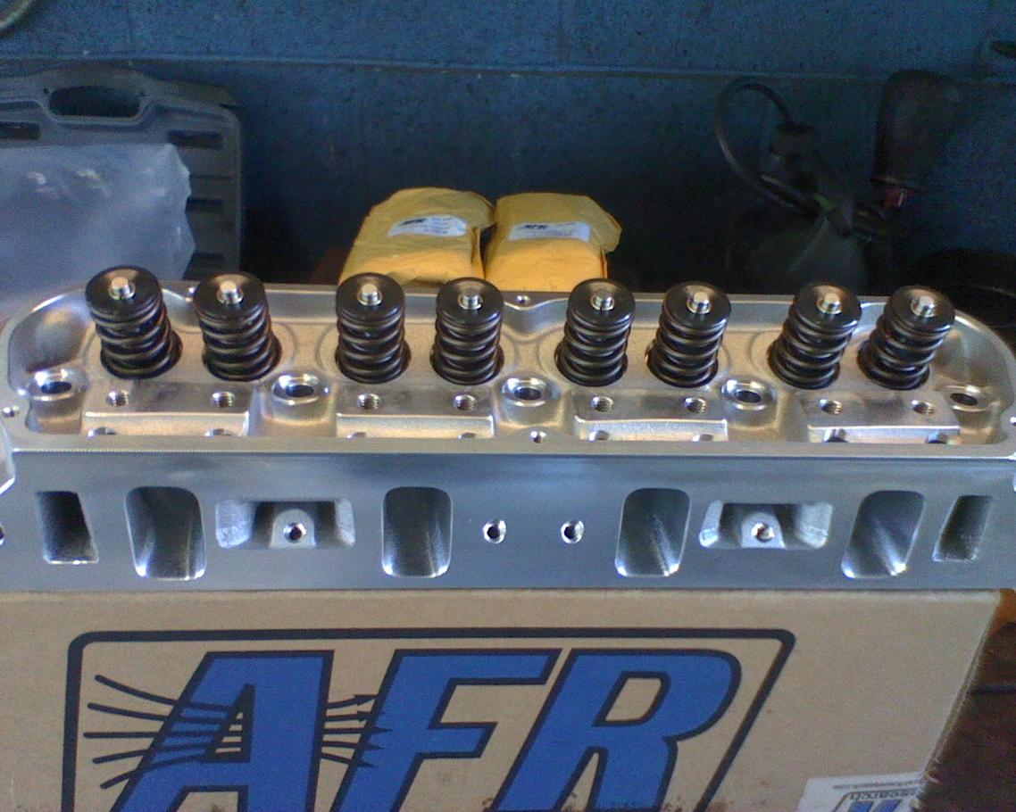

and finally, the parts that really make the power. new heads.
attachment.php
I went with AFR 165's, with 58cc chambers. since my goal was low end torque, I didn't want the larger 185's, I would rarely if ever get over 4k rpms where the bigger heads would really shine.
these things are a work of art. fully cnc machine ports. supposedly just bolting on these heads gives an increase of between 75 to 100hp. incredible.

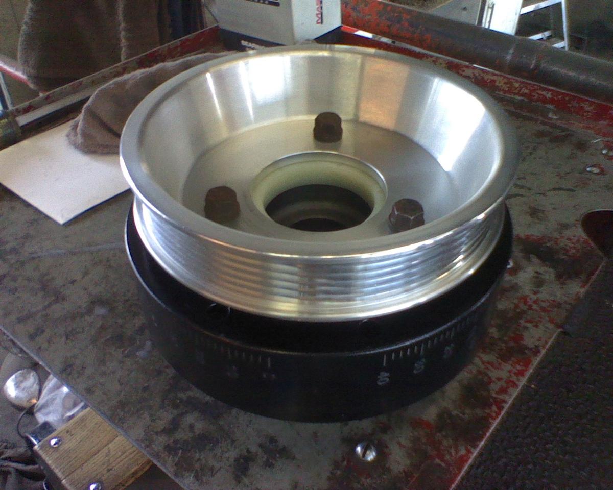

and 2 pieces that don't seem like much, but without them this project would be MUCH more difficult.
a new bolt on serpentine pulley, and the proper 28oz balancer.
attachment.php
small block fords are externally balanced via the harmonic balancer on the front, and the flywheel/flexplate at the back. the crank is ALSO balanced to work with the other pieces for a smooth running engine.
well, ford changed from a 28oz imbalance(on the crank) to a 50oz for the later years, I don't remember exactly when they switched.
the stroker kit is designed around the older 28oz engines. but for my project I needed the serpentine belt pulley, and those are only offered on 50oz engines. doh!
luckily I found a company that builds a bolt on pulley, specifically for this type of project. in fact, this was the ONLY one I found. there may be others, but I didn't see them.

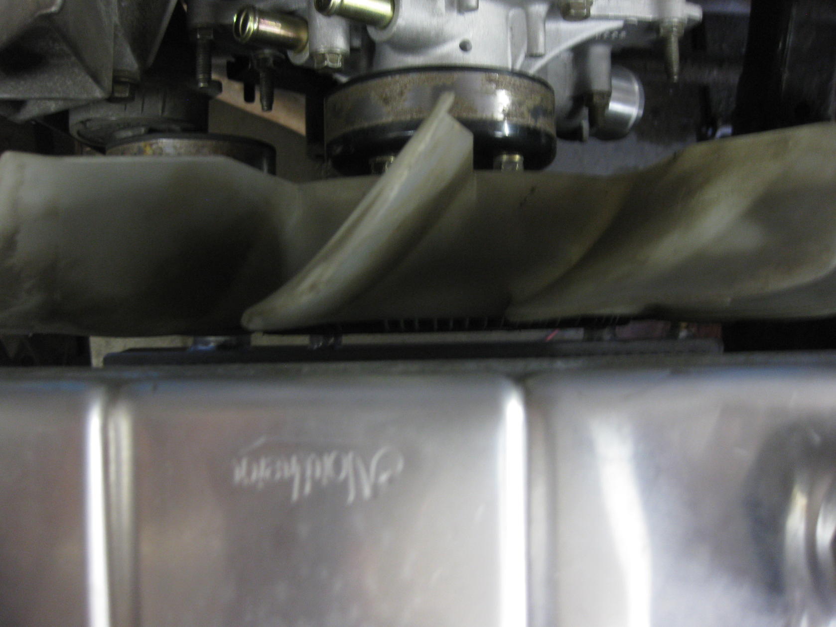

the nice thing about using that pulley set up, it allows me to use the explorer front drive. early mustangs also had a serpentine system, but the explorer stuff makes the engine 3" shorter overall. everything sits up tighter against the block. my goal was to be able to use an engine driven fan and stock clutch.
out of order pic, but it worked!
attachment.php
not a lot of room, but still more than I had before and that was without a fan.

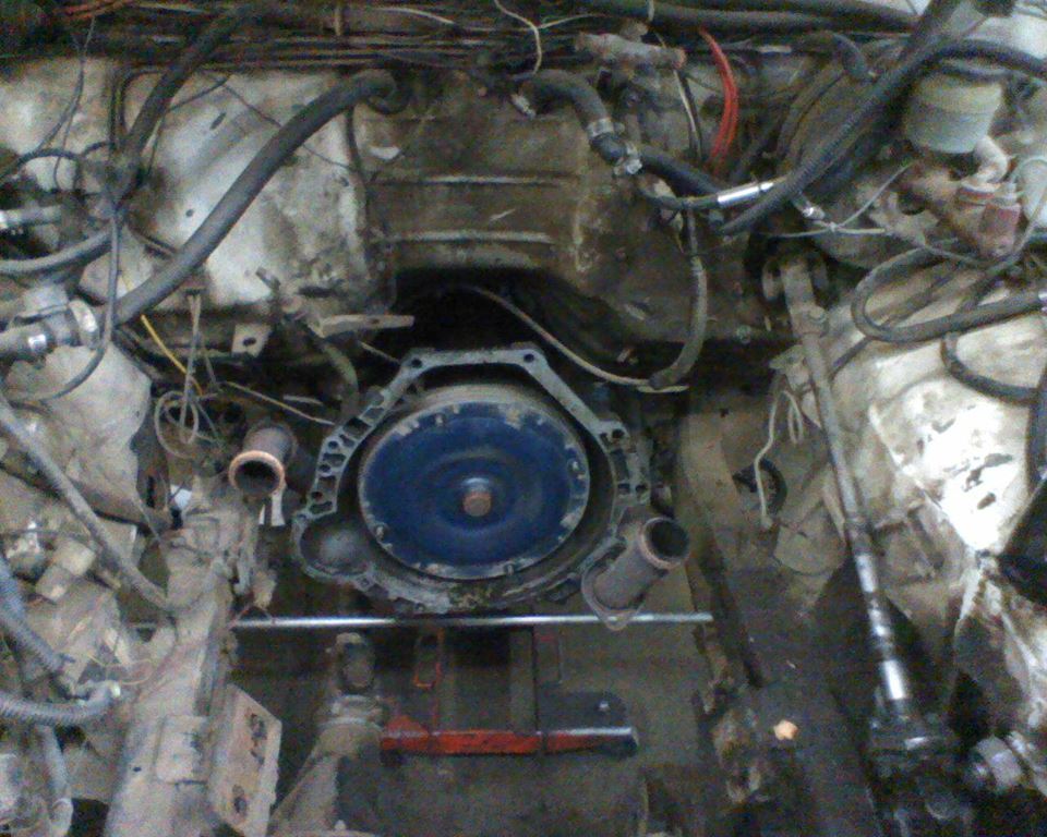

the old engine out.
attachment.php

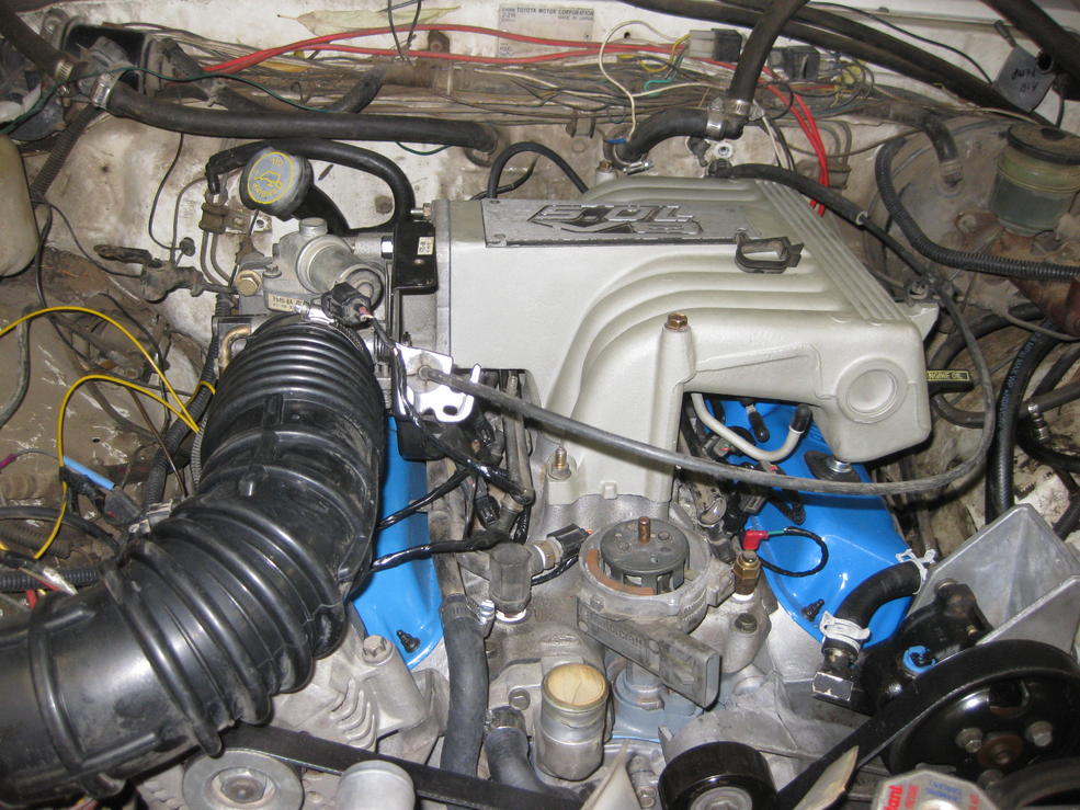

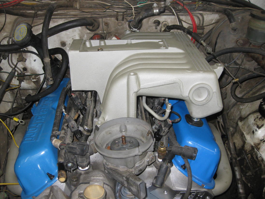

I ended up having to use the original 68 valve covers. the 98 covers weren't tall enough to clear the roller rockers. even with the old covers, I still had to modify them by removing all the internal baffles. I also had to cut the oil filler tube off the 98 covers and weld it onto the 68. not exciting mods, and I didn't get any pictures. but it was necessary to make this work.
not pictured was the new full length headers. I had them ceramic coated for heat removal. I also had the upper intake coated, which you can see here. you can also see the edge of the headers lol.
attachment.php

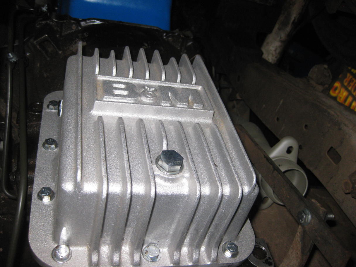

to help the transmission deal with the added hp/heat I add a finned aluminum pan that allows an additional 2 quarts of fluid.
attachment.php
