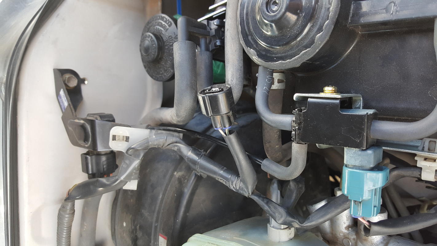

I noticed that if I unplug the vsv sensor, but leave the vsv and intake lines attached the noise goes away. No clicking, no "thup thup thup", no idle issues, and no drive-ability issues.
I still have the Vapor pressure sensor plugged in, as well as the blue sensor that is it's corollary.
The pictures show the sensor in question.
So my question is: Can I get away with this "fix"? The solenoid clicking seems to be an engine computer malfunction more so than a genuine mechanical issue. I suspect that my engine computer adapted to my broken canister a little too well, and now that everything has been replaced its just wrong.
