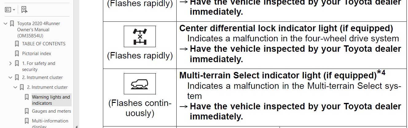

My wife started to back up and noticed this. Pic inside.
Third Gen would throw VSC/Trac and CEL with an evap code, such as when the fuel filler cap was loose. Anyone know what Gen5 does in this scenario? This many lights seems like overkill, but maybe?

Multi-terrain Select indicator light (if equipped)*4
Indicates a malfunction in the Multi-terrain Select system
 Have the vehicle inspected by your Toyota dealer
immediately.
immediately.
