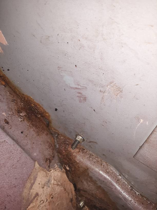

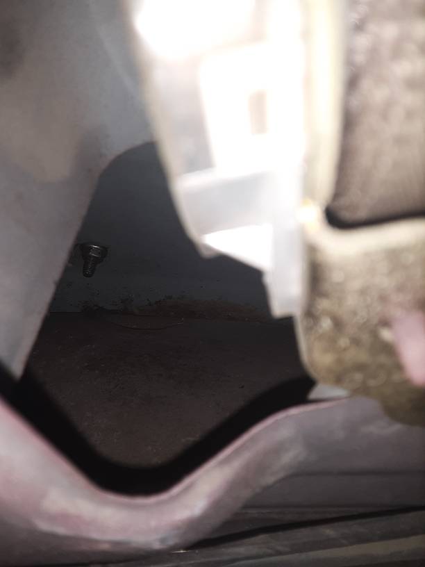

I actually have those inner panels under FF. They haven't changed any in 2 years. Here are the photos. The bolts are nutted to the flare then nut in the inner body panels. You can see the front one is s pita to get to but you can get in there with a hand wrench and snug it up 20201223_131015.jpg20201223_130929.jpg

With the bolts and clips off I marked were I wanted it with a sharpie few alignment dots. Then I put silicone on the tabs were my bolts were going to be. Then aligned and press were the bolts will be. Pull directly off and drill. I wish I had the picture of the bolts on the flare so you know which tabs I used. As I wanted close to the back and front.
Of course you could silicone serveral and see which one works best for you.
I use stainless just in case you need to paint your rig or something you can pull the nuts and the flares come right off. :;)
