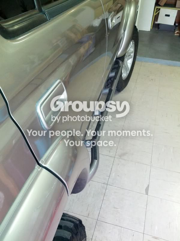

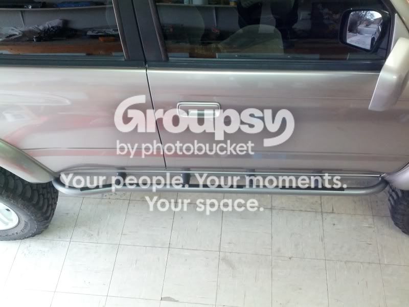

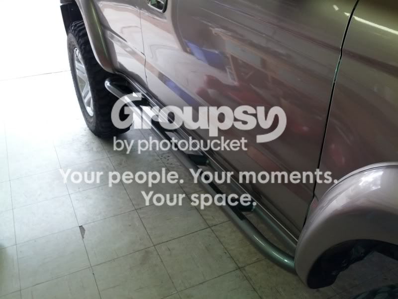

After only having the sliders on for a week i wasnt happy with the finish on them. So i decided they needed some clear coat to help with cleanup and to have some sheen like the rest of my bodywork. I wiped them down with some alcohol and then sprayed them with a couple light coats of Rustoleum Clear Enamel. Supposed to be more durable than regular clear.

I also added some grip tape to protect from scuffs and also to protect the wife and i from busting ass when the bars get wet. Instead of getting grip tape from a skate shop i found precut adhesive strips at Lowe's. They come in packs of 8 for less than $3! Great deal and i think it turned out as good as black griptape on silver sliders can look.

Nice work and I like those Savage skids. Where did you get that grip tape at? I have some I've been meaning to put on, but it's way too wide and kind of a pain to cut.
Thanks Robert, i picked it up at Lowes but have also seen it at Home Depot. It is conveniently sized, i only cut a couple strips to make it work around the kickout. The rest i just peeled the backing and stuck it down, seems to have a pretty strong adhesive.

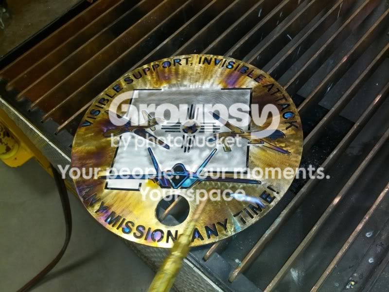

Cut this plaque out at work on the water-jet a few days ago for a SNCO retiring soon. Its mild steel that i finished with various grits of sandpaper discs before colorizing with our oxy rig.
IMG_20130123_085809.jpg~original
