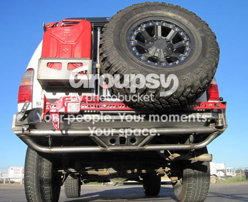

Back on President's Day (Feb. 18) i took the plunge and ordered up a new rear bumper for my truck, specs were to be:
CBI Offroad Fabrication Hybrid Bumper
Centered Tire Carrier
No Jerry Cans
Built-in Hi-Lift Mount
[MENTION=63060]rickashay[/MENTION] 's Lower Tube Tweak
Powdercoated Dark Silver
I was originally quoted about a month wait for my bumper, i took delivery of it on Monday (April 1) exactly 6 weeks later. Some things are just worth the wait! :bigok:
The color and finish looks awesome and i don't think i could have gotten a closer match to my sliders and skids. I know others have had worries and concerns with the Hybrid's tire carrier design. Even with my fullsize spare hanging there, i get ZERO slop and sag with my swingout. I know I'm not hanging a 35 off of it but but i am impressed with the design. Install went pretty smooth and i was lucky to have a buddy helping. Definitely not a one man job. Anyone with any questions please let me know.

Hahah looks awesome man!! Love the color too, nice to see something other than black. The center-mounted tire looks great as well.

Love the look of that bumper with the centered triangular swing arm. Looks great! I couldn't be happier with CBI's products. Did you have to do any kind of shimming to get it lined up correctly? With the exception of widening a couple holes on my frame, mine bolted right up and centered perfectly. Honestly, I was impressed.

thanks Dous, I waited exactly six weeks for delivery of mine, that included a couple custom bends and powdercoat from them.

Hmmm. I kinda thought that your tube bends looked more angular than mine but I just thought it was because mine are black and kinda blend in. I haven't hooked mine yet and hopefully never will but I can see where that little change could make all the difference.

I've never compared the "factory" CBI Hybrid to the "adjusted" one before. Yah, it actually looks more different than I even thought now, seeing them side-by-side. I'm glad I made the small, but subtle change. I've already landed on those corners a ton of times and I've dragged that edge pretty hard a couple time. I think with the factory design I still would have been fine, but they might have hung me up and required a recovery instead of scraping through.
Glad I could help and I'm also glad your liking the minor "tweak" of the lower tubes. Looks great!

I think CBI needs to add it as the "Rickashay Option", looks better and more functional. whats next for your awesome truck?

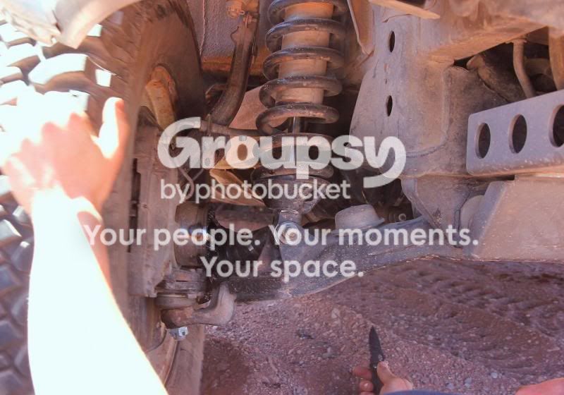

A few weeks ago i ripped an inner cv boot on my right passenger cv, i priced out reboot kits and replacements and thought that to bypass all the trouble of rebooting the stockers that some Duralast Gold axles from AutoZone with a lifetime warranty sounded great! The price was only different by about $8.
Looks good right?
I proceeded to swap both sides out on a saturday before a wheelin' trip the next sunday. Everything went pretty smooth with the R&R of both sides. WELLLLL, the passenger side lasted less than 24 hours! I had already made several difficult and technical lines before the carnage so im not sure if it all happened at once or it failed in stages. When it kicked the bucket fully i had the front over a couple foot ledge and was looking for traction to get the rear up and over. I was sitting on the gas tank and passenger lower link after losing my line a bit. My front Icons were fully drooped out, i contribute that to the breakage but i am still shocked at the break as it occurred with very little load on the shaft. I was almost clear when it snapped.
Before the break, a gnarly climb that i made up.
A few obstacles obstacles later and how it went down.
The mount skids got used also! This link now has a bend. Debating stock replacement or building my own.
You can see here that it looks like the joint locked up and got superheated before letting go.
A buddy cut the inner boot and removed the intermediate shaft as i didnt bring a spare. By removing the Int. shaft i was able to drive home with the inner and outer stubs installed to no ill effect.
Does this look infected?!
All i found after the pop.

You guys are smart for pulling the midshaft. I have a set of inner and outer axle parts in case I blow up my ring/pinion. Nicer to drive it off the trail in 2Lo and do the diff repair at home than having to drop the diff on the trail or risk further damage to the drivetrain.
As far as the rear lower links go, if you have a welder then you can stitch weld on a piece of c-channel for cheap or better yet if Toytec still has them in stock, these weld on skids are top notch. These are rated for around 6,000lbs of load and are the strongest link skids available that I know of for a 3rd gen.
If you go with c-channel use .120 wall or thicker for thickness c

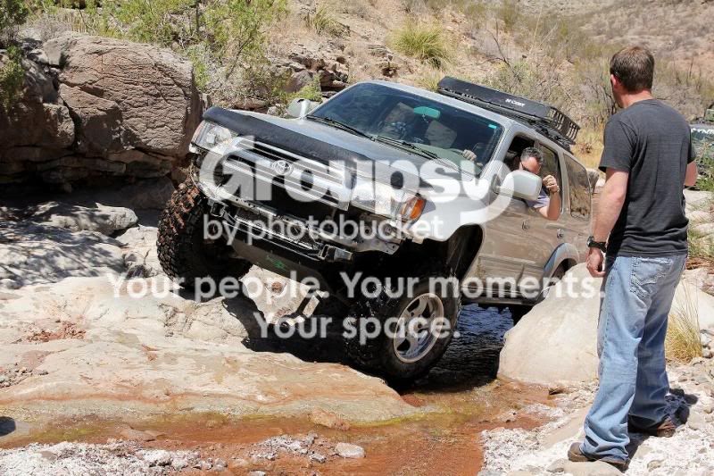

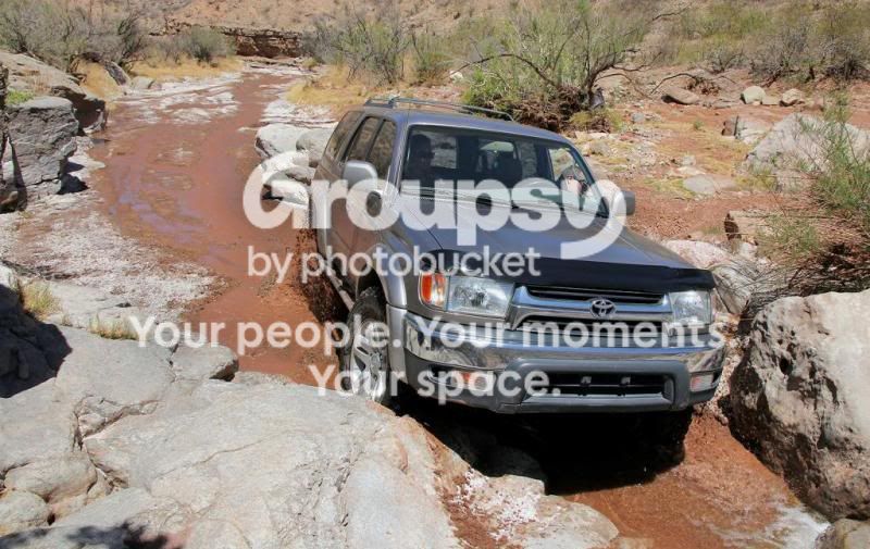

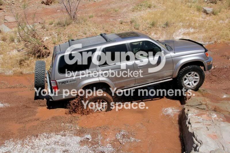

Went out with some buddies scouting for new trails a couple weeks back, gave the new bumper and axles a real workout. We found a really nasty ascent/descent trail that led us down into a 1/2 mile rock canyon. It was awesome, nice and technical. I was the leader so no pictures of my run, then i spotted everyone else through the madness.
The trail started out in a creek area.
The cool thing about our trails around here is most of them you can make as difficult or easy as you like. I tend to hit the more difficult lines. There are several ledges that range from 3-4" on one side of the trail to over 2' on the other. Where the water pools next to the ledges gets dug out and can get fun real quick!

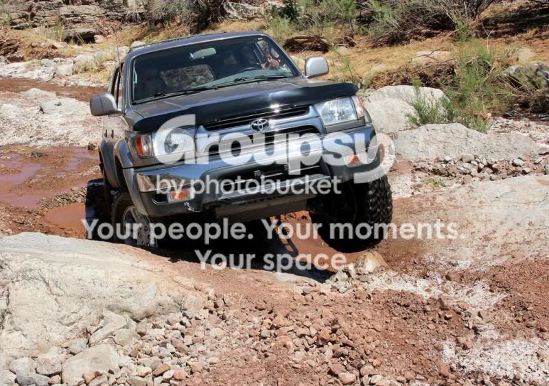

Had to bump it here, thats air under the driver front.
Two large rocks on both side of a pool make this a fun and body damage likely obstacle. The entire driverside gets pushed down into the large rock, sliders are required!
One angle.
Other view.

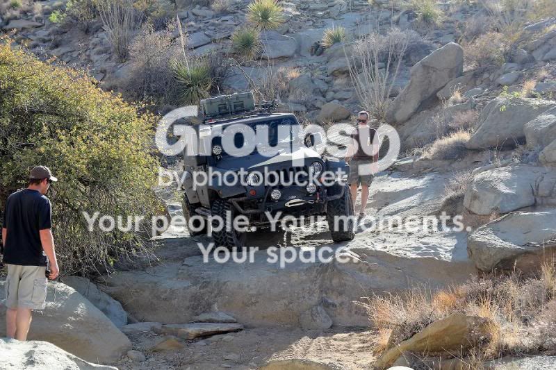

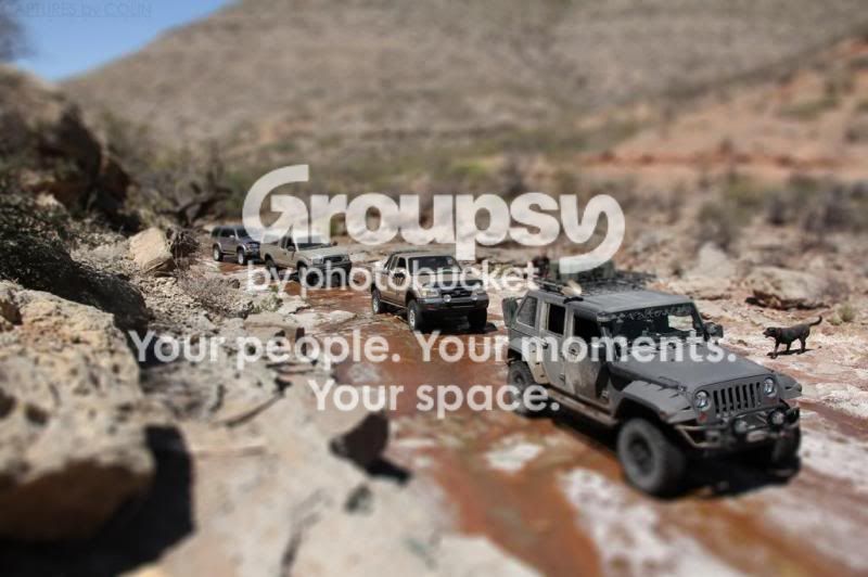

We worked our way to a nice waterfall and had lunch. The guy with the "Bugout " JK has two awesome sister great danes. Kimber and Rolex.

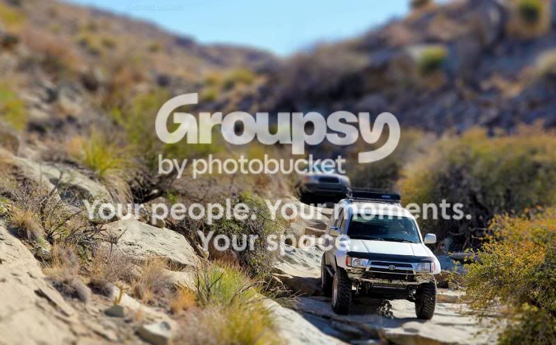

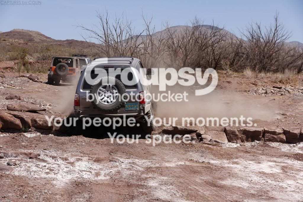

We climbed out of the creekbed area and went exploring next, we are scouting for a large toyota only event in the last weekend of august that gets guests from all over. Check out nmfjrally.com for more details.
[MENTION=85218]Toyotacolin[/MENTION] at the start of the rock canyon

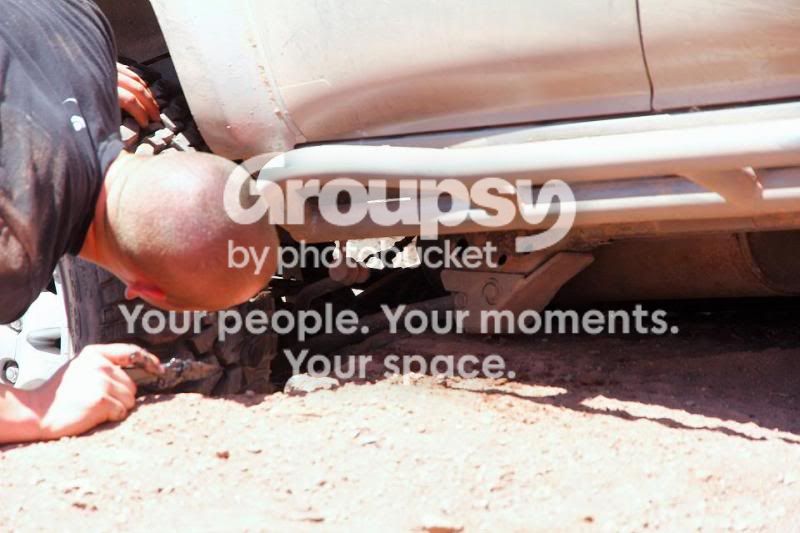

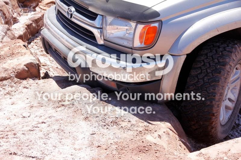

Coming down a steep drop, Colin's hitch served its skidplate duty here. I scraped up my CBI and receiver shackle pretty good here also.
Same spot.
