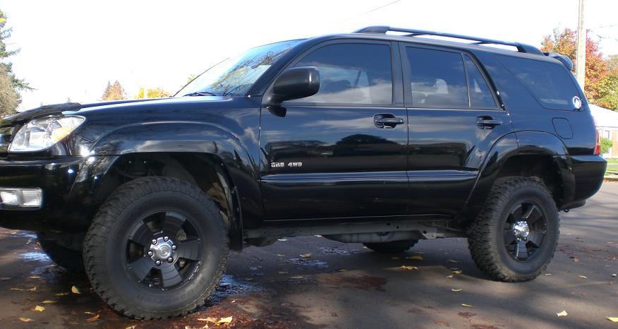

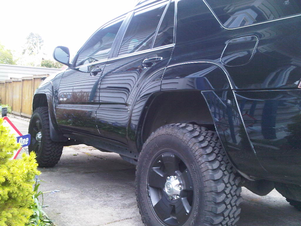

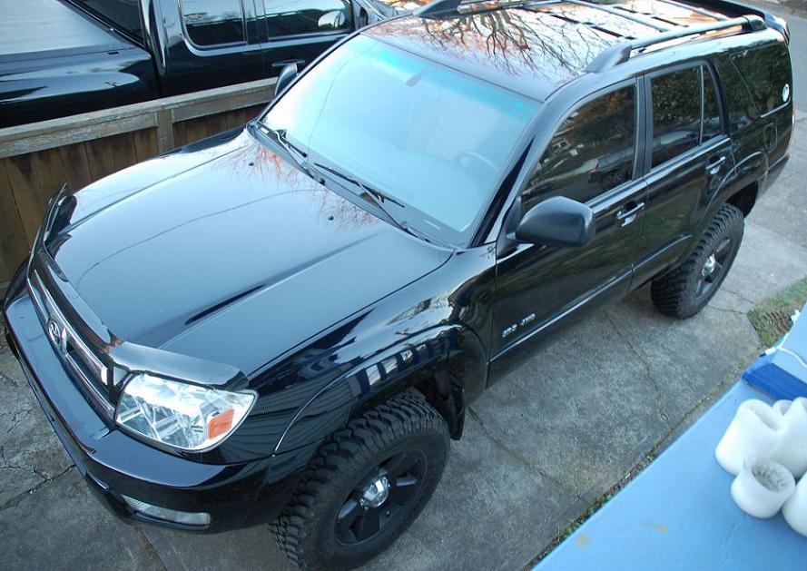

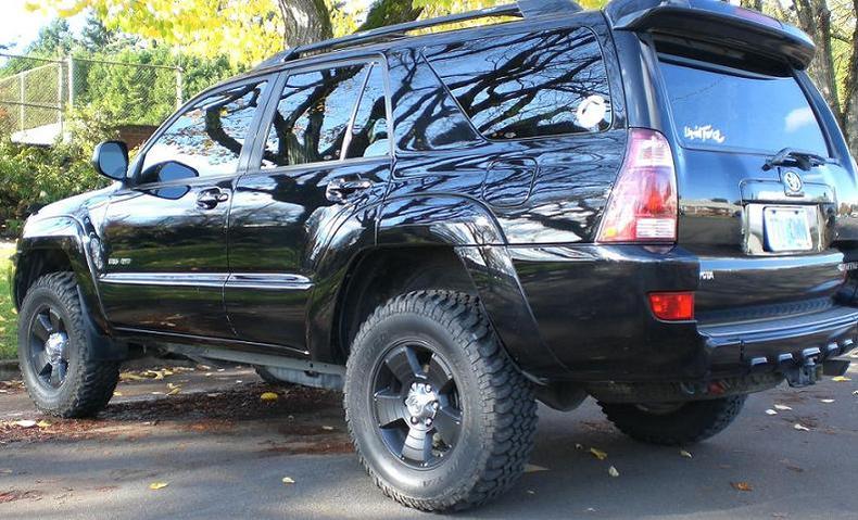

Installed All Pro wheel spacers, went with the 1.5" size. Here's some pics

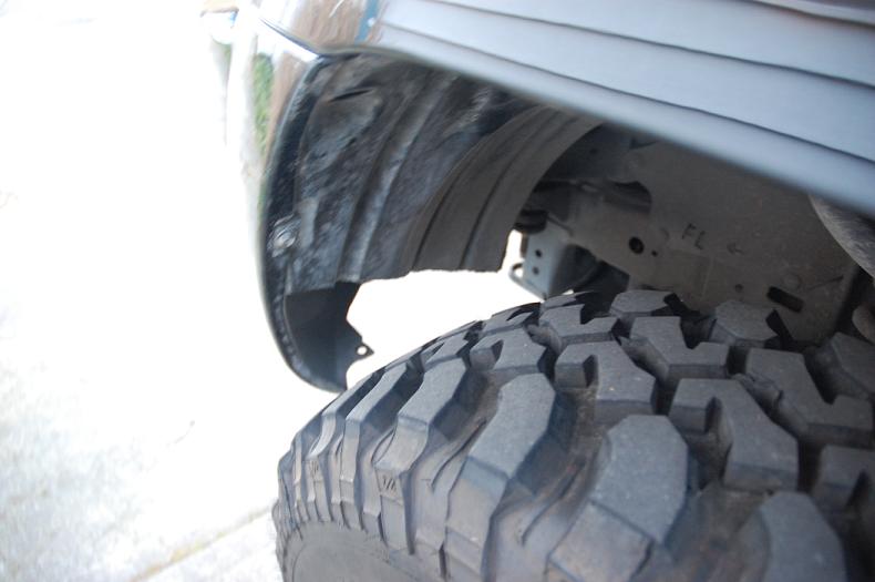

Also had to trim a lot, still rubbing slightly when in reverse and at full lock (not sure what else I have to trim). But not too bad

Thanks guys, I like the new stance too... One thing I didn't expect was increased wind noise on the freeway, good thing I always have music on or else it might bother me. Something to keep in mind for someone who wouldn't like more noise.
But now that I got about 50 miles on them, I gotta take all the wheels off, check and possibly re-torque the spacers...not looking forward to that at all since those tires are heavy as sh**. Maybe someone who has put spacers on before can chime in, did you have to re-torque your spacers?? I did use loctite, and am really trying to avoid taking my wheels off again. But then again I don't want a wheel to roll off either...

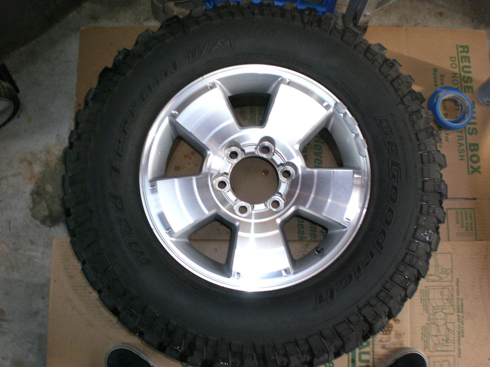

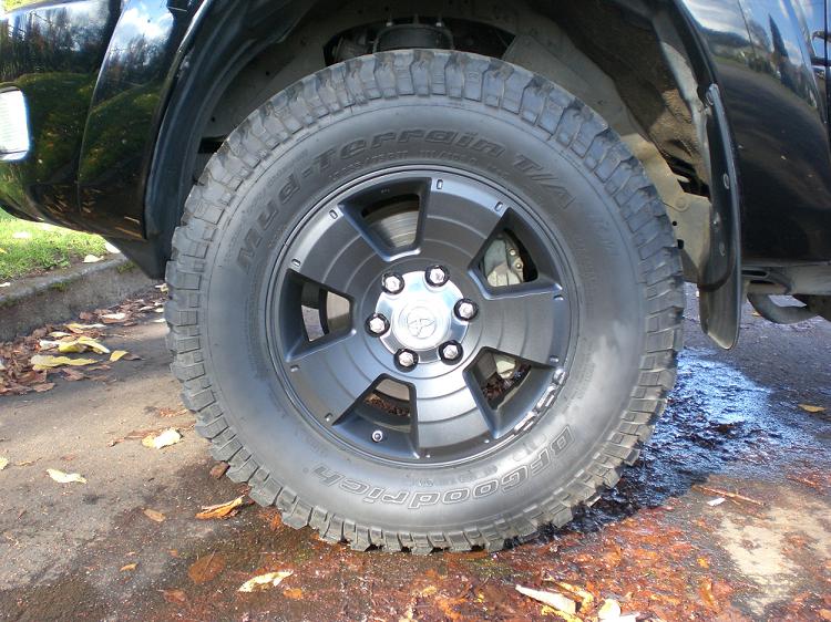

Finished painting my rims black. Used plasti-dip, tried it out on my spare and thought it went on pretty nicely. So did the other rims (and yes it does peel off, so I can always go back to original if i need to)
View attachment 34831 View attachment 34830
View attachment 34829 View attachment 34832
So I set aside the center caps, forgot about them, and then just snapped them on without painting them as well...
Should I leave them as is?
Or paint them black too??
Bought at home depot. If I can remember correctly, I bought 4 cans..... thinking I would use a can a wheel. But ended up only using about 3 for all of them. (Just used some of the leftover to paint my grill too) And yup I just painted them with the tires on, I taped all around the lip where the tire meets the rim. But if you do that make sure you peel it off right after your done spraying. If you don't then make sure you score the edges once its dry or you might end up peeling up the rubber off the rim. Been about 4 months, still holding up nicely

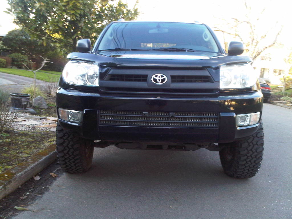

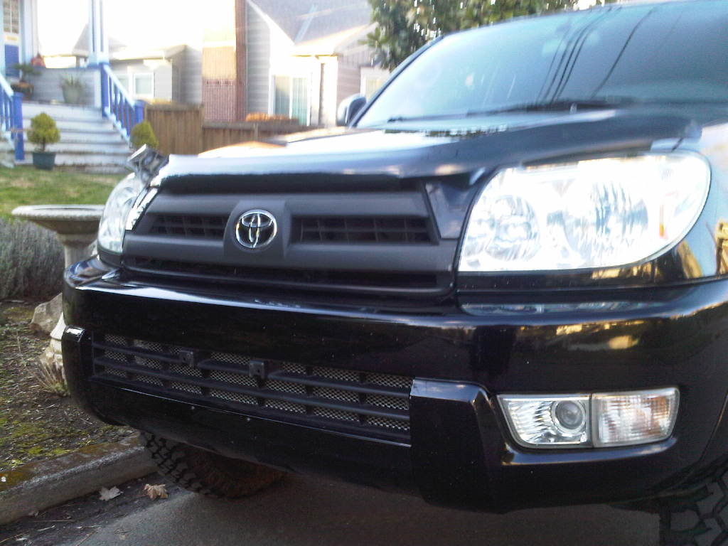

Quick Update

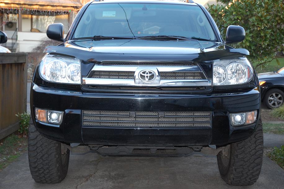

Painted my grill Black with the leftover plasti-dip, only put on 3 coats...
Quick Cell shots
Hey how many coats of plasti dip did you use on the wheels?
If I can remember right, I think I did 4 to 5.... And so far I'm really happy with it, and happy with it on the grill too. I have been through car washes, scoured the rims with a hard bristled brush, and power washed my rims as well. No signs of peeling or severe scratches. I'm thinking about doing another coat or two once spring hits. But so far its looking like I won't have to.
One of the best/cheapest DIY mods I have done so far.
***Edit*** The first coat I did was very light, you could still see plenty of silver from the rim underneath. And I made sure I waited about 45 minutes in between coats.
Your tires look great. How is the road noise?
Thanks, their not the quietest tires around. Anything under 40mph is good.. 40mph+ with spacers and your going to have to turn up the radio. Doesn't bother me though.
ok cool. You used the spray can kind right? Did you have to prep the wheels like sanding at all?
Yup the spray can, and all I did was wash and scrub the rims up so they were clean and dry. That's it

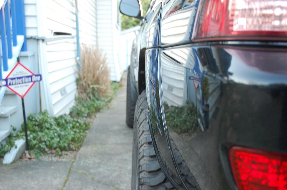

Spent the entire day yesterday installing my body lift...by myself haha.
Went fairly well except for a few things
-The bolts for the front body mounts in the engine compartment were a B$&!@ to install.
For both I had to beat the sh!t out of them with a mallet to get them in, in fact
the passenger side just wouldn't go in, so I had to reuse the stock bolt for now.
-Get a jack that lifts at least 21" high, Good thing I had 2 blocks laying around that were about 8" thick
-The steering spacer seems almost impossible to install, the space is so tight you can't
fit a socket in there. You HAVE to use a wrench
-And don't try to do it by yourself....
But here's a preview until I find my camera
Measurements from ground to bottom of wheel well:
Front 38"
Rear 39.5"
Oh and unexpectedly, now I'm rubbing worst than I ever have in the front...and it's on the bumper not the
fender liner. So looks like I will have to cut into my bumper, which I didn't want to have to do. Oh well
