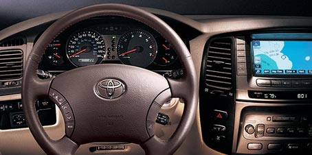

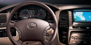

It seesm that in the Sienna, on the right part of the steering wheel there is a prewired switch for the microphone.
I took apart the cover on the right side of my wheel, but unfortunately, it's just a plastic blank...no wiring present on the 4Runner wheel for the microphone switch.
I noticed that if you go to partznet and look under a 2004 landcruiser steering wheel, you can buy the right steering wheel switch bank for $41. The LC has the same steering wheel and looking at toyota's website it's right switch bank has one active switch to control the voice command. Anyone tried this already? Also, is the Dark Gray color in the LC same as in our trucks and does the steering wheel button on it light up amber like ours?
the switch on partznet:
http://www.trademotion.com/partloca...=2004&graphicID=8415245&callout=7&catalogid=2
pic of LC steering wheel:
How would you think that would be wired back to the radio? Do you think there is a terminal in the 4Runner that the switch plugs into? (and then goes back to the NAV unit)? I'd doubt it.
I have tried it and it works properly, you have to use the button and a ribbon cable to tie into the existing audio controls. You don't have to wire anything to the deck. Works perfectly.
j0.
You buy the button and cable. the ribbon cable cross connects to the exisiting audio controls...
Voila you are done.... Simple.
j0.
Okay, is the ribbon cable that you're talking about Part #9 listed as switch cable on the previous poster's website for the switch? I think it costs about $25 from Lexus.
