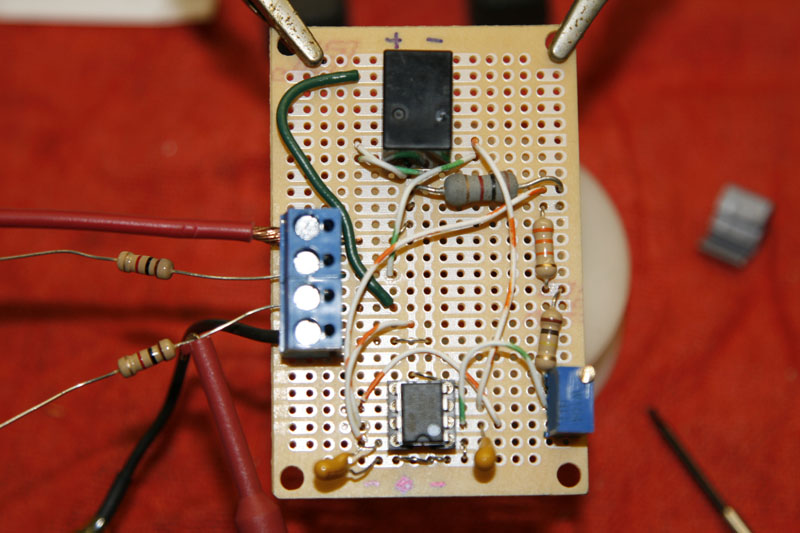

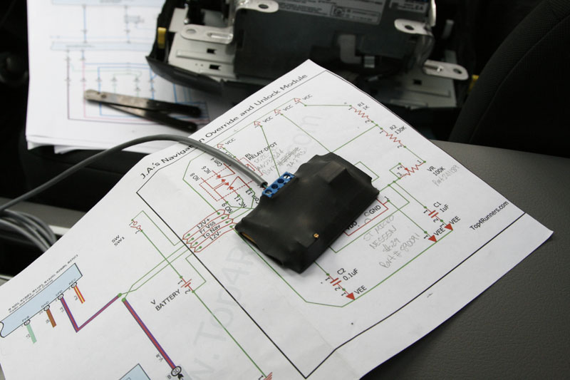

I just finished the NAV module as designed by JA. Thanks a ton JA!!!
The 2012 wiring is different than 2010 so I had to find the SPD input wire. I don't yet have the wiring diagram so I can't specify plug/wire #, but have identified it in the pict below. This is a must do mod as there are no longer any lockouts when driving. Total cost for parts is about $15 from Jameco.
Completed circuit
Ready for install
What is the black piece you used to cover the circuit?

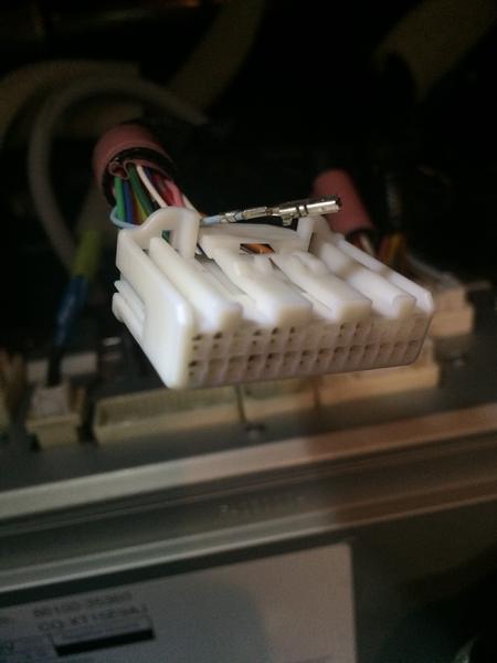

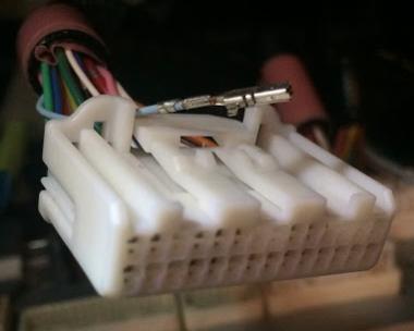

I am working on this mod now. I pulled the light blue wire out of the plastic connector and took it for a quick stroll around the neighborhood. The screen never greyed-out the options, but my map didn't update to show where I was.
I plan to add a switch to temporarily interrupt the signal when I need to, but I wanted to verify I'm on the right track.
This blue pin is on the bottom row, third one in as we are looking at the connector now.

After you pull the plastic connector out of the radio, there is a plastic "bar/flap" that needs to be raised. It's on the underside in this picture, so I can't circle it for you. I just wedged a small jewelry screw driver under it to pop it up.
Once the plastic "bar/flap" is up, using the same jewelry screw driver, or a safety pin for smaller pins, there is a plastic tab that has to be lifted for the pin to be removed.
Found this video: https://youtu.be/fg1xHMIDcy4?t=1m17s
I just confirmed the light blue wire in his photo also works in my 2017.
I've been wanting to do this on my 2017 TRD Pro. Not so I can use Toyota nav, because my phone's nav apps are far superior to the Toyota's nav (that's my $0.02)... but because features like ADDING A BLUETOOTH DEVICE are disabled while driving. Even if a passenger wants to, they can't. Dumb.
Thanks to [MENTION=79237]sigepbiker[/MENTION] I was able top confirm just now that the light blue wire in the bottom row, position 3 is in fact the correct one. I pulled it out (that YouTube video was helpful) and then I drove it around and all features in the head unit were accessible to me. So if you have a 2017, it's still the same wire, or at least it was for me with a nav unit.
