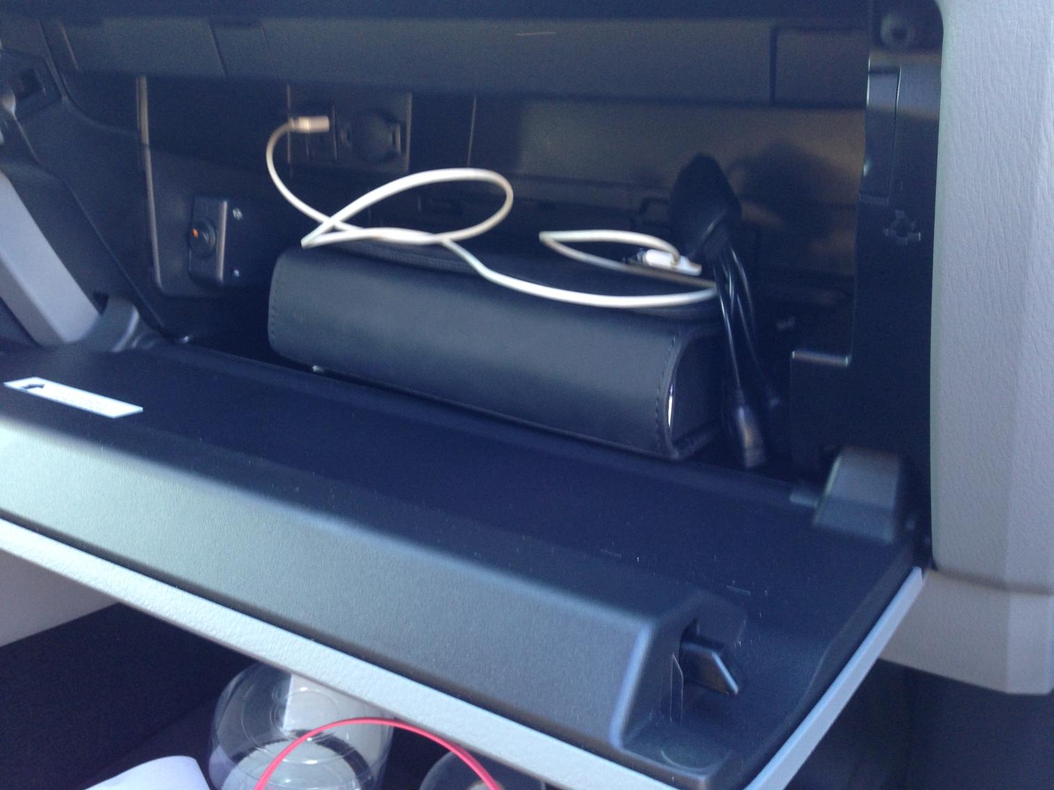

I ended up mounting the switch to the JA Box and attaching to that Trap Door inside Glove Box. It is reachable from Drivers Seat so I can turn on the box as needed. Got power from one of the "switched" circuits of the Painless Fuse Box and used a 3A (smallest I had) Fuse.

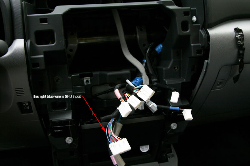

The 2012 wiring is different than 2010 so I had to find the SPD input wire. I don't yet have the wiring diagram so I can't specify plug/wire #, but have identified it in the pict below. This is a must do mod as there are no longer any lockouts when driving. Total cost for parts is about $15 from Jameco.

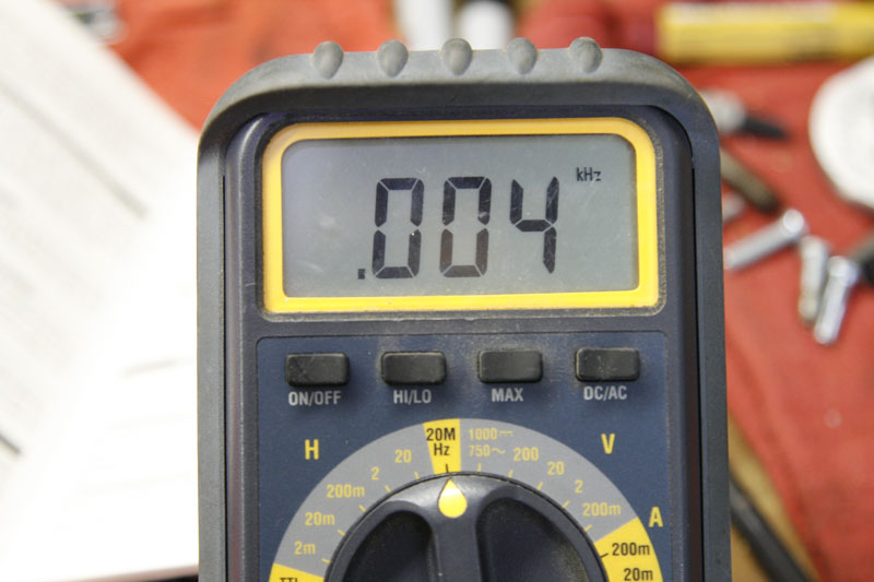

4Hz when powered

4Hz when powered

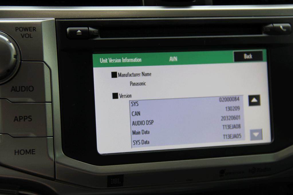

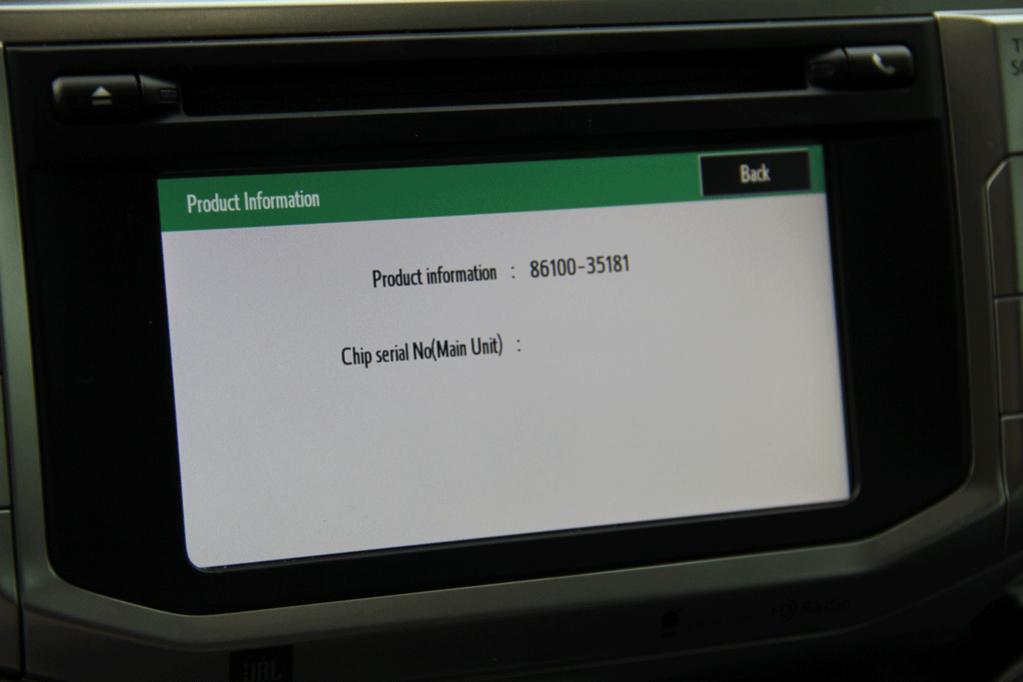

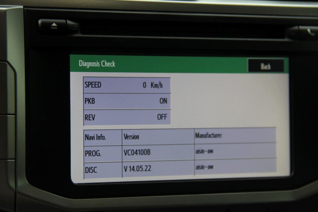

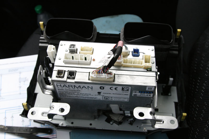

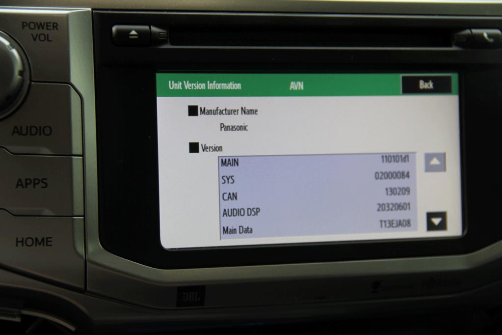

I wish I could tell you. I'll take pics of the labels and service menu and you can compare. I know it is not the Harman labeled unit in the 2012 Trail.
I would still go for it. It's just a question as to whether or not you need the 555.

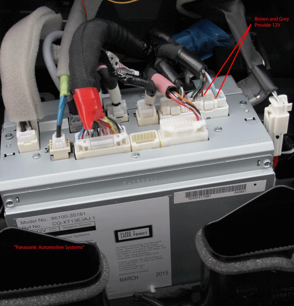

For the LED, you could pull power from the back of the unit. I will annotate one of the pics.
