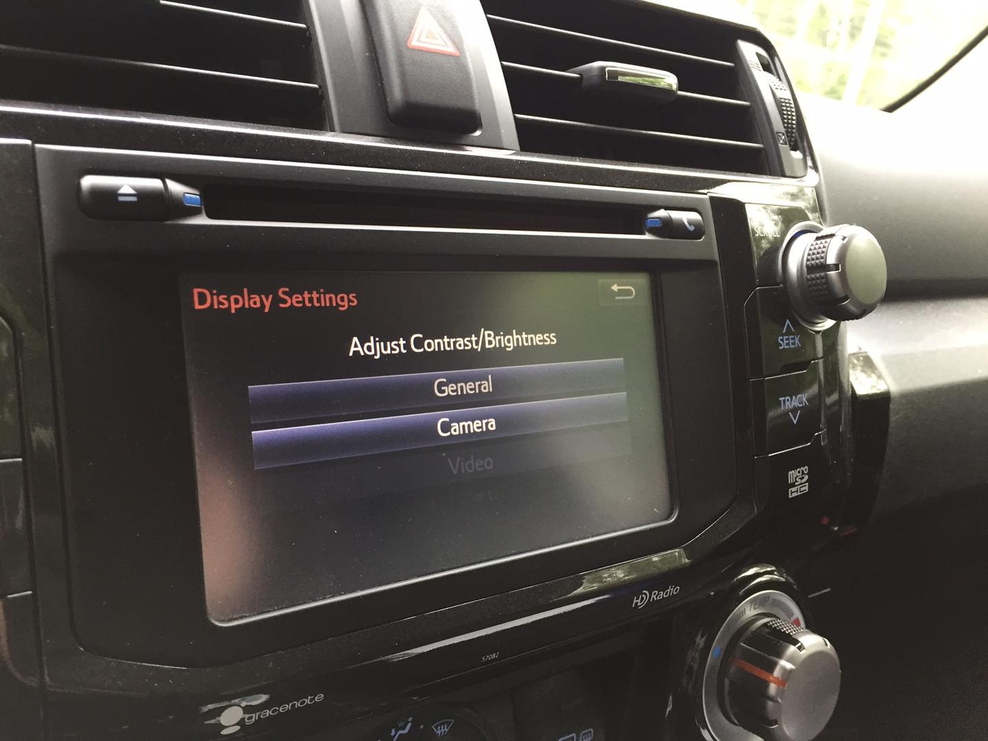

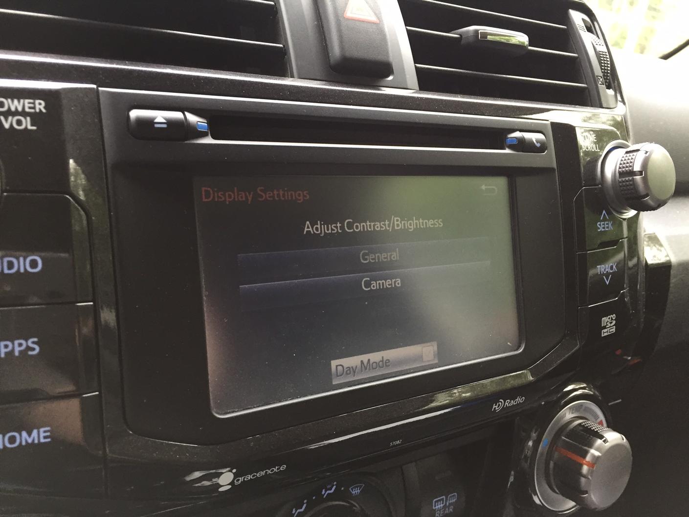

here's the scoop,
if you go to general > display, and the option to turn day mode is not present,
reduce your dimmer switch from the maximum setting and the option will appear on the screen.
then uncheck the day mode box, and it will work as everyone has described:
dimmer at maximum (click) - day mode; light background on navigation screen.
dimmer less than maximum; - night mode on GPS ; dark background on GPS screen.
here's the display screen with the dimmer at maximum, top photo,
the same screen with the dimmer reduced, bottom photo.
other items,
seatbelt doesn't matter
engine does not have to be on, acc is fine
there is no correlation between day/night mode and any ambient light sensor.
Nobody screwed anything up on your nav, it's just a hard setting to find.

I get it, I really do the problem is there is no "Day mode" box even with the dimmer less than maximum. I know everybody is banging their head against the wall thinking I have the dimmer switch maxed out but I PROMISE you, that's not the case.

Confirmed otw to work today, DAY MODE is not available as option unless headlights are on. No matter what the dimmer switch is set at. However, if selected setting will be saved as ON until disabled, which cannot be done with headlights off. So if it is on, unless you turn on the headlights, you can't turn it off.
