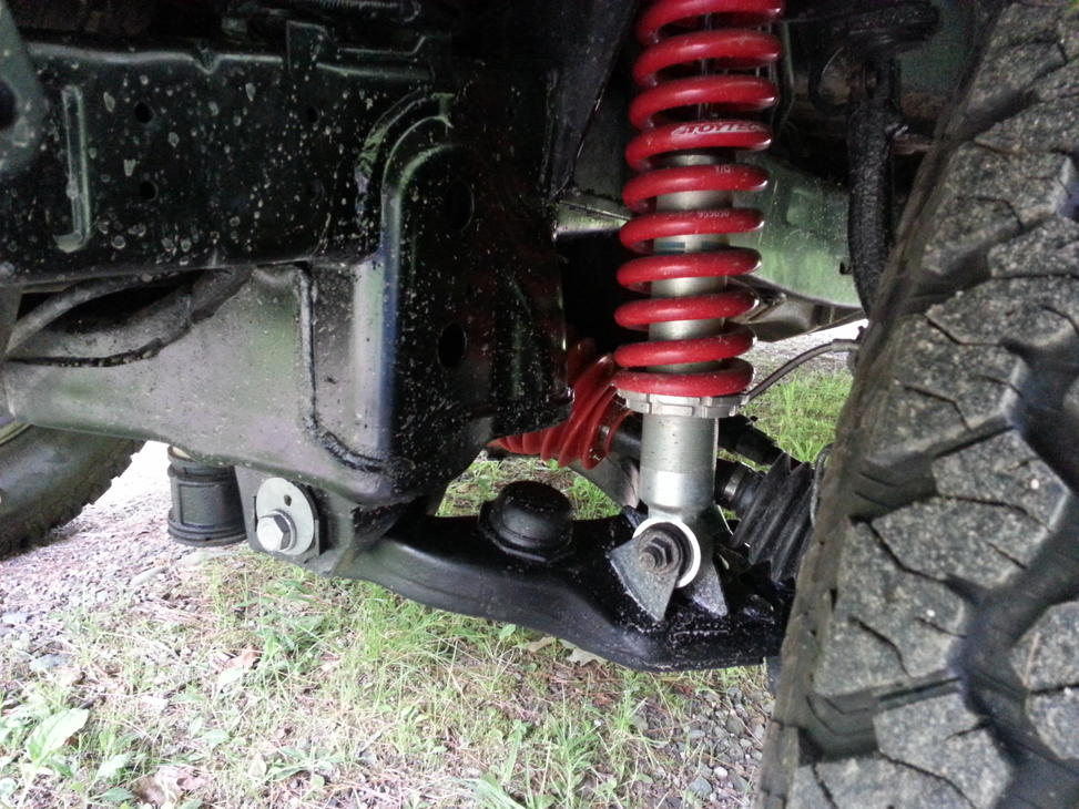

I am running the ultimate lift W/ 2" body 285/75/16's AT2 Grabbers and spidertrax in all 4 corners, no rear swaybar and love the ride and the handling, It is a bit softer than expected with the hardest option available but what a difference from factory worn out stuff, those guys and girls at Toytec put together a nice package. I never ran without spacers but no rubbing going on here.
