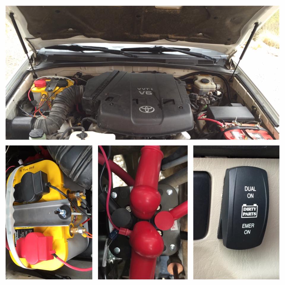

Dual Battery Install in 2004 4Runner
I installed the Dirty Parts FJ dual battery kit with the upgrade switch in my 2004 4Runner. I used a yellow top optima battery. In the 4 runner putting it in front of the passenger side fire wall I only needed to drill three holes using the air intake mount as the 4th as directed.

I have a V6 and I will be using an IBS system. I have an ARB twin compressor waiting to be installed also. My vision is to install the compressor and hopefully a 1gallon tank behind the intake next to the firewall and the second battery behind the headlight. I know it is possible on a 5th gen but am not sure on a 4th.
I have a group 34 x2 battery from batteries plus that I am installing in front of the air intake. I used the battery tray for a 5th gen from shrockworks and modified it to fit. I had to move the power steering resivor mount on it back but it should work. I'll take some pics when I'm done
Yes, I will post some pictures with that here in a little bit. All I had to do was drill three holes to get it to fit where the 5th gens already have studs in those places. It fits perfectly though. I also had to cut the wiring harness to extend it because the 5th gen extension that came with the kit has a different plug that the 4th.

I don't know if it was a coincidence or not but my alternator went out, but it gave me a reason to install a high output one. I basically learned as I went with this one. I would clean up my wiring, I will eventually install a converter in the back with some 120v connections and maybe a way to connect solar to the extra battery.
