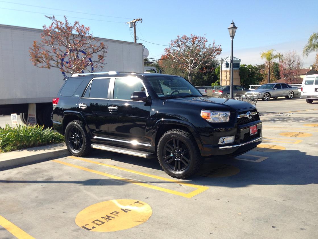

I know this is an old thread but since this is one I read before taking the plung I wanted to update this... I have a 2013 limited and they do fit. I had to remove the front mini mud flap and cut some of the inner fender becuase they rubbed in reverse at full lock.
Stock wheel - limited, no lift.
