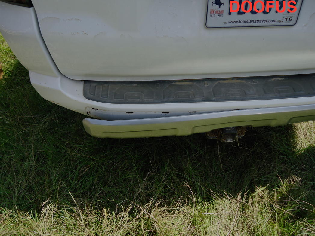

Your description of the front "bumper" is too confusing for me to weigh in on. I'm just not sure what you are describing. My front plate mount screwed into the gray plastic faux skid over the Trail front bumper. A picture would be helpful. But if it is like this rear piece that I peeled off mine a couple years ago you'll just be left with a line of slots for the clips if you just remove it. I ran mine without it until I got the CBI bumper this year.
