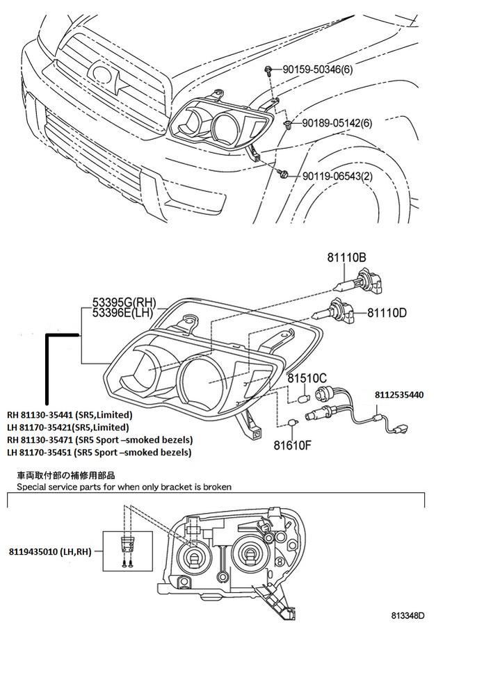

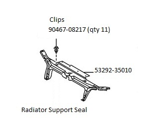

Take a look at the diagram. There are three bolts. One is covered by the radiator seal (just plastic dressing).

No need to remove the front bumper. You can have that headlight off in 10 minutes if you take a couple bolts out of the fender liner in the wheel well. You can actually see the bolt with a flashlight when you hold the fender liner back, and you should have enough room to get a socket wrench in there. The 4th bolt is a pain and will probably take a while if you've never done it before, but it can be done and removing the front bumper is a waste of time.
X2. I've taken my headlights off many times and NEVER took the bumper off. FYI: You don't have to reinstall that pesky bolt under the inner fender cover. I have retros and would have noticed the light moving on bumps.
