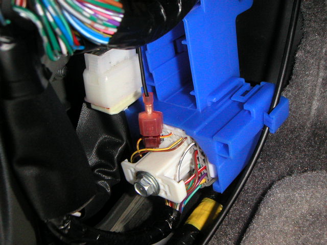

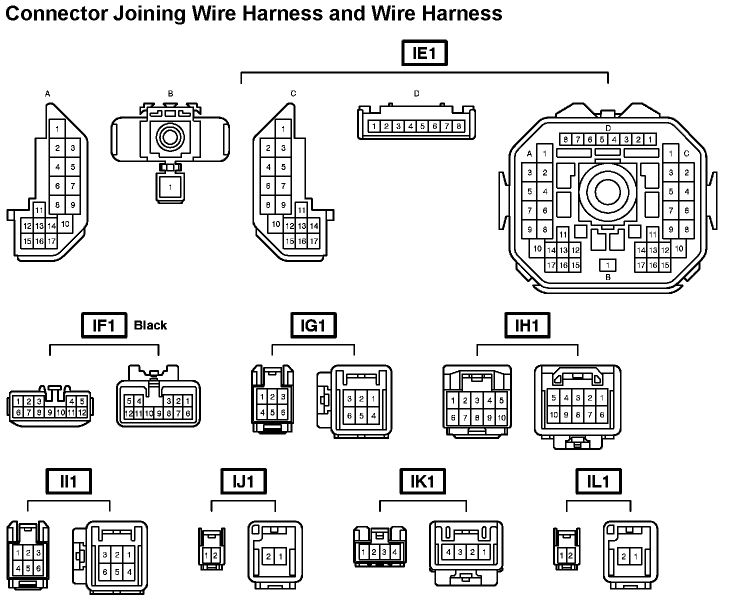

OK, that's the right connector in the picture above (IE1). A9 should be on the outermost column on the left side, at the bottom. Check it again, it should have power with the ignition circuit. As somebody else mentioned, A9 is the power wire for the rear 12V power outlet.
The Yellow/Red wire you've used is D5 and provides power to the LH tension reducer solenoid. Technically speaking, your way is closer to an OEM mirror install because they're both powered by the same 15A IG1 circuit instead of the 15A PWR Outlet circuit.
Am I going to run into problems with leaving the wiring as I did it using yellow/red wire? I'll have to search around for a wiring diagram. The rear accessory plug would probably be better since that's not something I'd ever really use.
I've only had the truck for a little over a week and haven't looked into repair books or anything yet to give some reference.
Well I can't guarantee anything but based on my reading of the manuals, the way you have it is fine -- maybe better in the sense that your way you are using the same circuit as a factory installed mirror.

Bless you! The photos are great and should allow me to complete this mod without any further confusion or difficulties. Thanks. BTW does the auto-dimming feature as well as the digital compass work 100% correctly as per the specs? Just curious.
Rando:
You must admit that this is surely one of those instances where a picture is worth a thousand words! :D
So am I correct in assuming that I may tap into either the A9 or the D5 wire as the end result will be exactly the same?

Wanted to add to this thread since i just finished installing my gentex mirror and the brown/red wire is there in position A9. Problem is you cannot see A9. looking straight on the connector it is lower left corner. I pulled back some of the electrical tape to make it easier to find and tap. Attached is a close-up of the connector Diagram so you can see where it is.
