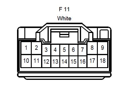

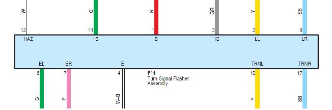

Good luck finding an after-market HD flasher. While it is located near the fuse panel, it's a complete module (ECU) that has an 18 pin connector with 11 wires running in and out.
