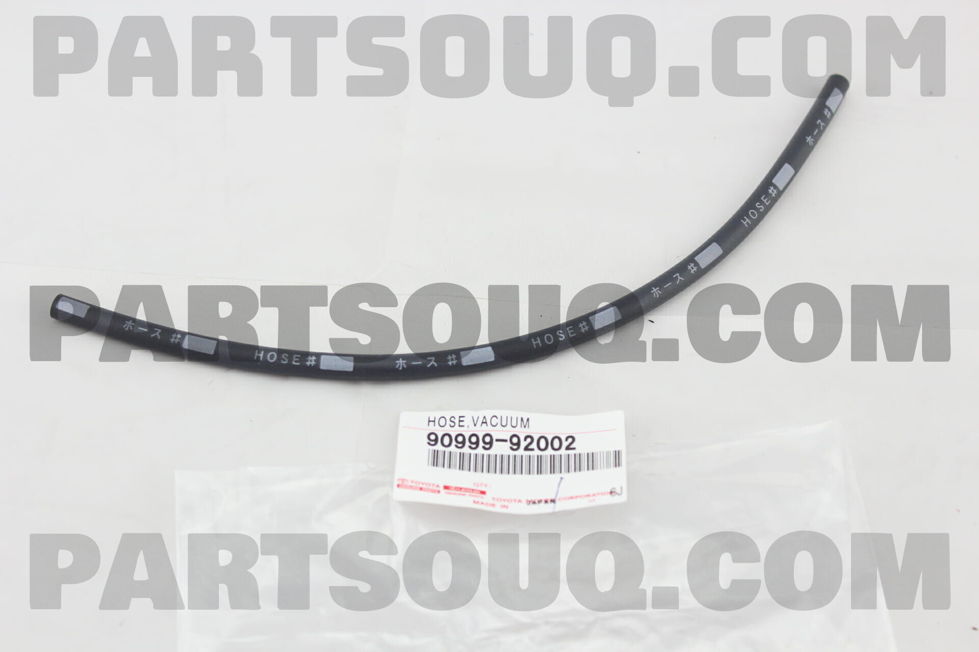

Aren't you in luck... this hose has no name. It's a length of hose of no name or sizing. This is from the Toyota parts database for part # 90999-92002:
You literally have to make the hose yourself, LOL @ Toyota
I can't imagine what prices Toyota is charging for vacuum hose though. Probably like 5 dollars a foot.
That's for the small vacuum hose behind the one he is interested in. I posted the actual part number for the molded hose in the other thread he started...
Quoted here:
The general term would be a crankcase vent hose. It carries fresh air in/out of the engine. That hose can carry oil vapors, but it should generally be a small amount.
The official Toyota name is: HOSE, VENTILATION, NO.2, PN: 12262-62050
