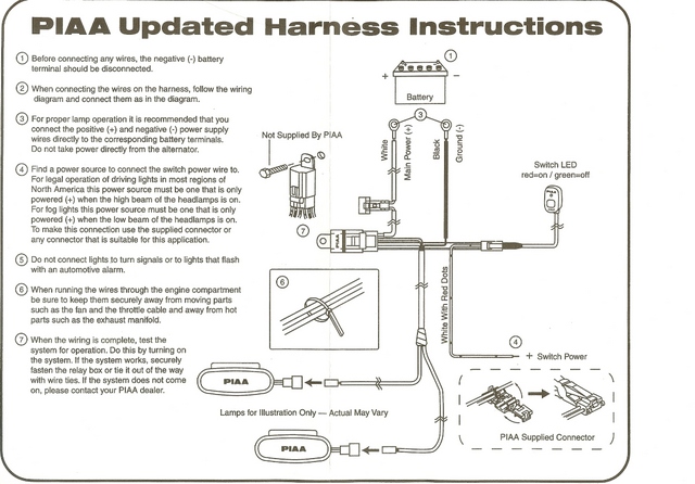

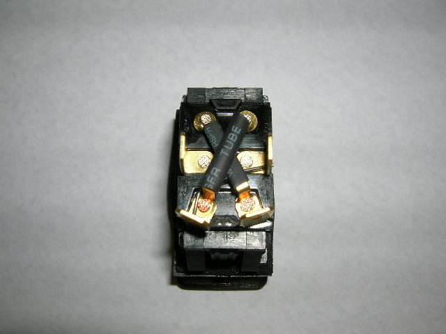

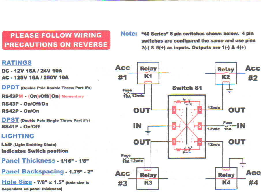

I recently purchased a rocker switch for my Piaa 520 driving lights. I was using the Piaa switch that came with the lights. The switch I purchased has 4 pins. I attached pictures of the switch, wiring diagram, and Piaa wiring diagram. How would I go about wiring this? Thanks
