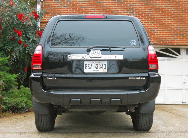

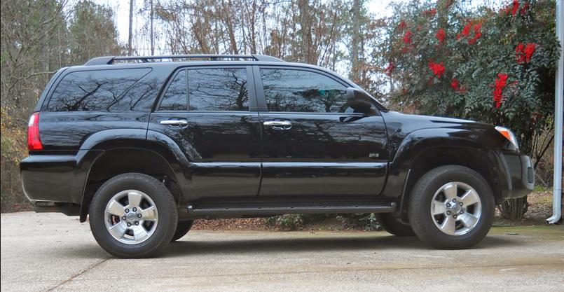

Bilstein 0.85" Setting with FJ Coils Front & Rear-
Bilstein 2.5" Setting with OEM 4Runner Coils & Sway Away 1.5" Lift Rear Coils

From your pictures, it doesn't seem to have a large difference between the 2nd and 4th notch. Must be because you removed the FJ Coils.
That's because with 2nd notch I was using FJ Coils springs which provide an extra inch or so of lift. The 4th setting with 4runner coils is slightly higher than 2nd notch & FJ coils but it is noticeable from the pictures. 4th notch with FJ front coils would've probably been level with the more lifted rear.
