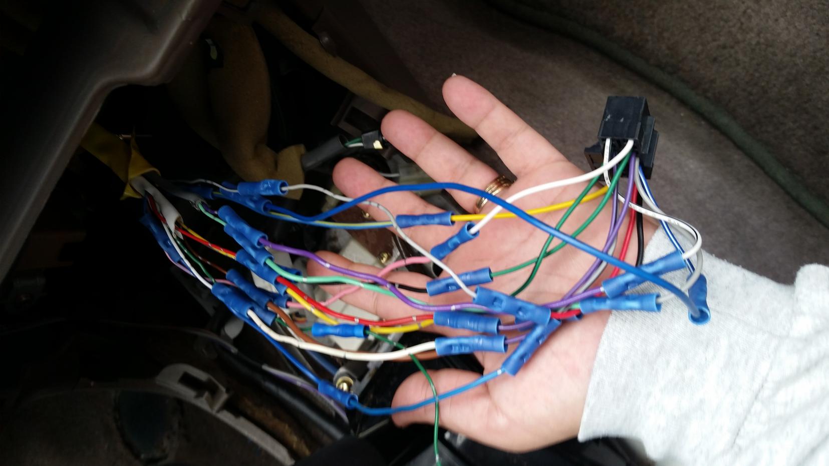

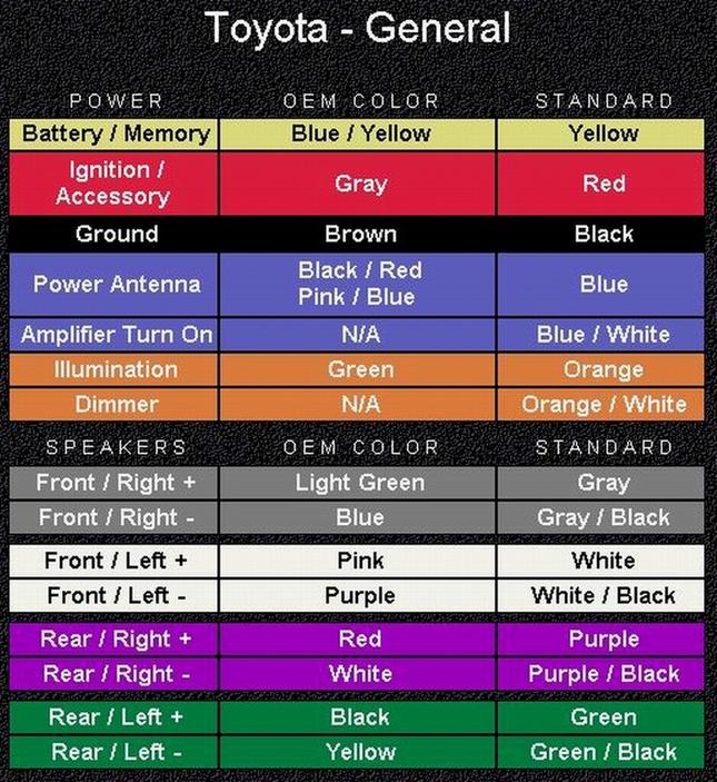

i have hooked up the wires i think properly but no sound comes out. also there is an extra green wire. attached are two photos. one is my wiring and the other is the wiring diagram that i used to wire. i don't know what i am doing wrong. please someone help me. i have a 1998 4runner limited 2wd

Go get the proper Toyota wiring harness. It's only $5.99 on eBay so maybe $10 at Walmart or Best Buy. Oh wait, now you also need the vehicle side of the harness. Ground both vehicle and stereo ground wires to bare metal on the vehicle. Try to do your repairs and improvements in a workman like manner or you will booger your resale value.

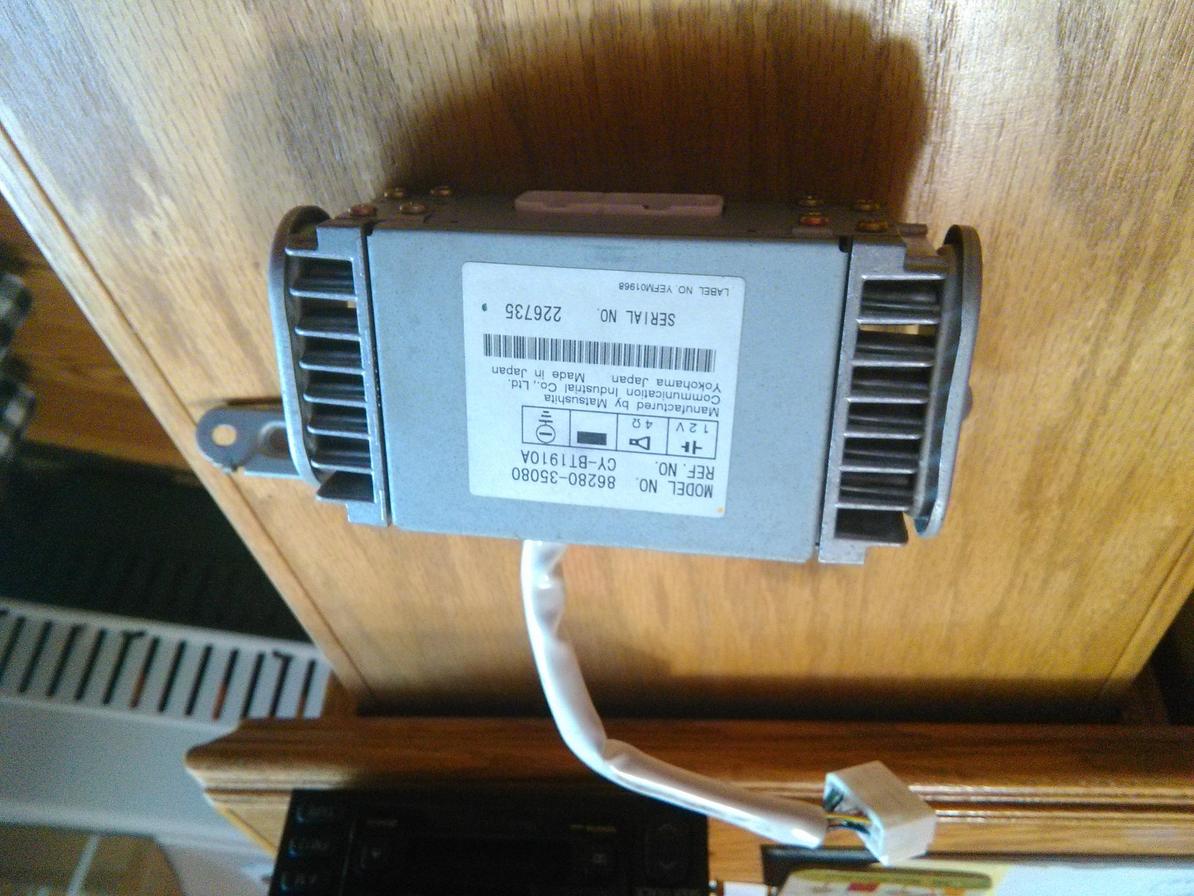

Has the factory amp been removed? It sorta sounds like your wiring to the amp, not around it. you should be wiring to the harness this plugs into. Bypass this amp all together. Sorry for the upside down photo

I don't trust butt connectors. It's very possible those unreliable connections may be part of the problem.

Not sure what plug you're using, but I bought the one that is listed for our 4Runners and had no issue. The colors matched up and then I just connected purple to purple, red to red, etc. It looks like some of your colors don't match.

Did you wire the stereo harness directly to the 4runner wires? It doesn't look like you used an adapter. As stated above I would get a Toyota stereo adapter and wire that to the wire set that came with your stereo from Walfart. After that its pretty much plug and play.
Also that wiring looks in rough shape I would get that cleaned up and SOLDER your wires and heat shrink each one. If you bought from CLUTCHfield it would have a wiring diagram that you cross reference with the one from the radio.

I had to do quite a bit of soldering on the Sony HU harness in mine, as well as the aftermarket alarm I put in. :flamethrwoer2: Some of the wires were a ***** to get to, but I agree with AZBub, those little splicers you have there may not be the best solution, and definitely not as permanent or as good a connection as soldering the new harness in.
Obviously, the wiring is wrong. I don't know where that little chart you got came from but something is not right.
