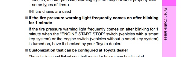

Does the light blink for about 1 minute and stay on, or just blinks for however long and then turns off?
I think if the pressure is okay in all four wheels and it blinks for 1 minute and stays on, it means there might be something wrong and you need to take it into the dealer for them to look at...

When swapping over the tpms did you happen to reset the system? If not I would highly suggest getting that done, MOST tire shops should have the TPMS reset scan tool (it also tests to make sure the sensor is sending a good signal).
If the light flashes that is an indicator that there is an issue with the TPMS system. If you get the TPMS reset/checked that should reveal a potential problem.

Flashing on the TPMS indicates system trouble. There are some circumstances that can interfere with the sensors communicating with the system (in the owners manual). Having the light go back off and stay off means whatever it was is resolved. I wouldn't worry about it unless it happens again. If you want to be certain the TPMS is working properly, drop the pressure on a tire to about 25 psi to trigger the light then re-inflate to turn it off. If its working I wouldn't worry about it anymore.
