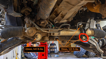

I replaced mine with Energy Suspension bushings today and while I was torquing my bolts, the lower bolt which goes to the bracket gave out a significant *pop* and the bolt kept spinning after that - it was tight enough so I just left it. Is this a common problem for rustbelt trucks?

* Not my picture but the bolt reference is there*
That would be the captured nut breaking free of it's welds. As long as it's tight you are good for now, but if you want to fix it you'll have to cut open the bottom piece below where the captured nut is to replace the nut and/or weld in a new nut.
