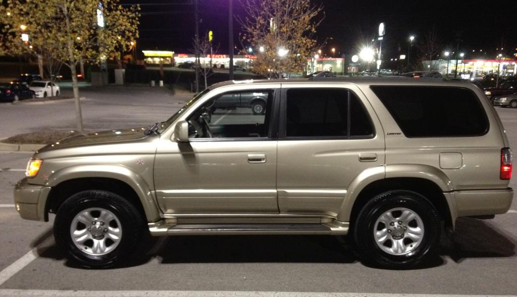

I've had my '01 limited for about 2 years, it has 199k miles. I put a new drive shaft in it last year and that's about it. Oil change, tires, and batteries are the only things that have been changed in its lifetime (I also added a MetallicA sticker on the back window). I know it's time for something to go out and would like to be proactive. I need it to last for another 100k.
If I have $1000 what should I get done? timing belt? water pump? both? Any other advice from the experts would be appreciated. Thanks.

The vehicle itself looks to be in amazing shape, but 199k miles means that it's been on the road a lot. Examine every part of the suspension components to look for wear. Bushings, ball joints, tie rods, etc etc.

Finally, ditch those wheels! I know they are factory Toyota but that style looks terrible IMO. You can probably find a great set of 5-star's on CL for $250. You can leave them factory or paint them. Either way ditch the set you have now as soon as possible.
You have a very*** clean looking 4Runner (I can only see one side) for that many miles. It looks like it was taken care of well.

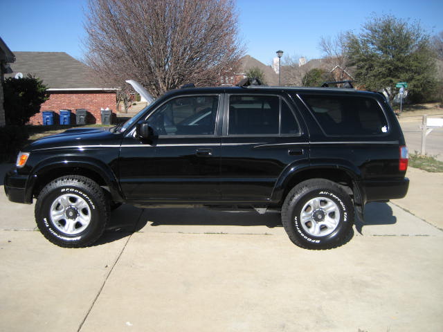

And BTW those wheels look fine but it does help to wrap real tires around them.

That said, very clean truck. Looks great for 99K let alone 199K.
