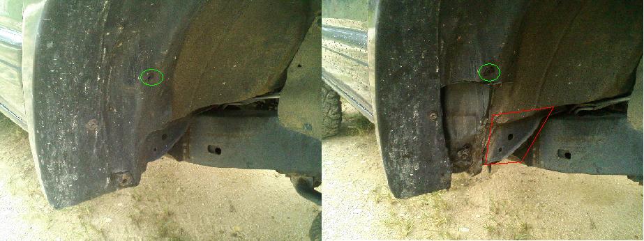

Wanted to update
I cut a little more than was needed but I wanted to make sure I got it the first time. I trimmed the plastic back to where the plastic plug/clip (circled in green) is so I wouldn't have any excess flapping around or get'n caught up on the tire. I took the 10mm headed bolt out where it attached my fender flare to the wheel well and cut some of the excess fender flare out too. The only thing I wish I would have done was hammered that metal back I have enclosed in the red box in my pic...just a little but I have no scrubbing lock to lock even with suspension slightly compressed.

Just an FYI, the air intake tube runs through the pass. side fender and picks up air right above the hole you cut in your plastic liner. I got a lot of tire dust going straight into my air tube and into the air box (where the filter is). I closed that tube off and drilled a 4.5" hole in front of the airbox (deckplate mod w/o the deckplate) and my air filter stays a little cleaner because of it.
Good to know. Hadn't planned on doing the deckplate mod til later but looks like it may be sooner. Thanks for that heads up!
