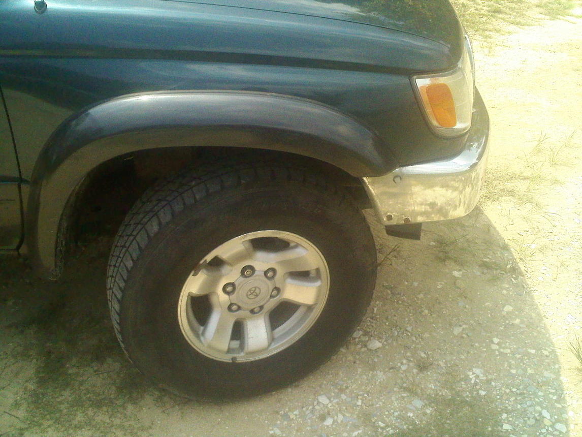

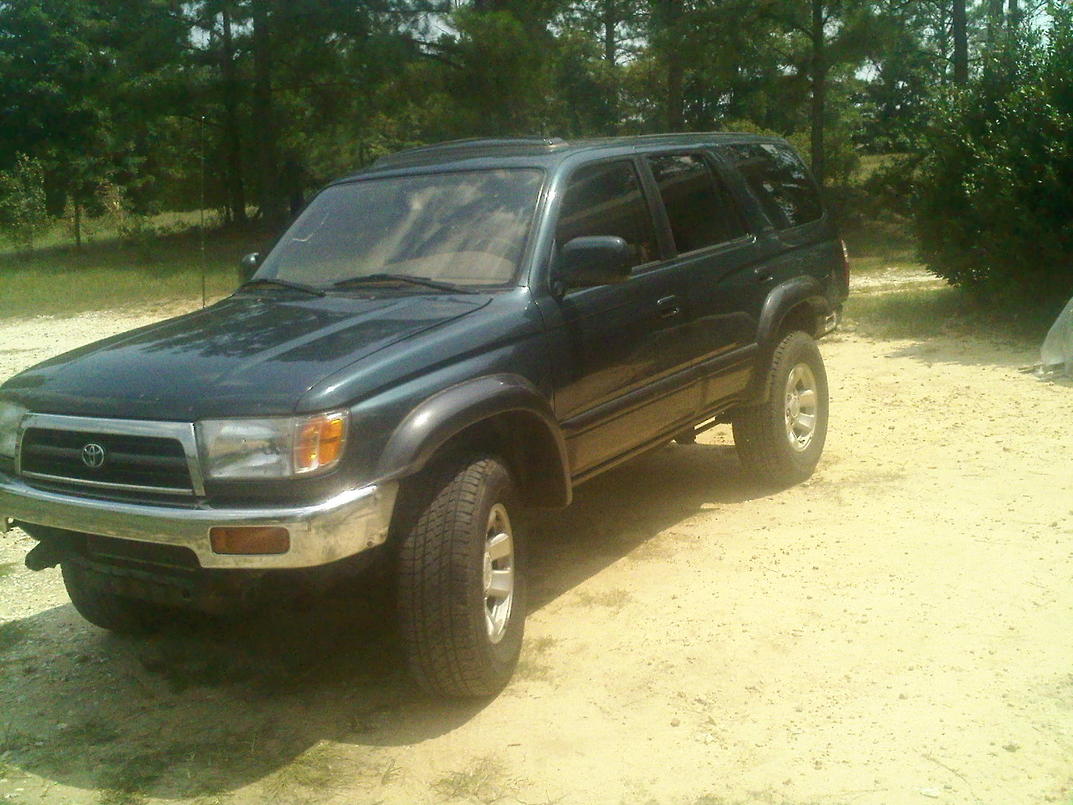

This is how I sit right now.
I took off the plastic trim on the front bumper with the fender flare on that section and the running boards. I've got some 1/4" wheel spacers that I'm gona use to aid in my 285 installation.
I've looked all in my wheel well but can't see anthing that looks like it will hit now. Anybody think of something I'm over looking?

I don't wanna be a drag here but have you ever replaced your stock coils? If not they are probably sagging which isn't going to help anything. Secondly, in order to run a 285 you need to be running at least 2" of lift if you just want to run them on road. I've never tried to run 285's at stock height but don't you think if it could be done w/o substantial cutting people would be doing it already? I would say hold off on selling your tires till your lifted...but if you can get it done, my hats off to you!
Yeah, I no doubt should have some sag since I seriously doubt the PO replaced any of that. I've only had the truck for a week now. I'm just hoping to make it a few days with 285s and just going back and forth to work. My lift is on its way and it will be installed next week.
There is a link somewhere that you can run 35's at stock height but you have to do some trimming, grinding, bending, beating, cutting, etc...Granted that I don't want to do all that but the beating with a BFH and grinding a little off here and there isn't a problem for me to fit 285s. I just need to know where as I can't see any real obstacles at the moment besides what I've already taken off.
x2... If you can make 285s fit I think you'd be the first. Therefore, like Mauzer said, I'd wait to sell the 265 tires.

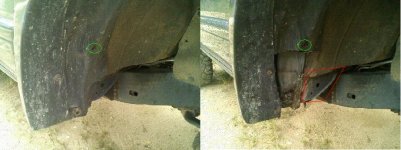

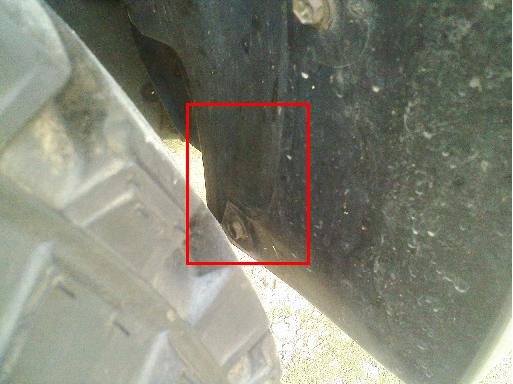

Heres some pics
I only rub slightly for ON ROAD turning which will be quickly remedied with my BFH later on today, easy peasey. Here's the pics and where it rubs. No wheel spacers of any type needed even at fool drop as tested on the lift.

That is the only place I rub also. Glad it is working out for you. That is the piece of inner fender lining on mine that got pulled out and torn into a flap. Was making a sound like a playing card clothes pinned to frame of bicycle into the spokes of tire to make that motor sound..lol Just trim the fender lining along the seem and then pound down the pinch weld right below it and you will be fine.
I may need an alignment....seems that I can make left turns easier than right, as I get less rub turning left. All in all I could drive around like this without beating that weld in but I'm gona go ahead and do it anyway.
