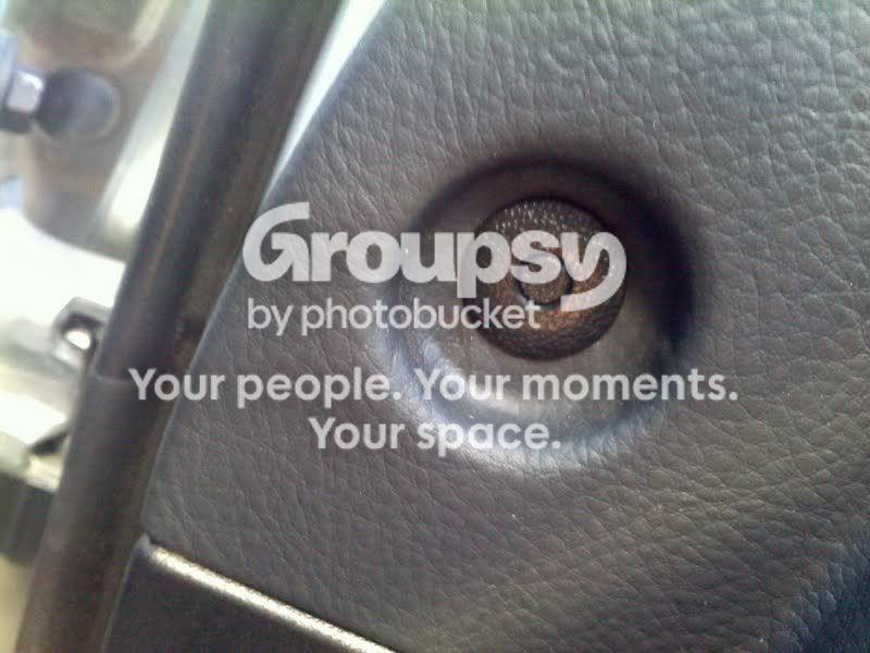

first, remove this piece. its real easy. held on by one clip in the middle.
i find it easiest to remove it where my screw driver is placed. behind it
will reveal the bolt to the mirror.
1111111.jpg~original

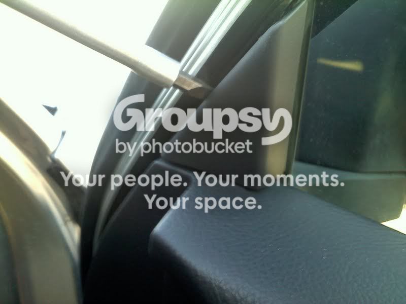

and right under that piece is this one,
push the inside in with your screw driver, then slide your flat head (or fingernail) under the outside of it and pull out.
222222222.jpg~original
