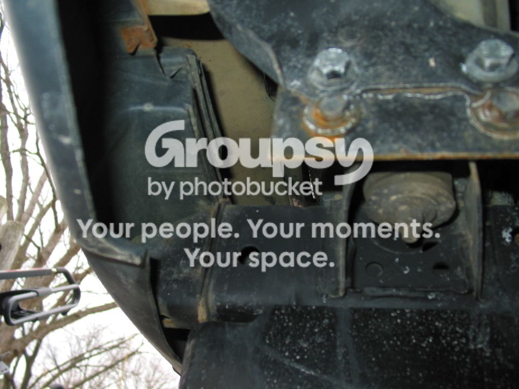

Pic of bumper mount on the 96, ignoring bumper lift bracket and hitch under frame:
Bolts with 2 bolts on either side to bracket around body mount. That's it.

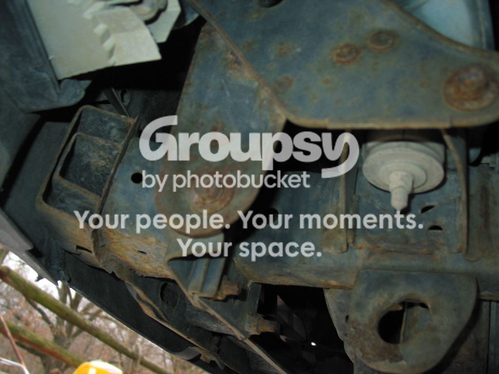

Pic of bumper on 99, stock:
I've never taken this one off but can see a bolt on the bracket around the body mount, a bolt on what looks to be an extension from the other 2 bolts in the elongated frame cap, which the 96 doesn't have.

The two bolts at the frame cap appear to support the crumple zone the 96 doesn't have. The other two bolts attach the actual bumper to the truck. It almost looks like the earlier bracket could be used with the newer bumper if you minus the plastic fatlip cover up top and the crumple stuff. That's something I'm not curious enough to find out for you, the ground's wet and it's really cold outside too! Find someone's fatlip close to you and check it out for yourself if you're determined to try it because even just shipping would be an expensive fail. Some measuring is in order. Maybe someone's done a fatlip to thin bumper here and will chime in?
