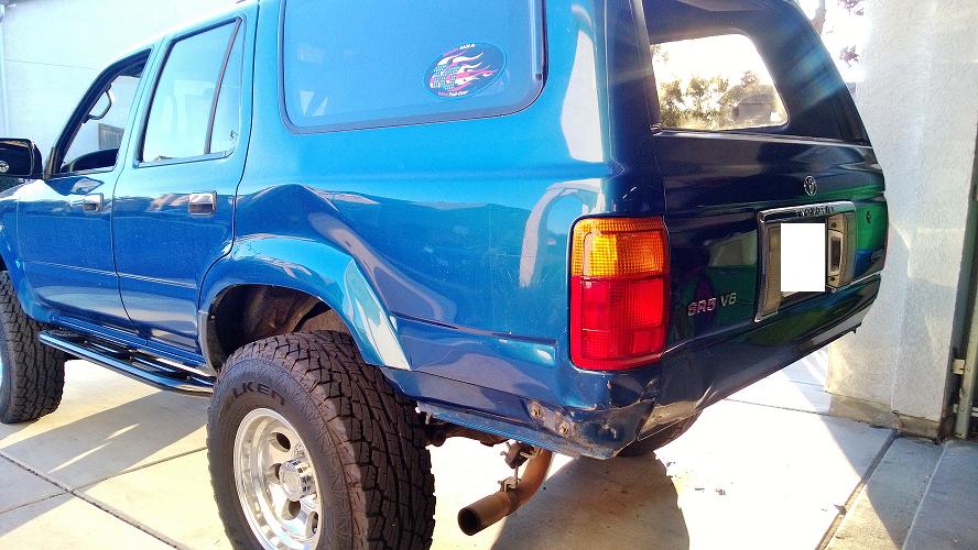

I need to change my exhaust tip..it needs to dump out the side also. With my rear window down on the freeway I get exhaust in the truck. Gonna have my guy modify it when he puts the lift on. Just waiting for the Skyjackers from 4WheelParts..I got everything else already.
I need some D-rings also..completes the look.

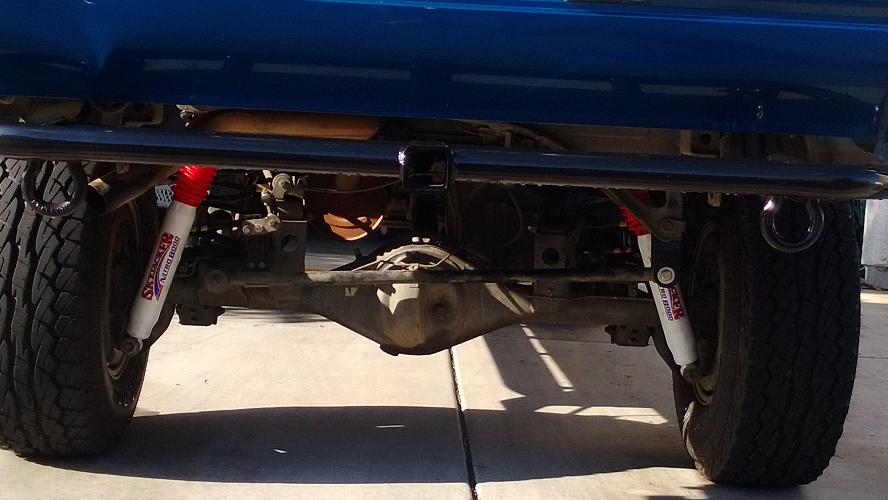

Lift is done1
Got it all done Friday.
Total cost was about $350 for parts, $200 for install.
Front:
1.5" BJ spacers in front
diff drop
sway bar extenders
Skyjackers Nitros
Rear:
7.5 wrap LC coils
4Crawler LPSV bracket
4Cralwer Panhard Rod Drop Bracket
Skyjacker Nitros

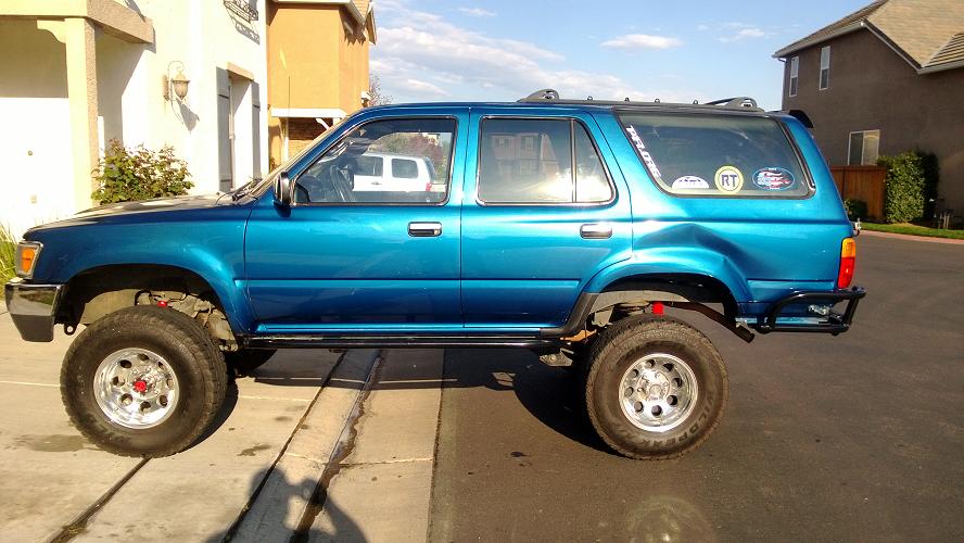

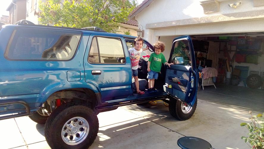

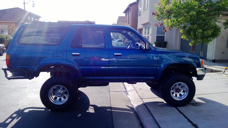

So after it was all on and got the alignment she is feeling good. Think I needed about 3" of lift, ride is a little stiffer but I don't mind at all. I think it all came out pretty good.
First pic is before the lift...a little reference.

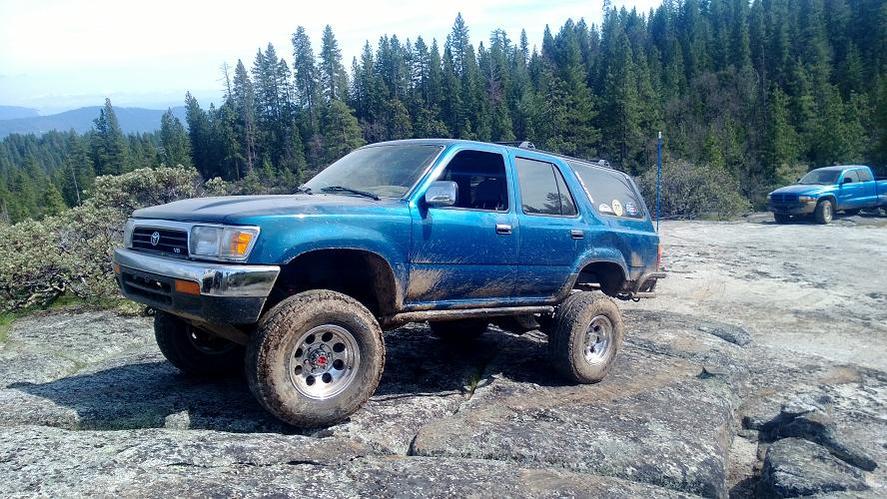

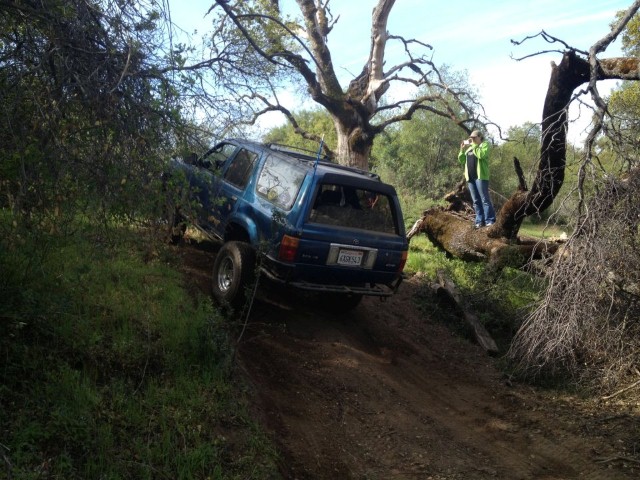

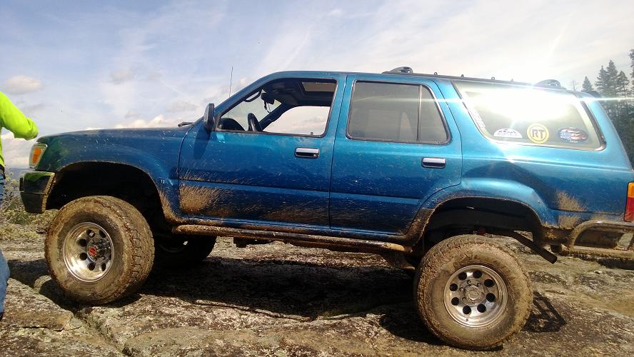

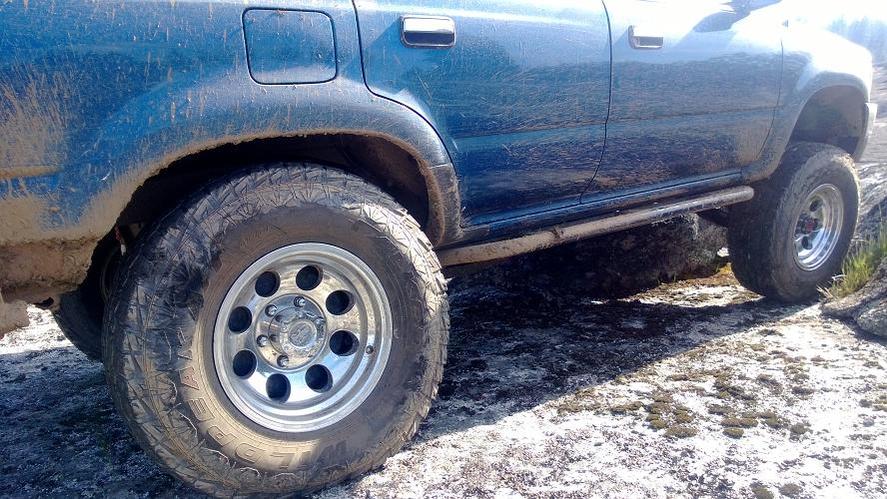

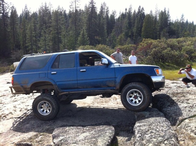

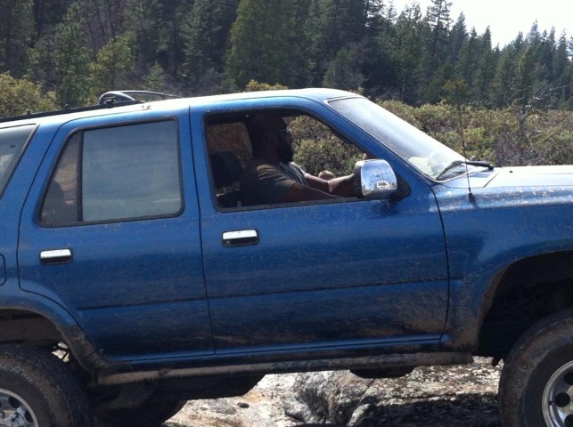

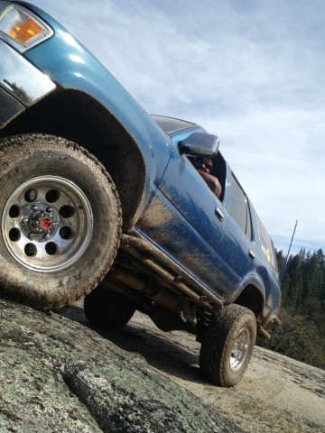

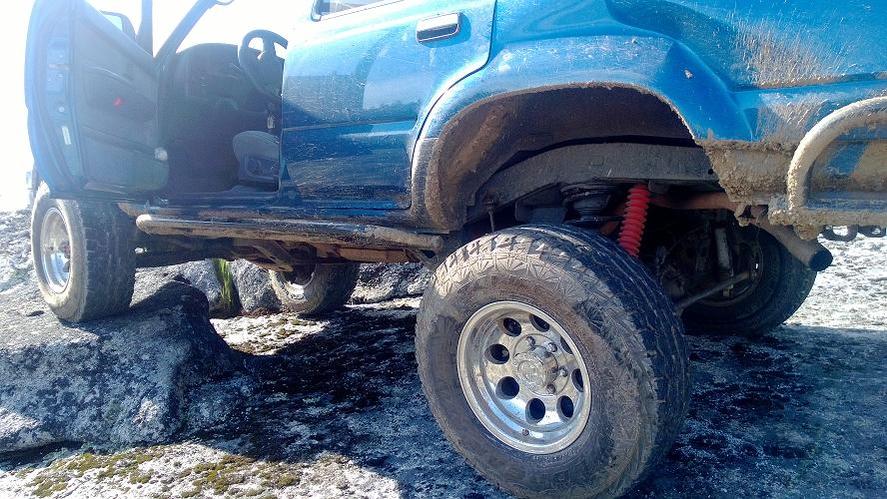

4/13/13 Blue Canyon area run
Well I was suppose to have pics up last weekend but we had to cancel that run...this weekend we went to Blue Canyon but all the trails were down for repairs. Ended up doing some trail running, motor cross style, then finally found a moutain top to play one.

Looks good! Makes me want to go wheeling. I need to install my new CVs first though. :bash:
It was fun.
I didnt get much articulation play in, and I didn't really get the tires stuffed like I wanted, but all in all was a fun day. I kept up with everyone else so that is what I wanted.
