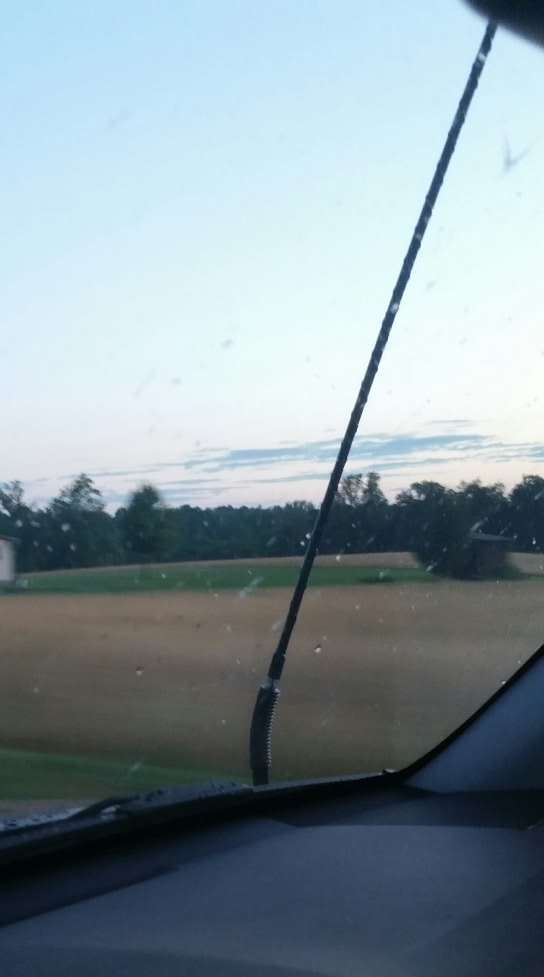

I kept the NestorEdition black spring even though they recommend a stronger one for longer antennas. The 'fly gives less wind resistance so I took a chance. The pic shows 50 mph and thatvs about all I see up to 80 mph. Behind a large truck with eindy conditions made the antenna go wild but otherwise it just lays back nice and smooth.

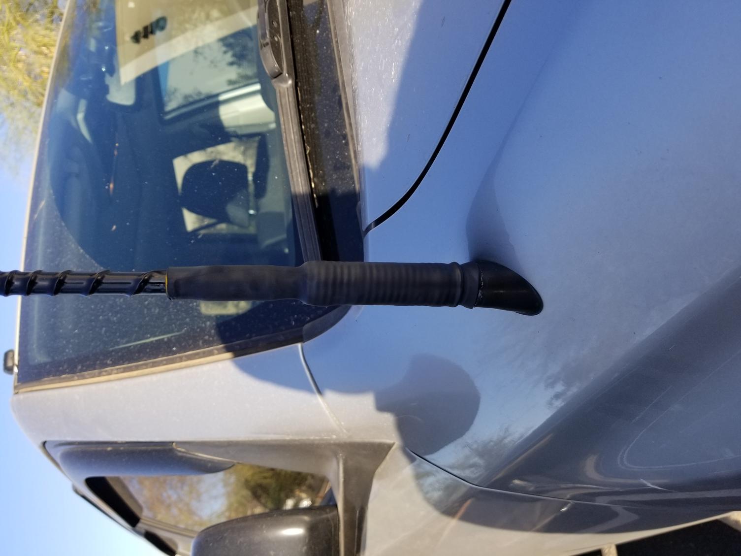

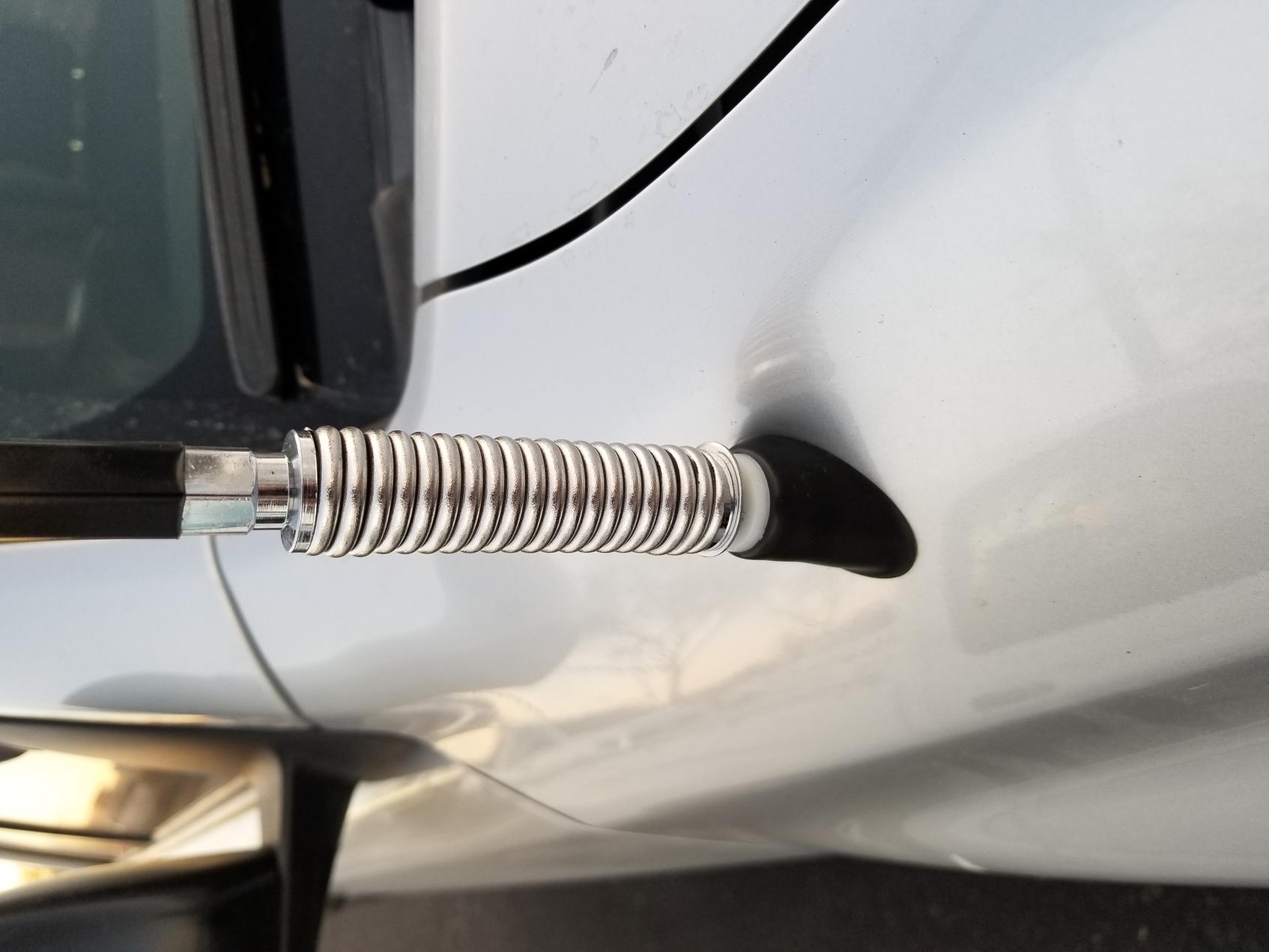

Some pics of my version*

It looks like some heat wrap and some kind of spring. Can you give more details on the adapter?
