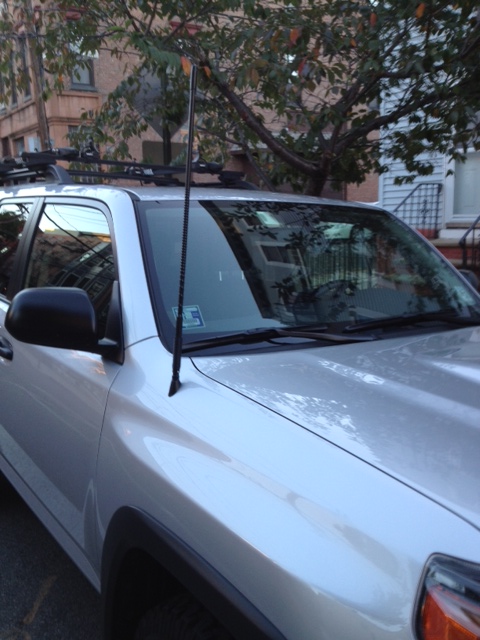

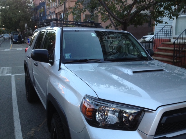

Got the idea for the antenna here: http://www.toyota-4runner.org/5th-gen-t4rs/58587-ideas-shorter-antenna-17.html#post1026069
I contacted NestahEdition mid-week and had the antenna in my hands by Monday. Super-easy transaction. Loving the blacked-out look. Thanks Nestah!
Aside from looking burly as f*** this setup gets INCREDIBLE AM/FM reception compared to the stock antenna. I haven't gotten around to doing the WX 75 and splitter install, but will update this thread when I do. I spend a lot of time on the road chatting on my CB during my weekend NJ-->VT-->NJ commute all winter, so hopefully I can provide some solid performance info for you guys.

Definitely keeping an eye on this! I would love to have a CB without it looking like I have a CB.
I see its mounted on a spring. Does it wobble around a lot? Is it distracting? I'm not that familiar with CB antennas, don't know how stiff they are.

Kraeken - it catches wind at higher speeds and bends but the spring is pretty stiff so there isn't much back-and-forth wobble. It's about as distracting as the stock antenna -- so not much at all really.
