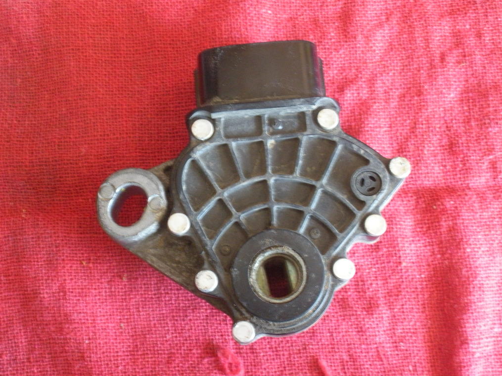

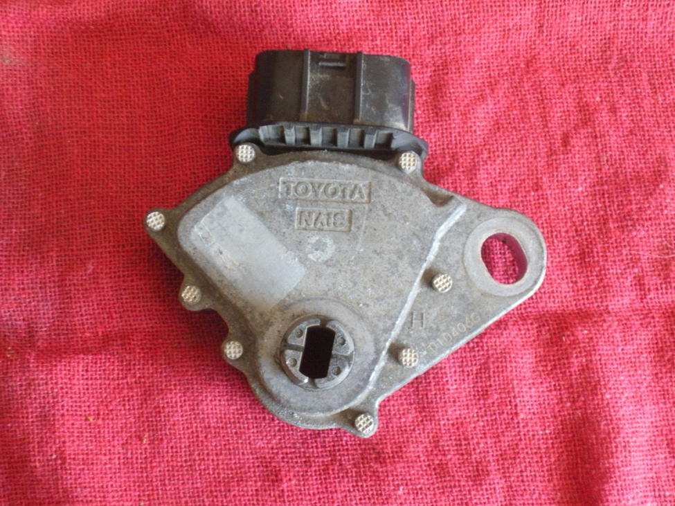

Here's the neutral safety switch from the '01 t4r...instead of screws, it has "pop-rivets" (?)
Every neutral switch that has failed for me on other vehicles would cause a no start. Thats the point of the sensor. If it fails your car would think you could be in gear so it wont fire up for safety. Hope it fixes it for yea.
I haven't had any "no start" issues YET, but the "P" light is always on regardless of what gear I am in, and the VSC off and TRAC off lights come on almost as soon as I move it.
DTC code reads "37" which according to the FSM has to do with the PNP switch. Replaced the PNP switch, and no change. Only thing left to replace is the skid control ECM.
