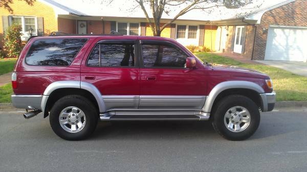

Bought a 96 limited 4wd today, 195k miles, $3000. Ever since I sold my 97 sr5 4 years ago I've been wanting another one. Wish I still had my original but this'll do. :) It's all stock now but once I get new tires out of the way ill move on to some mods. (Removed that ricer exhaust tip)

Anyone know how I could remove those window visors without damaging the rubber it's attached to? They are after market attached with some kind of heavy duty double sided tape.

Try some fishing line or dental floss and pull and saw up and down thru the tape. You will probably need to get some 3m adhesive remover to get the rest of the tape left over from the rubber.
Nice find! I've seen so many people on here, say they need to sell... do so... and then regret it!
Glad you got another! Keep this one man! :)
Get a heat gun and try to heat up the adhesive backing so pull off better, then used adhesive remover to get the residue off
Nice find man! I was gonna sell mine recently and quickly realized it would be a mistake. These are just awesome vehicles.
