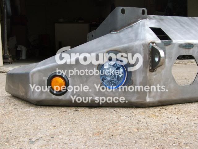

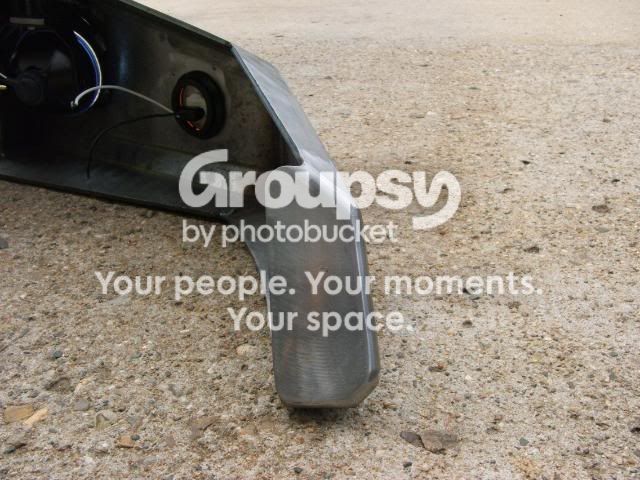

I am guessing you are refering to the 4Runner in the picture? If so that is my 4Runner. The bumper fits just fine! The bumper can be adjusted a bit when installed due to the size of the holes on the mounting plate.
i might be ordering one, just to base my own headlight hoops off, its just what I need for my build. and for decent price too :banana: $$
More pictures were added to 4xinnovations website. I have more pictures as well. My bumper is setup with some halogen cyber white fog lights.

i want to see a different turn signal light that doesn't look like it's off a 70's dodge and some sort for cover/lens for the led fog's, the square block looks ugly, the bumper is sick as all get out, it's just the aesthetics that are a bit lacking imo and really that's only due to the lights used in the photo's above, the user who used his own lights looks much better, but he's still stuck with that ugly bulbous, oversized grommet looks like an after though turn signal...i know it's not and lke i said this is one of my fav bumpers so far and considering who it's coming from i'd definitely send people your way over shrockworks just due to lead times alone , to me lead time and customer service are pretty closely tied if not one and the same all together.

You may be able to opt out of the turn signal lights. You will have to ask Adam at 4xinnovations. I do know the square LED lights are an option and I chose to go a more inexpensive route with the fog lights I chose.

One thing I'm noticing about this bumper is that it seems to be designed specifically for the 3rd Gens with the "Fat Lip" bumper. The 99-02's. The earlier bumpers/frames do not have the 3 mounting bolts at the front of the frame rail, so if installed on a 96-98 model, the only mounting points would be the two bolts on either side of the frame rails where the stock bumper attaches. The 3 bolts up front, along with the visible plate w/the 3 bolts, would go un-used.
It seems to me like that would result in a bumper that would be only marginally stronger/more impact resistant than the stock bumper.

Center cut outs are for accessing your winch, not for lights. The "interior" holes on the wings are for lights. Is that what your looking for pics of?

That's kind of what I was getting at earlier when I was asking about bolt locations without realizing the frames were different on 99-02's. From the pic supplied it looked like holes needed to be drilled.
I would rather use the sturdier bolts on the underside of the frame that hold the tow hook in place.

Interesting. I figured they were more light holes. That's kind of an odd design with the cutouts being completely open then... It's be nice to put something in there or to have some caps for it or something. hmmm....
