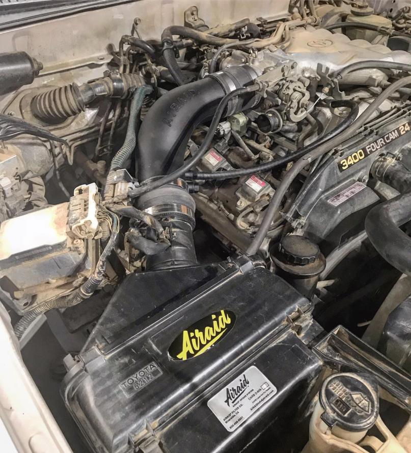

I run the Airaid intake tube with the stock air box and a Street Max muffler (sounds similar to a Magnaflow to me). I considered the deck plate mod but I drive constantly in dusty conditions so I didn't think I would drive with it open enough to warrant the effort. I'm happy with the set up, especially having reduced the clutter. Cleaner look than the funky baffle box.

Got mine installed and love the open space. I have a supercharger so I didnt have to deal with the two hose inlets closest to the MAF. Did you have to drill those out? Mine are plugged and cant understand why they wouldn't just come drilled with plugs installed.
