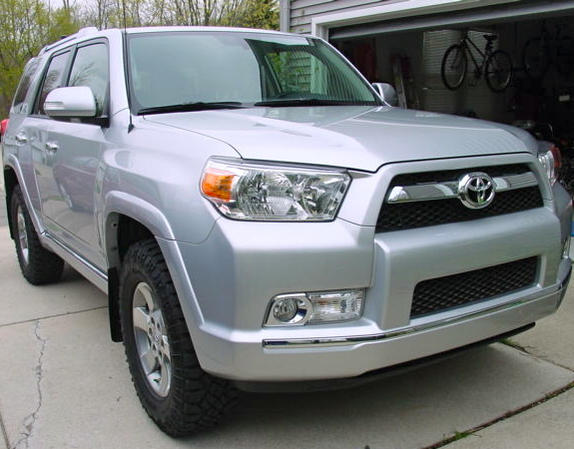

Hey there,
I decided to go with a roof rack earlier this summer and decided on Baja Rack primarily because I did not want to drill holes in my roof or attach an aftermarket rack to my factory rails.
Recently, I noticed rust showing up around some of the welds. I assume that the zinc primer and/or powder coat did not thoroughly cover these areas. I don't want to send it back because of the hassle it involves. I know that if I leave things the way they are it will only get worse. By the way, I live in Michigan and we use salt on our roads during the winter months. Any painters out there that may have some advice? I was thinking of trying to match the color using touch up paint. What should I do first to prep the surface?
