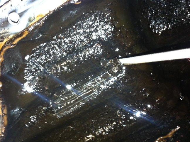

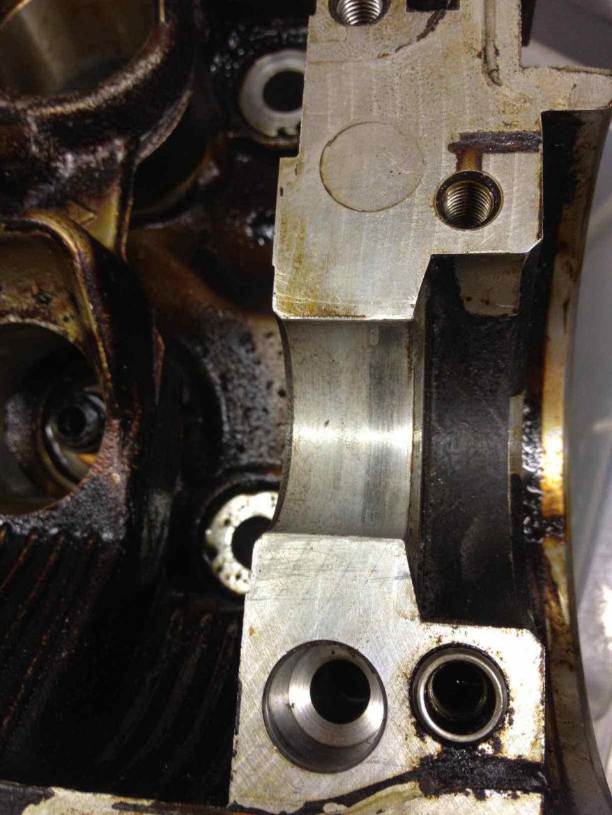

Look for Sludge
I bought my SR5 knowing it had an oiling problem. First owner leased it for 89,000 and never changed oil. Dealer sold it without changing the timing belt . The second owners changed the oil regularly until 154,000 then sold it when the oil light began flickering. Drop the lower pan and look for sludge. If it has it don't even think about keeping the engine. The front cam bearing oil passages are small and they will clog. No amount of cleaning will clear it out. If it's ok, just change the head.
First picture is the pan, the second is the cam bearing.

Thx for the pics! My mechanic has been into the heads a couple of times now and always comments on how clean everything looks in there. I suppose I could ask him to check the oil pan as well, but with regular oil changes every 5-6K miles with Mobil 1 since it was purchased new, I don't expect him to find much sludge, but I could be wrong.
Just an FYI, I'm sure your mechanic will know this or he will figure it out, but there are 2 oil pans on the V8, the main big oil pan and a very small oil pan on the big oil pan, the small oil pan is the one Duffdog is referring too and it's very easy to remove and put back on, so an easy job for your mechanic to do for a look see, the main oil pan is not so easy to remove without a lot of work.
