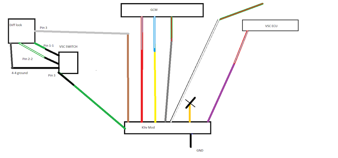

Kliv mod installed. Works exactly as promised. Thanks Kliv, for the fast shipping and great support. Now, to try and trick the computer into VSC TRAC off without instigating a code, the gears are turning. 07 and previous only allow a code to enable VSC TRAC off, so I'm not sure that this will be possible, but I'm gonna try.
Also, I created a very simple schematic to help with the install. Installed on an 07 SR5 V6 so your VSC wire may be a different color. Sorry, some of the terminology is in honda terms, as I was a master tech for honda, but ill post it anyways.
GCM = Gauge control module aka instrument cluster

Kind of. Unplugging the connector you mentioned switches off all the systems including A-Trac which might be useful. It also does not allow you to switch everything back without ignition off (as far as I remember).

19(c). For 2007 models (refer picture bellow):
Connect Violet wire from the device with Red/Blue wire from 22 pin of
marked connector.
I haven't physically located this ecu in my vehicle yet but looking at the wiring harness for this mod, it doesn't appear to be able to reach my glove box.
I wanted to make sure before I start this project that I don't need to run another length of wire to get the reach I need. Or are you guys taping into that harness somewhere closer than at the plug of the ecu?
Sorry if it seems like a silly question, I just haven't seen anyone mention this as an issue so I may be overthinking this a bit.
Yes, you will need additional wire to reach ECU. You wouldn't need it if you had older model with ECU under steering wheel.
