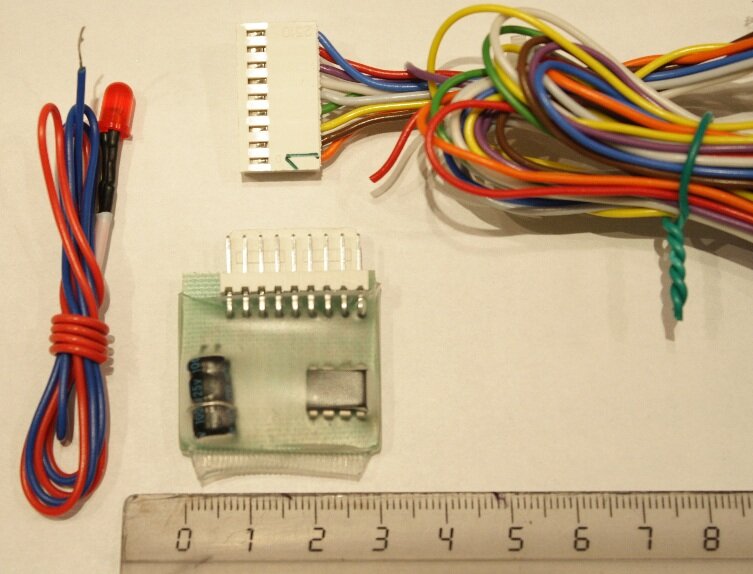

I am glad to announce that we improved the mod!
Here how it looks now:
What's new?
- It is smaller! 30mmx30mm.
- It is factory made now what allowed us to use other components and get 4 times bigger margin of the load. No great need but still sweet.
- Pluggable connector with wires.
- Quality increased from 200% to 300% :D
- No changes in algorithms.
We installed one of new items locally. Works great. Will send one item to CO today. Hope to get feedbacks.

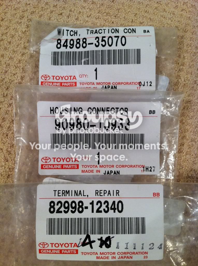

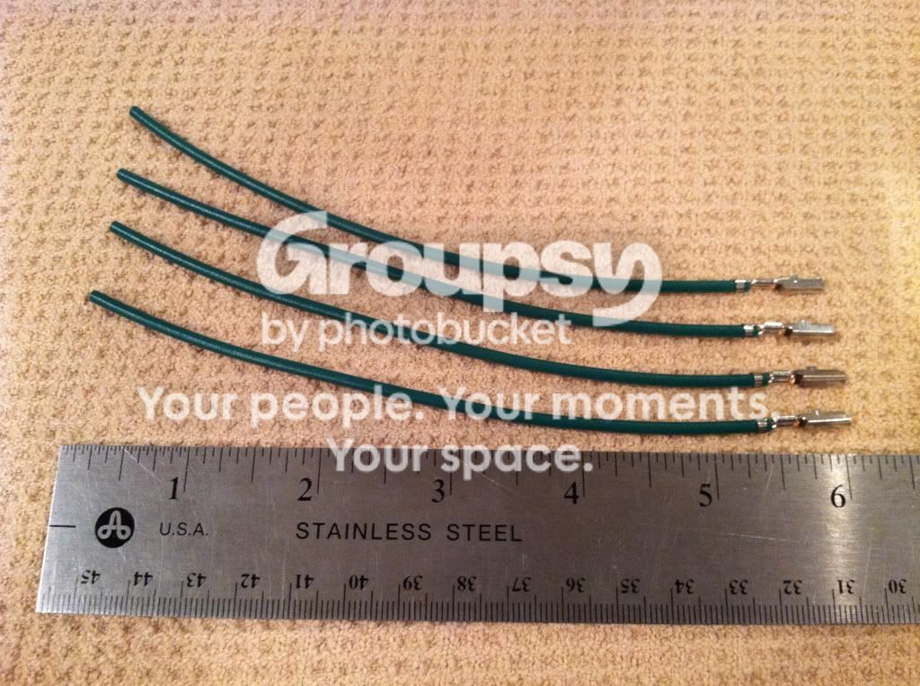

I finally have all of the parts that I wanted for the switch installation... hope to get to it this weekend. I had the switch and connector, but it took me a while to find the right wire terminals that fit in the connector housing. Toyota calls them a "terminal repair" kit. You can also buy the switch harness, but that was even more expensive than these little wires. $6.00 each for the wires ($24.00 total) versus $32 for the harness. It's worth it to me to have this connection perfect. The wires are very nice, for what it's worth. Here's a picture with all of the part numbers in case anyone else is looking.
86157ff9.jpg~original
24$ for 4 little connector terminals :jaw drop:
I will never believe you have no analogues in local electronic stores.
It's not just the connectors... there's 6" of really nice wire factory crimped to each connector! ;-)

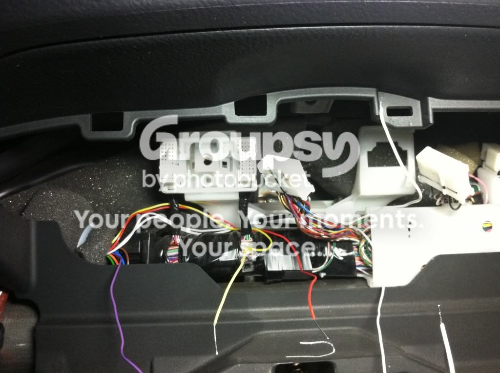

How are you guys stripping sections of these tiny wires to splice into them? Just working carefully at them with a razor blade?
I was thinking about cutting the wires, stripping the ends (have to find a small wire stripper), twisting all three ends together, and soldering, but I don't know this stuff.
Having the right tools makes all the difference on a job like this. I pretty much have the whole thing planned out (routing of wires, locations of connections, and where the device will be secured), but want to make sure that I can create quality connections.

To summarize, for the installation you will require:
1. The Unit
2. Momentary button (84988-35070 if you like FJ button)
3. Connector for the button (90980-10933 for FJ) and 4 terminals that type: Home » Shop » Connectors / Harnesses » Sumitomo » Injector Connector Terminal (22 - 16 gauge) [heat resistant copper alloy]
You may use 4 repair kits found by Doozi (28998-12340).
